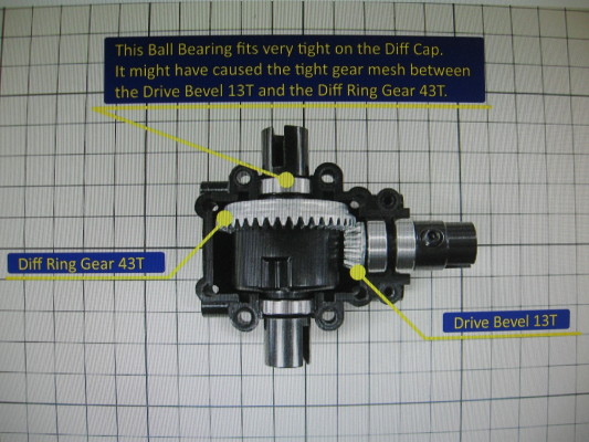

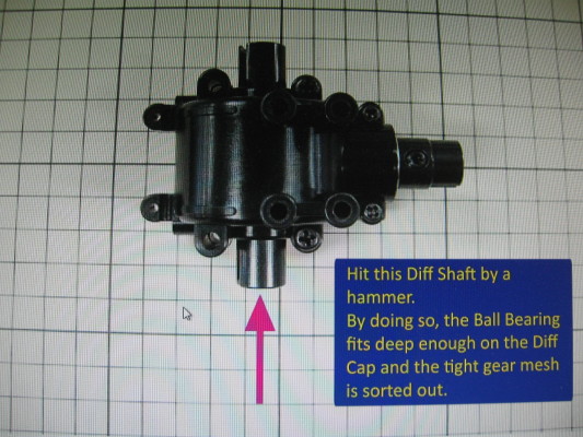

#3 Posted : 14 May 2014 14:41:53
It could be that the Ball Bearing, which is installed on the Diff Ring Gear end, is very tight compared to the other end.
There is a possibility that it has causes a tight gear mesh, as it causes the Diff Unit to sit closer to the Drive Bevel 13T and reduces a necessary play (gap) between the Drive Bevel.
As shown in the photos below, by hitting the Diff Shaft from the other end by a hammer or similar (using a wooden block or similar as protection), the Ball Bearing should fit deep enough on the Diff Cap. And it should give the necessary play between the gears. When the gear mesh is too tight after the assembly, hit the Drive Shaft and see if the problem is solved.
If when rotating the Drive Bevel 13T, you may feel there is a high (tight) spot per rotation. As long as it rotates without much stress, it doesn't cause any problem running the model. Once the model is run, the rotation will become smooth.

Hi,
I followed the instructions and now have 2 smooth running drive trains. Thanks to all involved for this easy if apparently brutal solution.
Russell2.

Just wanted to confirm that I had the same problem, but after several rounds of dismantling and carefully putting it back together I still wasn't able to make it running smoothly. Neither the hammer trick has worked. I had to contact customer service and they were very helpful and sent me pack 02 again - big thanks to DeAgostini for that. Indeed, my second attempt was much more successful, and although at first I was afraid I'm making some kind of systematic error - the rotation has been lumpy again - after one very light hit with a hammer it now works perfectly. Now waiting for the pack 03.

I tried the hammer trick with no success. Dismantled the case to look at the gears. It sticks at one single tooth of the bevel gear. i don't see anything wrong with that particular tooth but I tried to smooth it a little with a file. Still not any better. Guess I will just run it and hope it smooths out with use.
