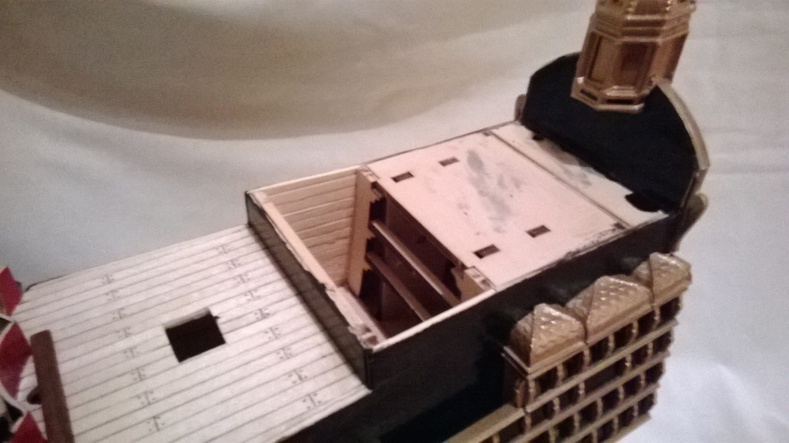

I hope the attached helps. I've just laid the deck and bulwark in place. You can see that both are a bit short.

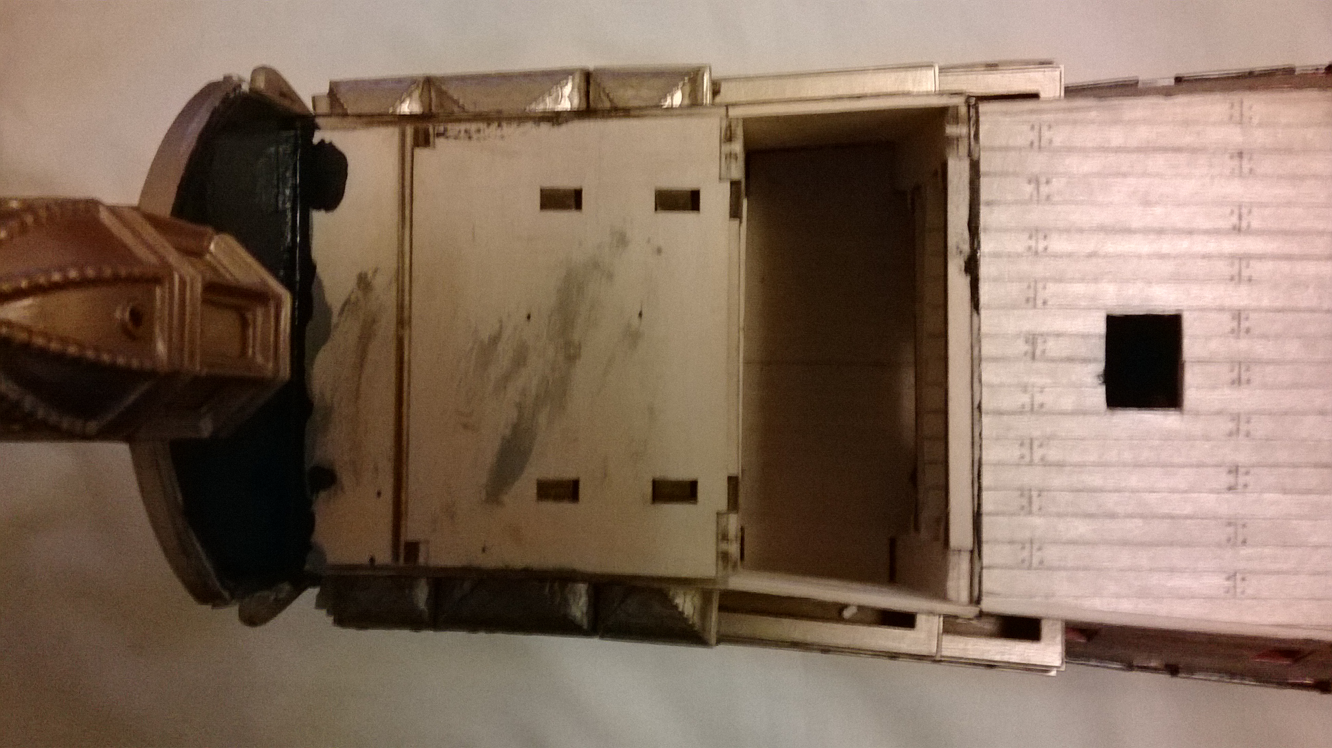

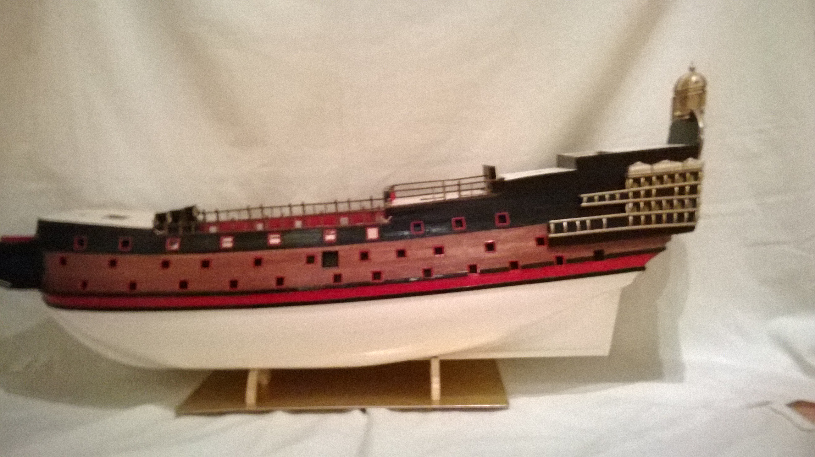

hi paul, need some pics, 1st, a pic of the quarterdeck, and a pic of the stern, and a pic taken sq.on showing all the decks, and finally a overhead shot looking down on the troubled deck. should be too bad a job at the mo
also can you give me the measurements on the affected deck? so I can check with mine.
Paulc
#6 Posted : 20 February 2014 08:14:19
Joined: 18/02/2014
Posts: 10
Points: 33
Location: Cowley

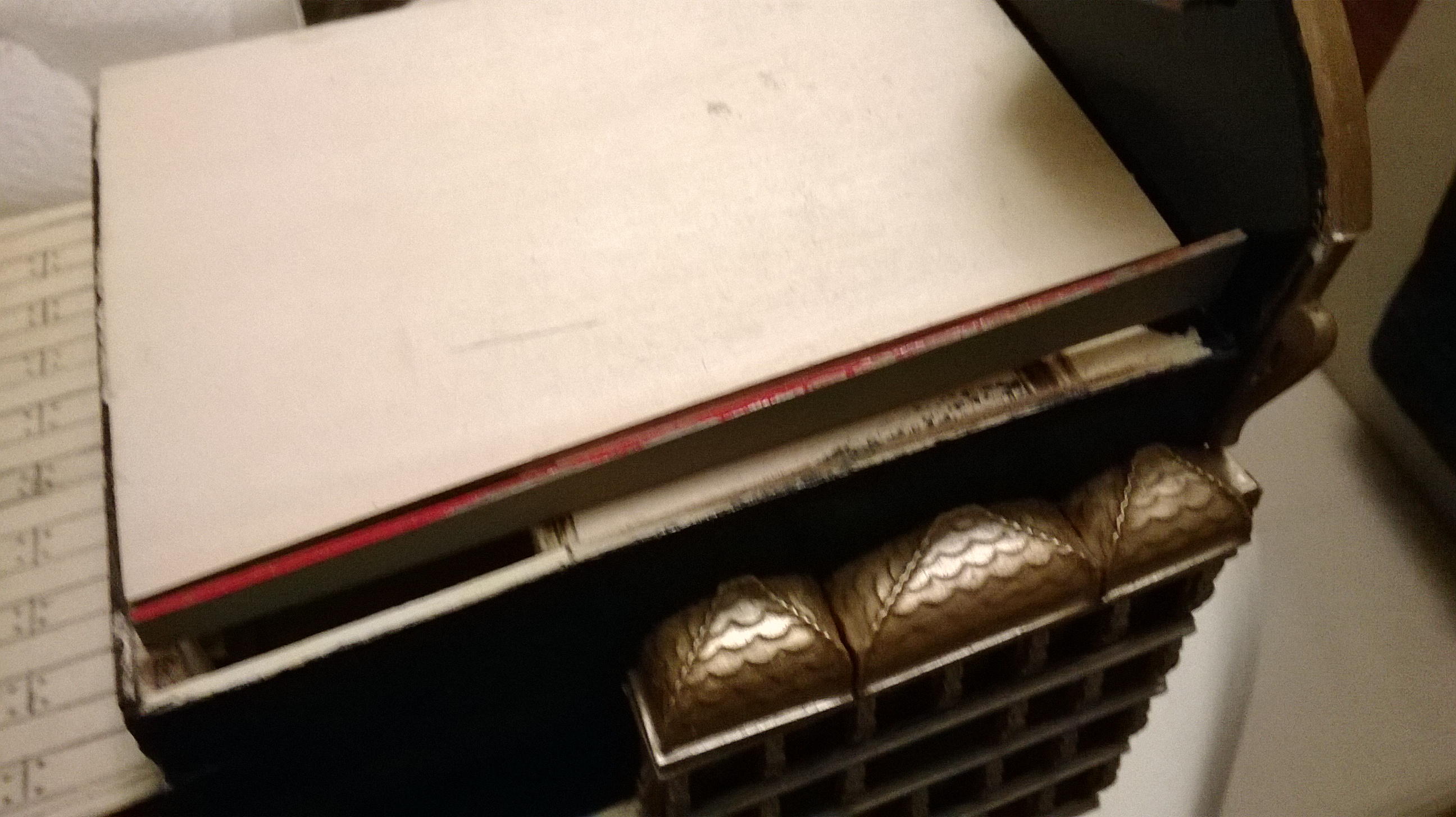

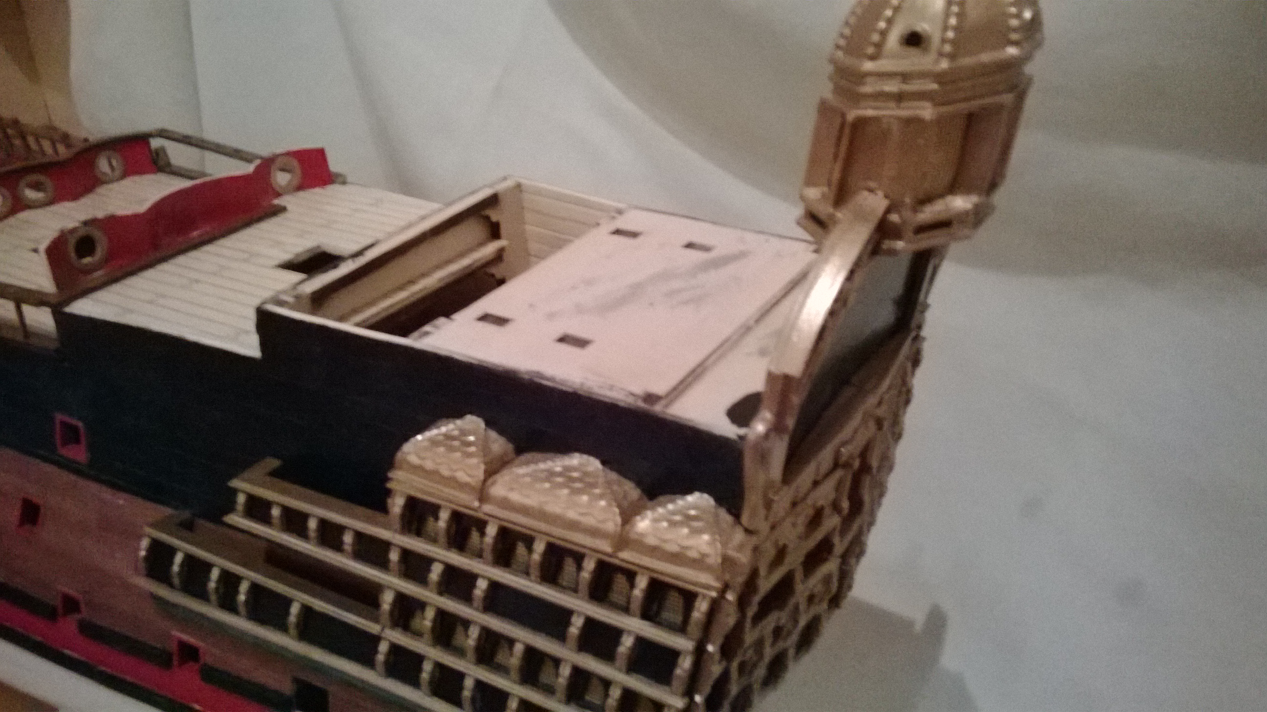

Hi Karl. I hope these help a bit more. The quarterdeck panel measures 123mm but the distance on my model is 126mm from the inner face of the transom to the end of the bulkhead.
#7 Posted : 20 February 2014 15:49:08
hi paul, the fix itself is fairly straightforward, and requires a bit of soaking and razor sawing and a couple of clamps also a 3mm. fill-in on the lower deck should do it. the former that has the front edge on the quarter deck supporting it,needs to me moved back 3mm. the former was not quite aligned correctly, easy to do. fairly easy to put right. you need to soak the inside of the planking with a medium paintbrush,and carefully ease the planks away from the former.the former should then be moved back 3mm. re-glue the planking and putting clamps in place while the glue sets.this will leave a 3mm gap in the next deck down,which is filled with a 3mm.fillet across the deck.razor saw the gunwales 3mm. back and reglue the baulkhead to the quarter deck. all should be well. good luck.
