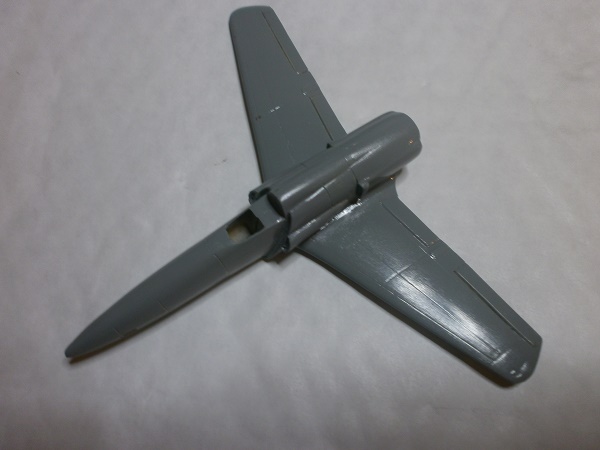

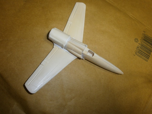

#1 Posted : 15 February 2014 15:28:10

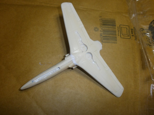

BigGrin Hi All

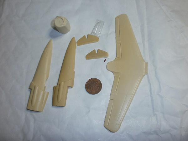

I recently did a kit revue of this model that I got off e-bay, Here is where the build diary will be.

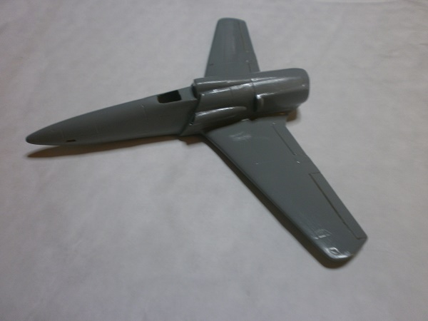

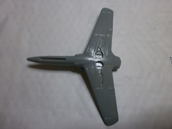

Firstly the casting sprue's and flash were removed then the parts cleaned up and any air bubbles in the resin castings filled using liquid putty. Lead was added to the nose area in the holes left in the casting and the two sides of the fuselage joined together and shaped to match then the wings and engine casting were joined together with the forward fuselage sections.
At the moment I am slowly building up putty in the joint lines until they are filled then starts the shaping process to make all the parts one.
More soon

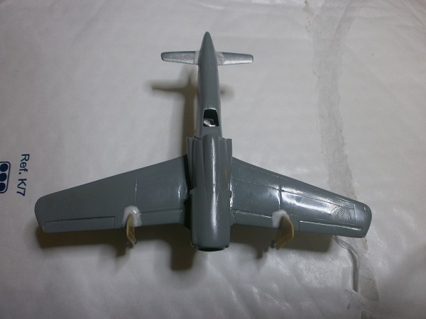

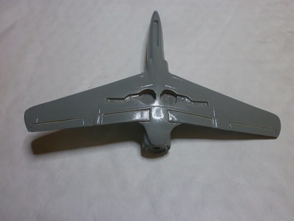

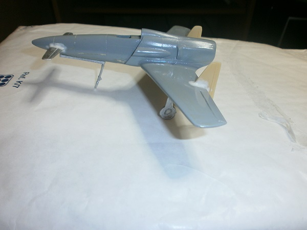

#2 Posted : 16 February 2014 18:49:07

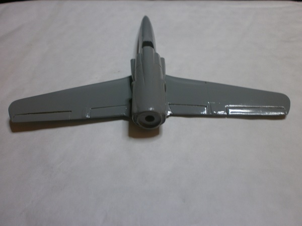

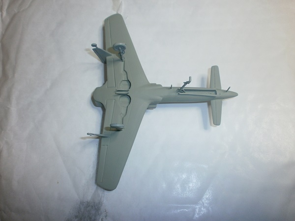

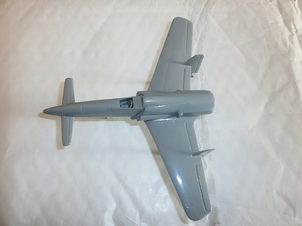

BigGrin Hi All

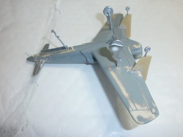

After lots of filing, filling and sanding the 1st light coat of grey undercoat goes on this is more to highlight any blemishes or places missed . Now its a case of rectifying those places so a nice even and smooth finish is obtained.

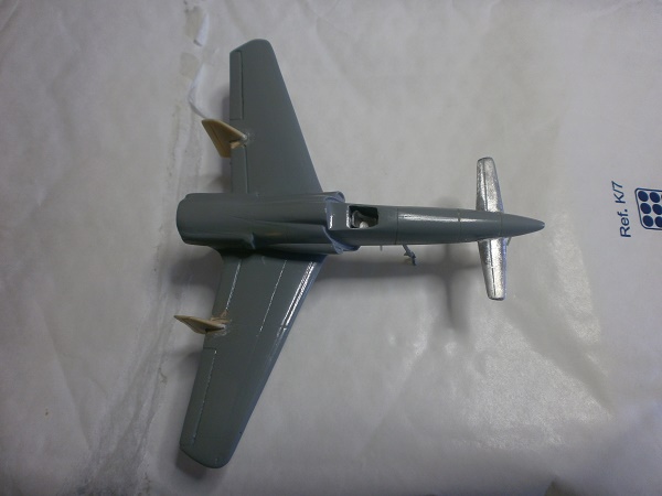

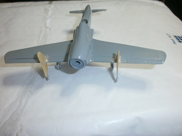

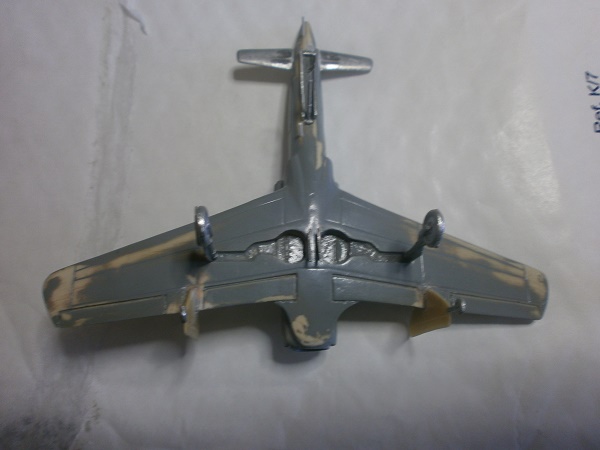

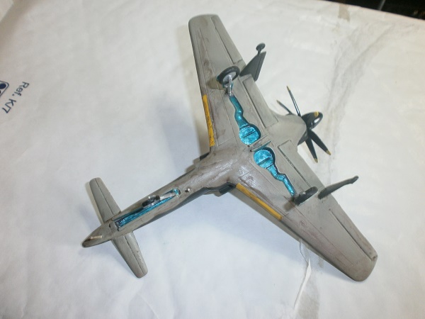

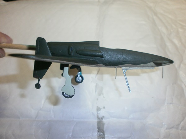

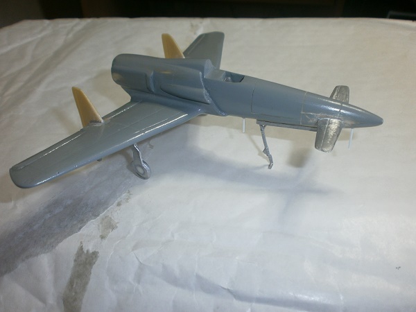

#3 Posted : 08 March 2014 20:35:42

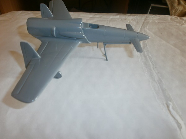

BigGrin Hi All

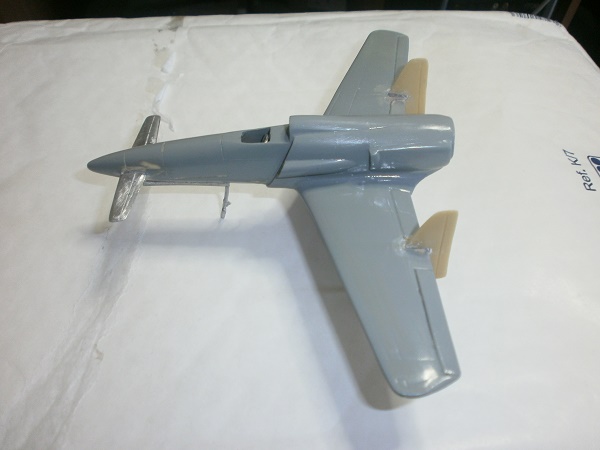

Some more progress, the front stub wings have been fitted and the rear stabilizers with there wheels attached. The undercariage has been prepared and fitted and the first coats of putty added to the joints ready for shaping. More soon
#4 Posted : 08 March 2014 21:08:18
#5 Posted : 08 March 2014 21:28:32
BigGrin Hi Steve
The liquid putty is great it will fill gaps/holes but sometimes needs a couple of applications to build it up, using a brush is possable but it will ruin it I have found runing it in with a cocktail stick works fine.
It must be left for at least 24 hours to fully cure but then it sands quite freely like squadron. Here's a link to where I got it from the Mr Hobby Resin Primer is top notch too.

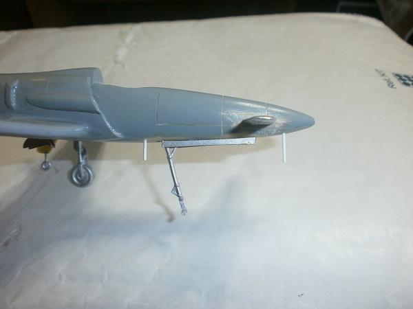

#9 Posted : 09 March 2014 13:26:14
BigGrin Hi All
The excess filler after being left overnight has now been removed from the area's its not needed and the addition of the radio ariel's on the lower fuselarge using plastic rod. Now its time to undercaot and tidy up ant blemeshes that still show.

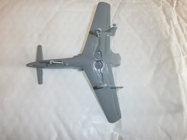

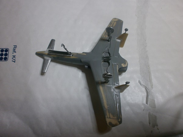

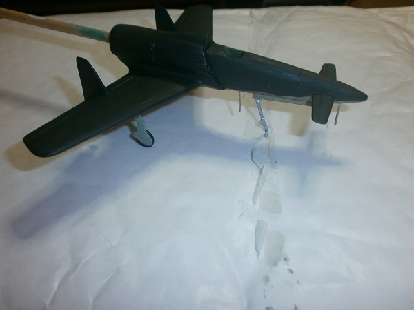

#10 Posted : 09 March 2014 20:52:19

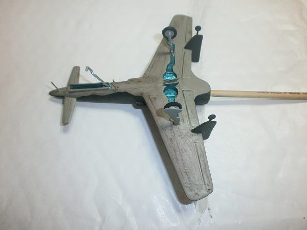

BigGrin Hi all

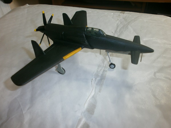

Just a small update the model has been fully undercoated now and cleaned up where needed.
The first coat of Grey-Green has been sprayed onto the under surfaces. once this has had time to fully cure its masking and spraying the top surfaces.

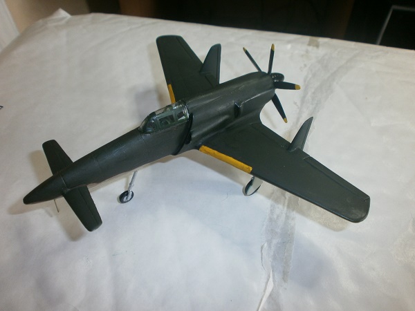

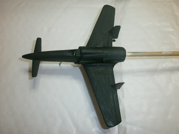

#11 Posted : 15 March 2014 19:16:15
BigGrin Hi All
Some more progress, the upper surfaces have had a coat of IJN green and then a wash of umber to bring out the panel lines and dirty her up. There is still some painting to do and im still awaiting the arrival of the decals.
#12 Posted : 15 March 2014 19:48:12
Looking good AndyBigGrin
can I ask which method you used for masking the wavy lines, was it cut masking tape or did you use the blu-tack method?

#14 Posted : 15 March 2014 20:04:02
BigGrin Hi Jase
Thanks for looking in and your comments, I used masking tape and a scalpel to get the wavy line, just my preferred method

#17 Posted : 16 March 2014 17:48:58

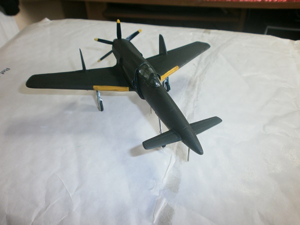

BigGrin Hi All

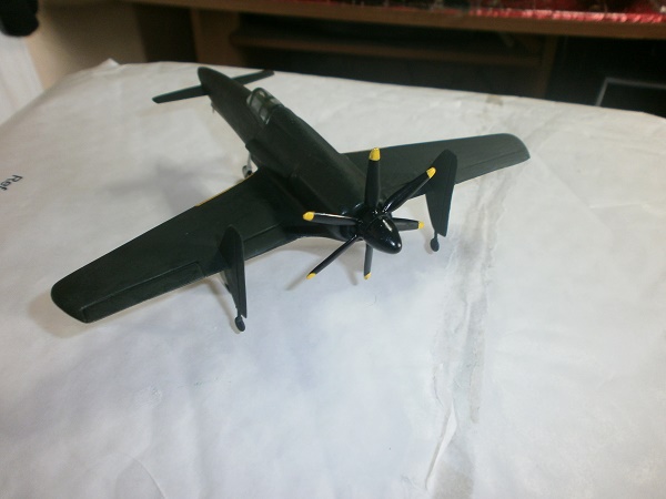

the front wheel has been painted and fitted as have the propelor and spinner, the yellow warning bars have been painted on and finaly the canopy added, this was stuck on using glue and glaze.
All im awaiting now is the decals to finish her off
More soon

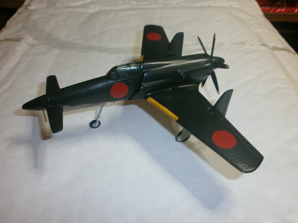

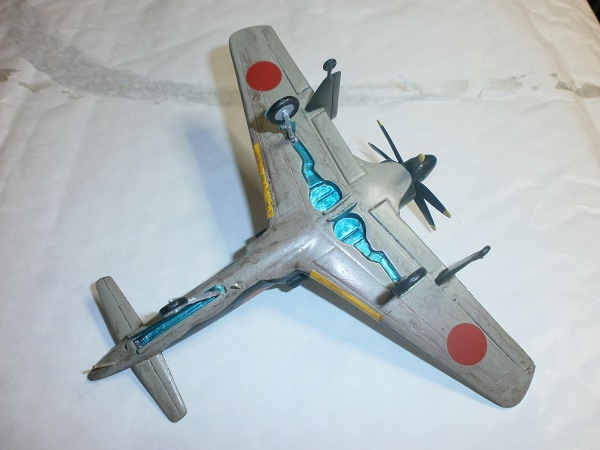

#19 Posted : 18 March 2014 19:22:24

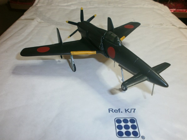

BigGrin Hi All

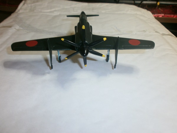

The decals have now been attached and a final coat of matt varnish to seal everything in.
So here she is not too bad for a 1st effort in resin kits and an old one at that
