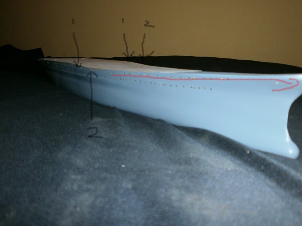

The deck from the stern is flat until it meets this point on this part of the hull then there is a distinctive downward slope for the 3 formers that after then climbs upwards to the bow. The two forward guns are attached to this sloped area and the barbets are pre shaped to fit this part of the deck.
To explain this better in the picture black arrows 1 are where the slope starts and arrows 2 is where it finishes the red arrow shows the upward curve of the deck forward of point 2

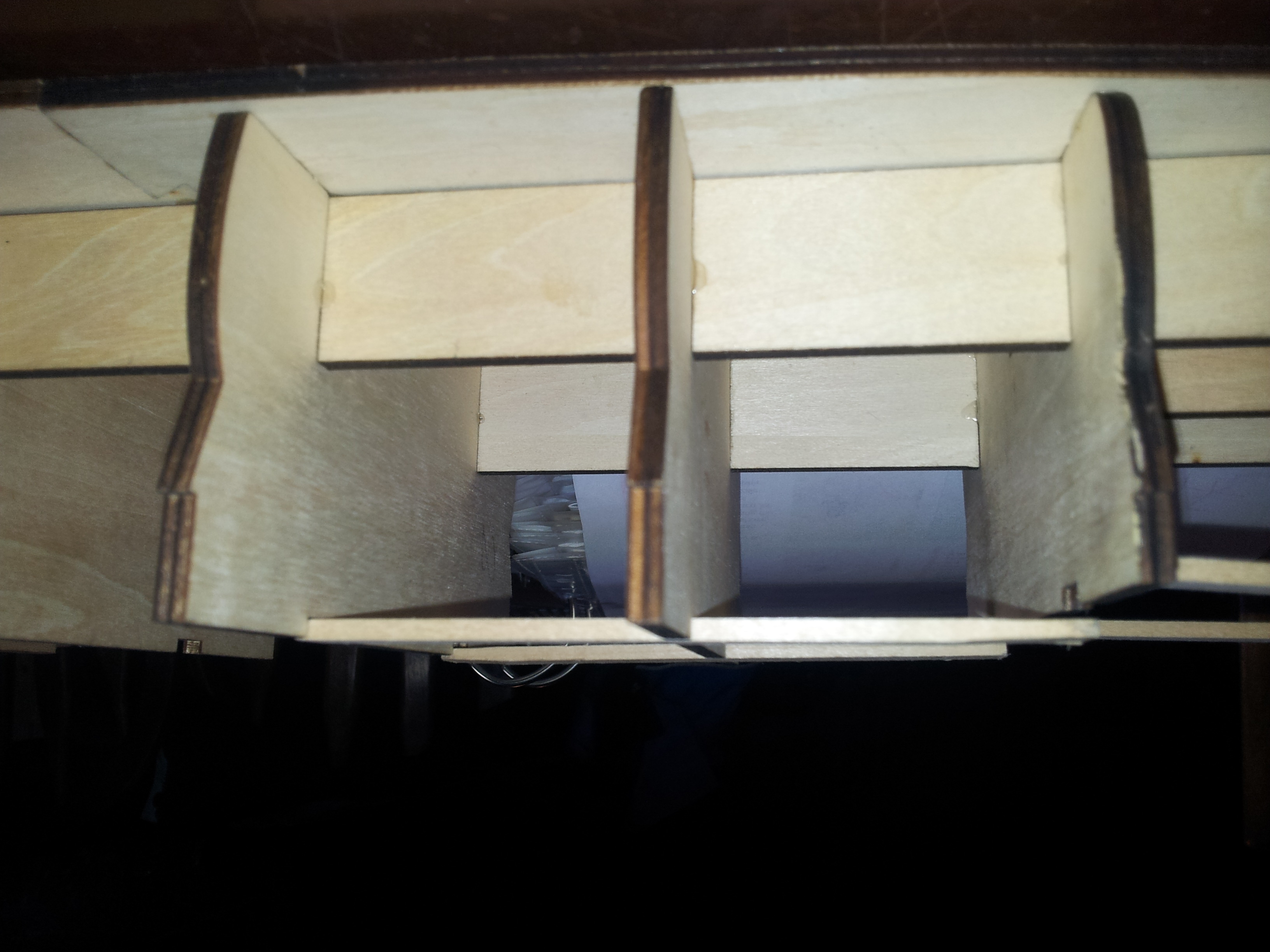

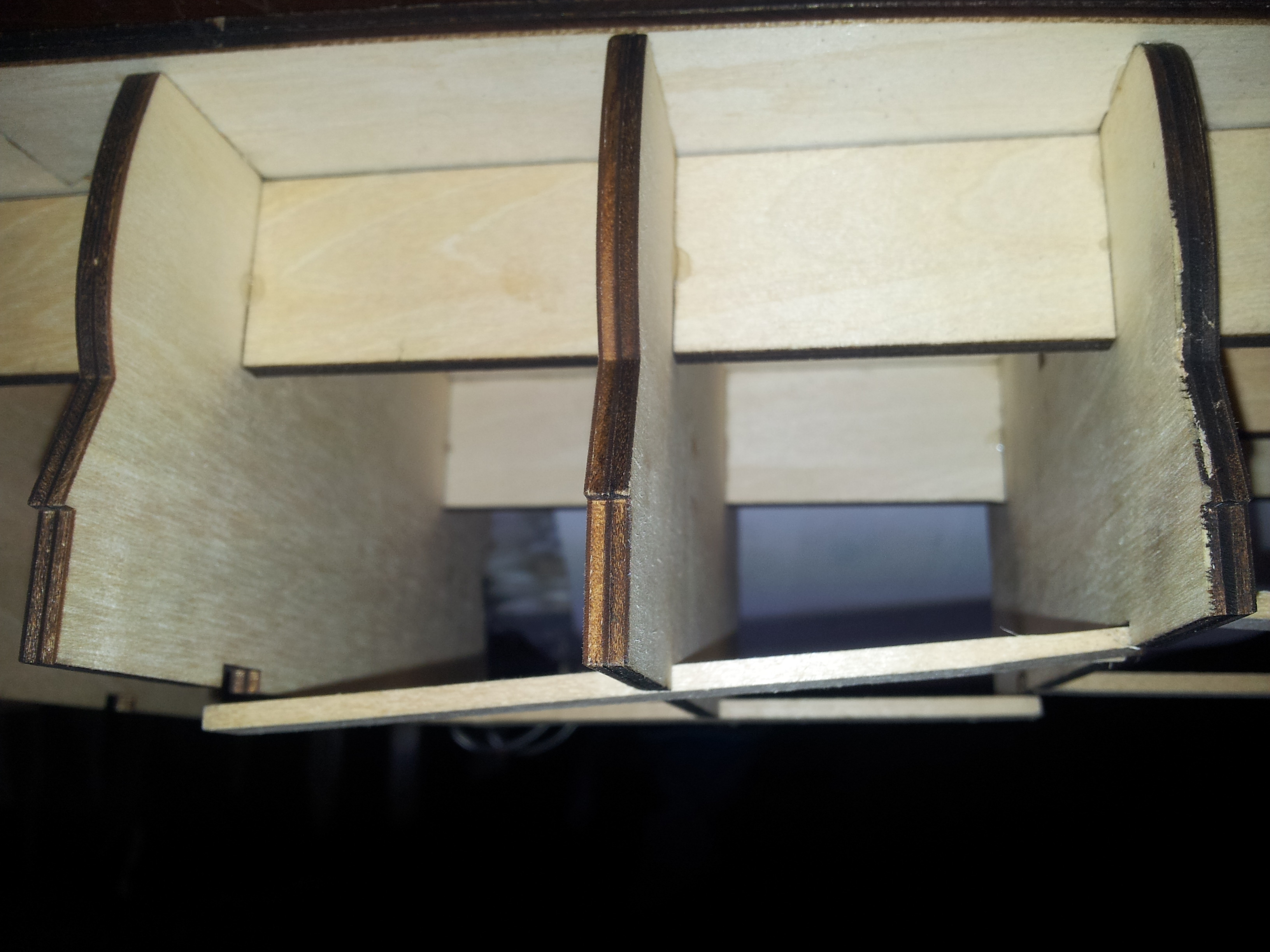

my apologies for silence. been a bad week or three. i have a couple of pics that i hope show the problem. frame 6 is just a bit lower. do i bend the reinforcement? it i a short piece so i don't want to force. the pic in the build diary looks like it id bent to fit.
#12 Posted : 06 March 2014 22:46:25
BigGrin Hi Niel
Now we have some pics I may have spotted your problem but another picture from the bow back toward the stern would help even more, in your second picture the centre former and the one to the right of it are I think the same former this can be confirmed by measuring them both. If they both measure the same height/width then I suspect the central former will need replacing with the correct former.

you r correct. the middle one (7)is identical to the right (8) except for lugs at the bottom. I have been of the opinion that the middle should be half way between 6 and 7 in height but I have no other pieces and each one has been carefully numbered as I received them.
