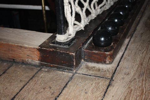

#16 Posted : 26 January 2014 13:19:53
BigGrin Hi Val
Trenails were originaly wooden pegs but were superceaded by steal and other metals on more modern boats but the difference being that where metal was used either a wooden plug or tar was used to plug the hole thus sealing the metal in.
If you look at the pic below you can just make out the trenails/ plugs in the deck . hope this clears things up
val ellams
#17 Posted : 26 January 2014 15:30:49
Rank: Beginner Level 3
Joined: 28/09/2012
Posts: 29
Points: 67
Location: telford shrops
thanks for the pic andy yes i can see what mean. thanks valBigGrin
