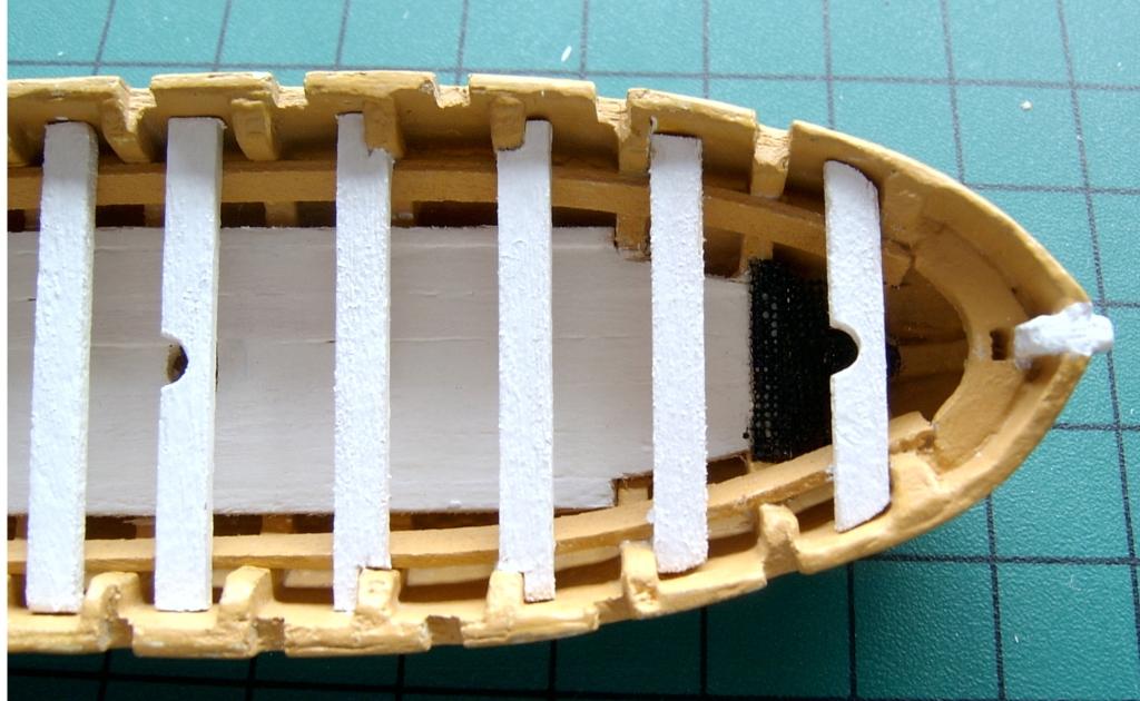

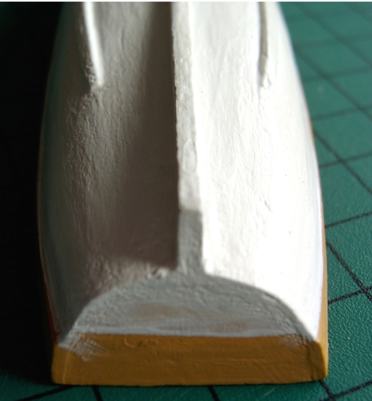

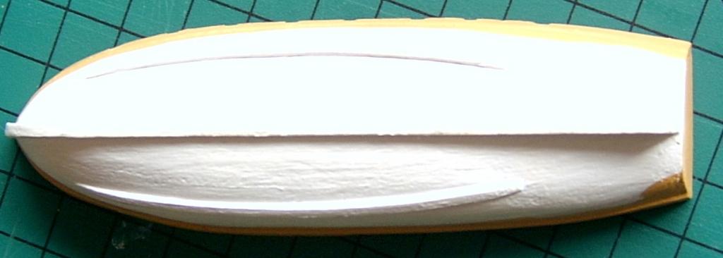

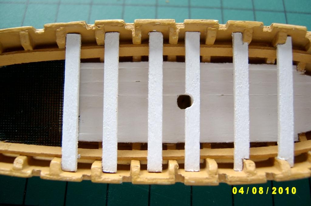

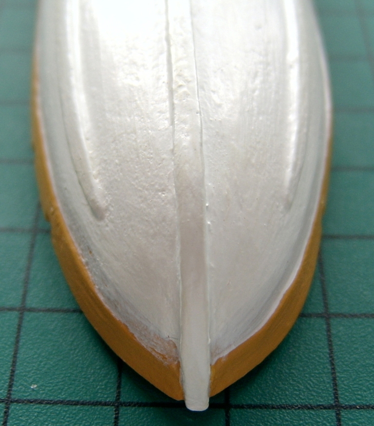

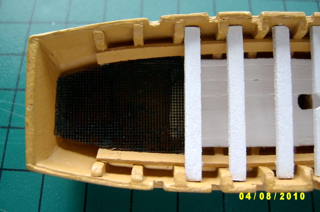

At long last the launch is taking shape and looking like it may be OK after all.
I made a basic error in assuming that the "precision cut laser parts" would fit together without any modification required, I now know better.
Having eventually sorting out the hull planking and oar slots, I fitted the floor boards, mesh inserts and thwarts. Now realize that I have not fitted the brass strip to the first and 5th thwart as I am awaiting delivery of the round nose pliers from eBay. I should have these by the weekend and will fit both in situ (I hope)
As you can see I have started to paint the outside of the hull and again hope to complete this weekend. Then on to the windlass, transom supports, eyebolt and rudder. Painting the oars should not be too difficult but I am a little apprehensive regarding the mast, but we shall see.
Below a selection of pictures of the build to date.
Sorry if the pics are to big, still trying to sort out the best way to upload them.
The paint finish looks awful but is not that bad in the flesh.
Hi All,
I have been busy building and here are the latest results of the main hull to date, the launch is also undergoing some rectification work and should be ready soon.
Any comments welcome but nothing to harsh as it is my first attempt.
Happy building to you all
CMB[biggrin

How the hell do you get black paint to stick to the grills? I'm using the official goauch paints for the build but no luck, it just seeps thro and doesn't dry.
CMB
#6 Posted : 05 August 2010 00:17:17
Joined: 23/03/2010
Posts: 205
Points: 598
Location: West Midlands
I used acrylic grey metal primer thined down so as not to fill in the mesh and the brush was almost dry.It took 2/3 coats then applied the black paint from the Victory set, again the brush was almost dry and applied 2/3 coats.As a point of interest I added 3ml water to the bottle of black paint and this thined it down nicely, also used the same method to the white and ochre paint. Paint still dries very quickly.
Hope this helps

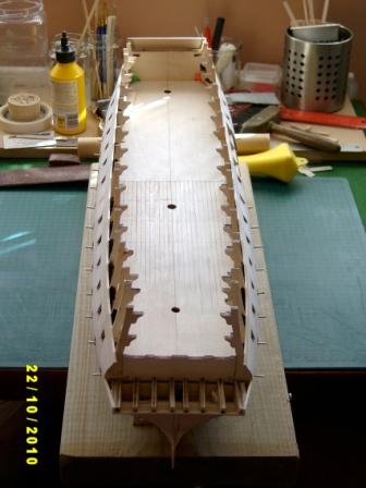

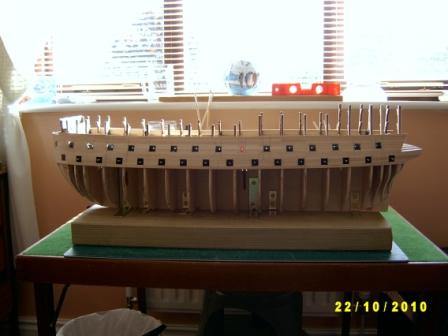

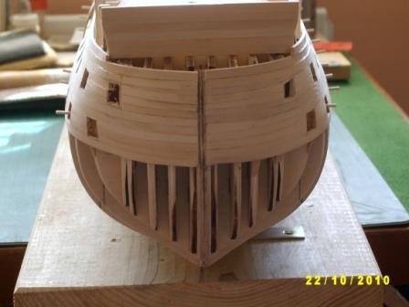

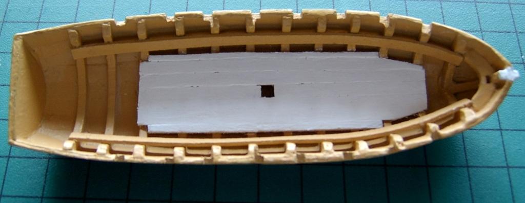

Hi All,
CMB[biggrin
