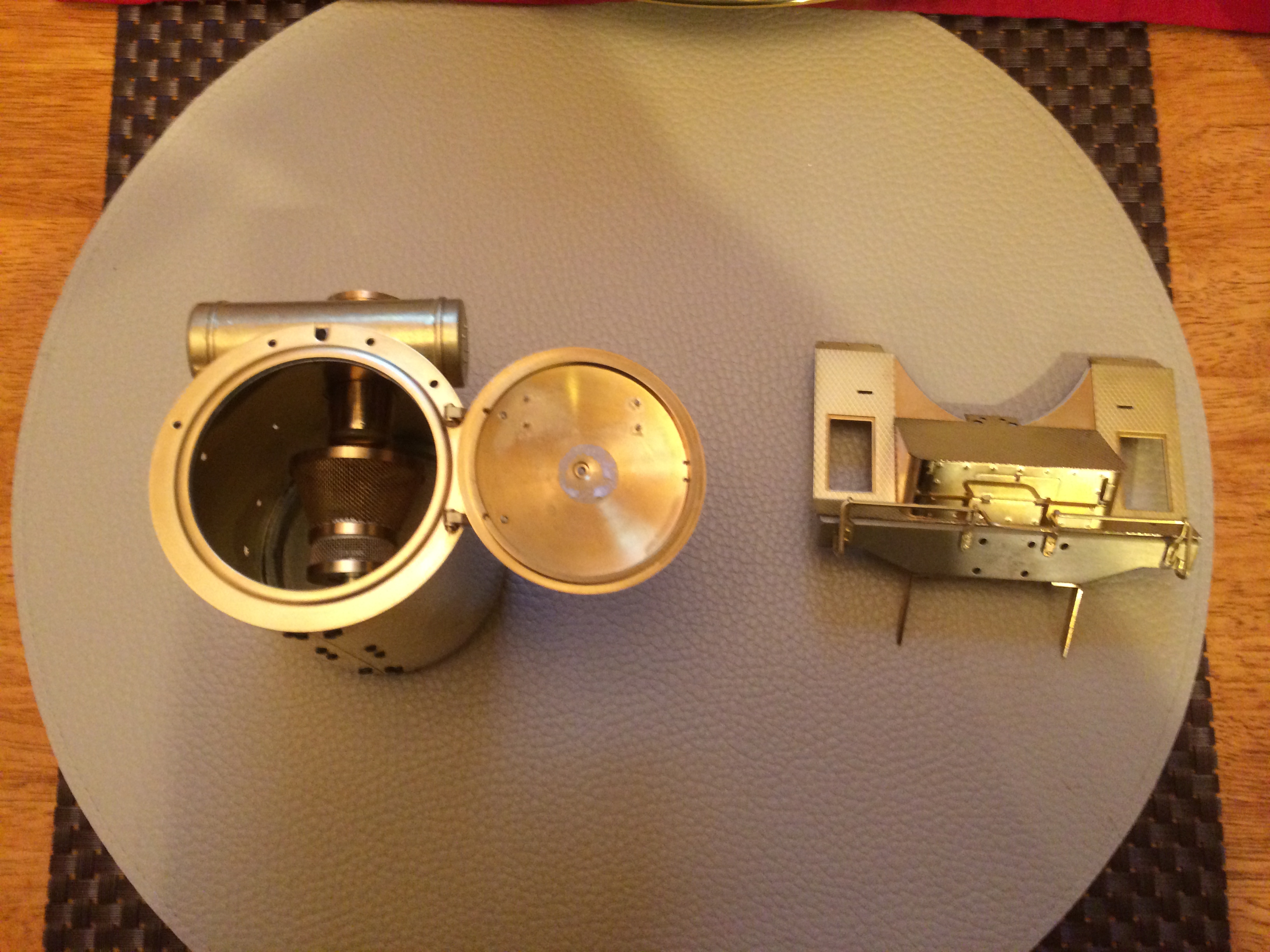

Step 1
It was easy to install the number plate and smokebox door.
I had a problem with the door hinges. The door is quite heavy so make sure you use decent strength epoxy to glue the hinges or they will pop off as mine did until I used better epoxy.
Step 2-Smoke box and boiler hinge joint
My second tip is to get a GOOD small screwdriver set.I used a cheap set and the Philips head on the screws was too small to fit the screwdriver.I ended up using one I have for my RC helicopter and it worked perfectly. The screws are really nice-good positive fit and easy to screw in. They are small and a little fiddly to get into the holes.
My boiler hinge needed careful alignment to keep it parallel to the edge of the smokebox until the epoxy dried.
Step 3 Chimney and feedwater system.
No problems here.The feedwater system is a heavy piece of brass.let the epoxy thoroughly dry before moving the smokebox around or gravity will pull the feedwater tank out of its mounting holes (ask me how I know).

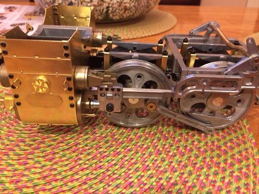

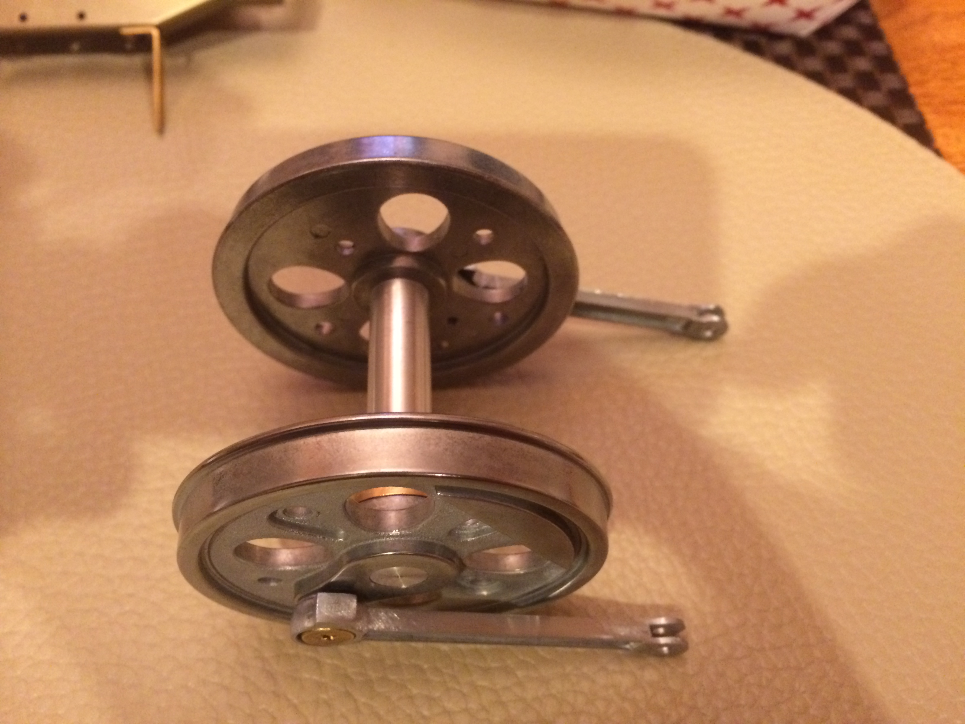

Step 4 Driving wheels and coupling rods
Easy step again.I used a file to remove the mold cast line on the coupling rods and then used fine sandpaper to smooth the metal.

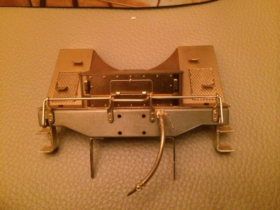

Step 6 Front deck
Everything went together very well here.The parts fit well together and the assembly is easy.

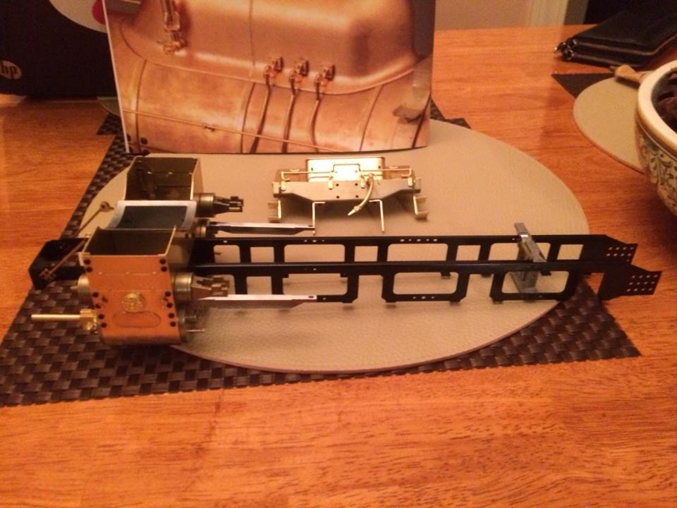

#5 Posted : 20 January 2014 02:39:49

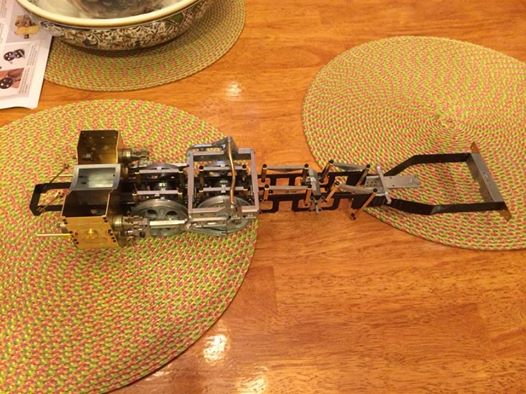

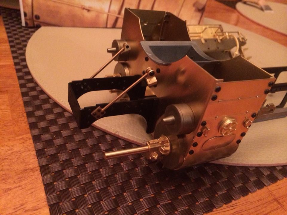

My second pack arrived and I eagerly ripped the big bag open and started building.
I finished the parts on the front and assembled the underframe with no problems.
Now those tiny rivets you have to put in the underframe were a little trying.They were difficult to grab and a couple of them pinged out of my tweezers never to be seen again. Fortunately there are some spares.It took me more time to fit those little devils into their holes than it did to complete the rest of this pack.
The front cylinders are easy to build and the parts are nice and solid.
The frame is already quite heavy.
It is looking great.
Total build time
pack 1:2 hours
Pack 2: 2 1/2 hours

Review of steps 17-24.
To those of you who recommended the pick and place tool I salute you!
I cant imagine placing all of those little rivets without it.
The pushrods and motion frame were easy to assemble
The screws connecting to new rear part of the frame had to be very carefully positioned or they wouldn't screw all the way in. A bit fiddly, but not too bad.
The suspension was easy to make, but a little tricky to install.it may have been easier to install the front suspension before the motion frame, but hen it may have been trickier to install the motion frame.
Anyway it did get in the way when attaching the suspension to the frame.
The wheels were a little fiddly to attach too.I used masking tape to hold the 2 sides of the wheel clamps together but it was hard to slide both sides into the frame and keep everything together.I found the key was to try to eyeball the fit and then slowly lower both sides at the same time until you feel them engage on the frame and then they just dropped it.
That's it for this build. A nice spanner for the nuts on the suspension would have come in handy but it was OK with a set of fine nosed pliers.
It is getting quite heavy already and starting to look like a train.
looking forward to the next installment.
This stage (17-24) took me 4 hours .

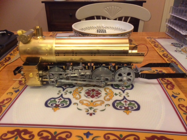

#10 Posted : 20 May 2014 16:42:30
Stages 25-32
These finish the build of the running gear.Not tricky to do, just a lot of parts. The instructions are very clear.
It took me about 4 hours to complete this section.

#14 Posted : 20 May 2014 18:52:16
I found the pick n place on Amazon Gary.
I am debating painting the body.Despite frequent polishing it is tarnishing already and I think it is too late to clear coat because I already have some scratches and tarnish I cant polish out.
I read that there will be a painting guide in the later sections. Does anyone know if that it true?
I am really enjoying this build. I hope they are planning on releasing more trains in this scale.

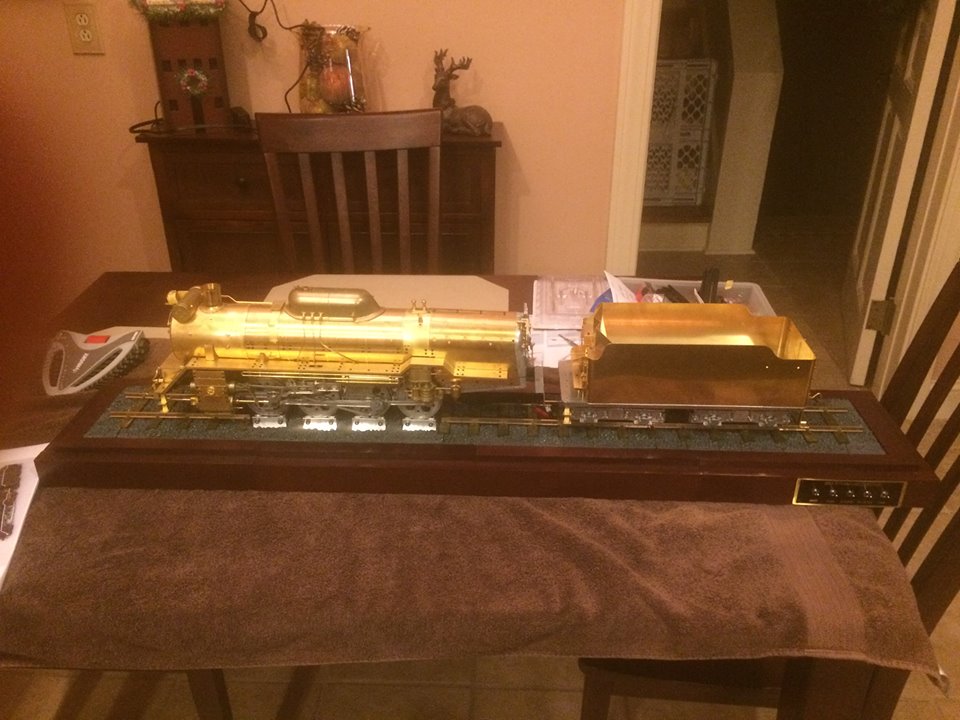

#20 Posted : 02 January 2015 01:46:28
Getting close to finishing the D51.The base is finished and most of the build.Waiting for paint to arrive.
