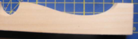

Good afternoon shipmates...please can anybody give me the correct dimensions of the wooden former used with the electric bender as I wish to make my own...much obliged...BigGrin

Hi m8, not sure if it's the same one you're after but here's the measurements of the one I've got -
L: 150mm
W: 15mm
H: 27mm
Small grove at trhe back - 40mm in diameter
Larger grove is photo'd below the back ground is 10mm sq
MadDogUK attached the following image(s):

Cheers MadDogUK...that's the one I'm after, and thanks for the measurements, now I can make my own..As it would be pointless buying the whole electric bender kit just for the former...cheers mate..

Not a problem at all m8, sorry the pic was a bit fussy!
