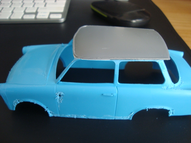

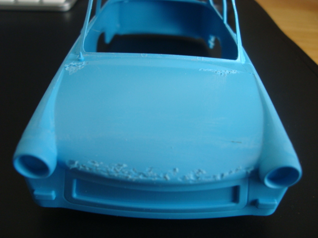

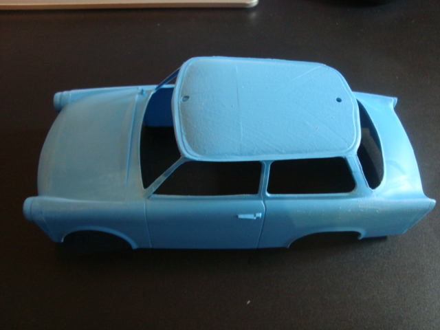

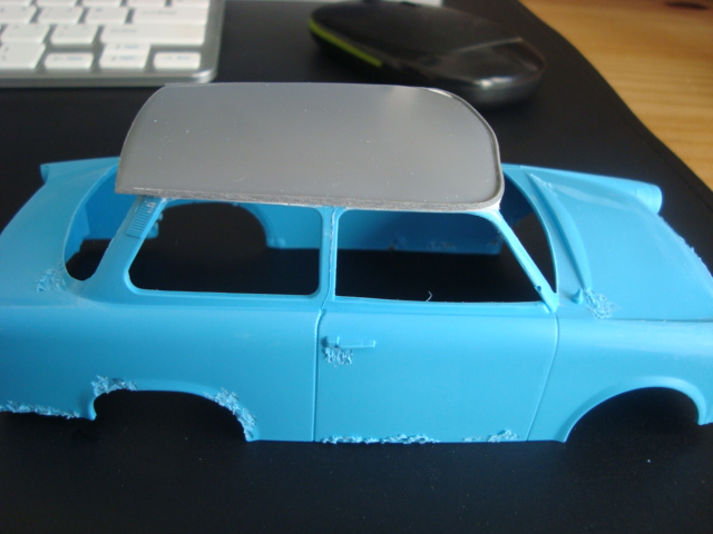

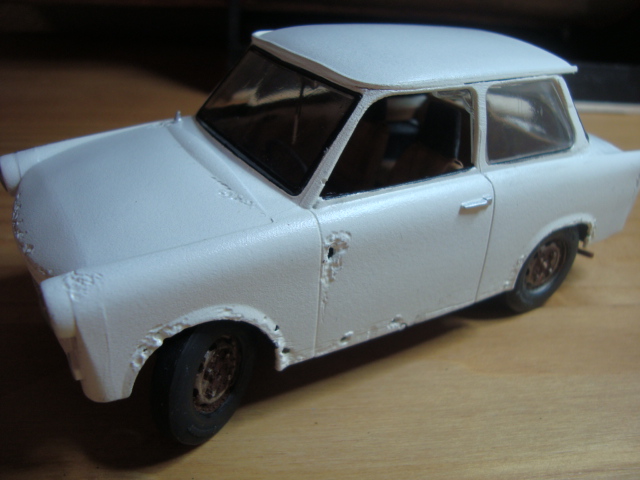

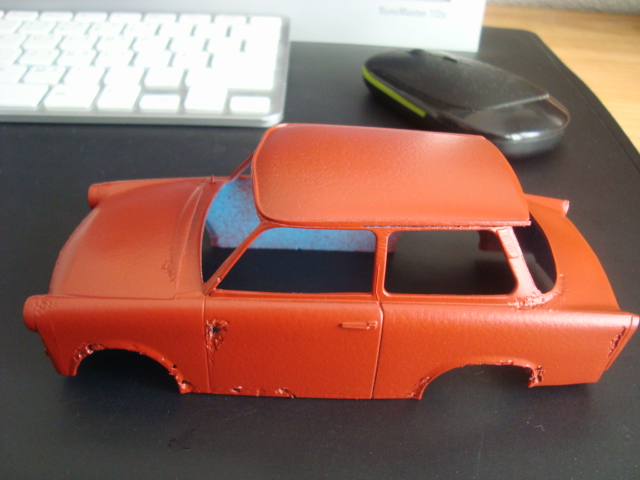

First job was to wash and prime the 1 piece body,but before priming I set to work on it with a dremmel BigGrin This provides nice rough areas for the rust to be placed later. Just to point out I did some of these stages a couple of days ago so I will be updating a lot today!

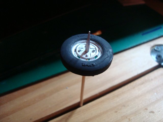

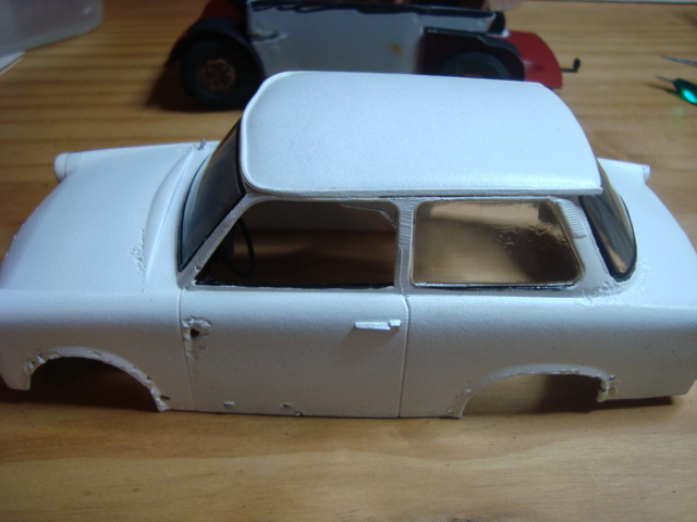

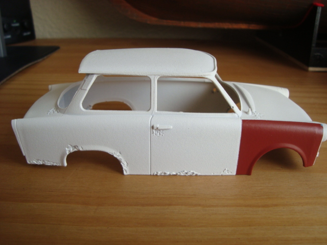

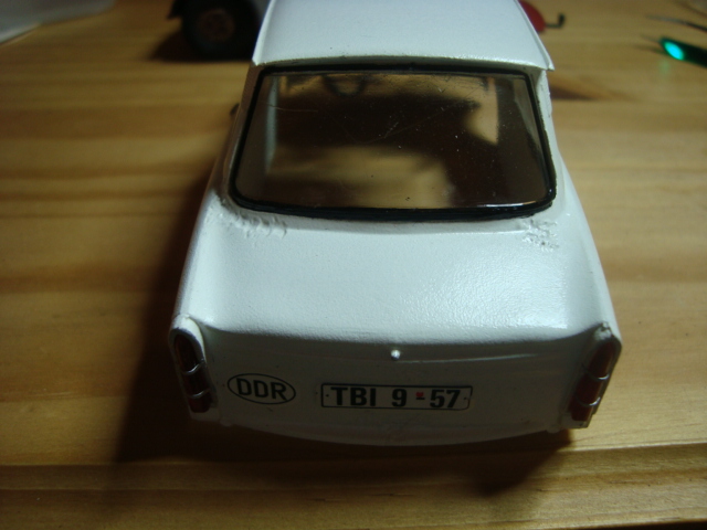

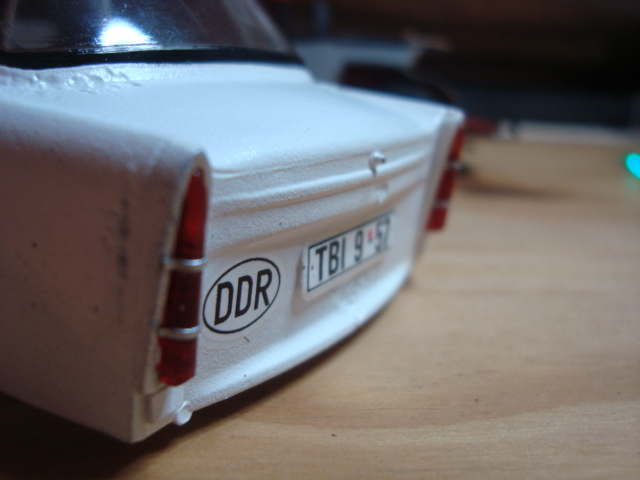

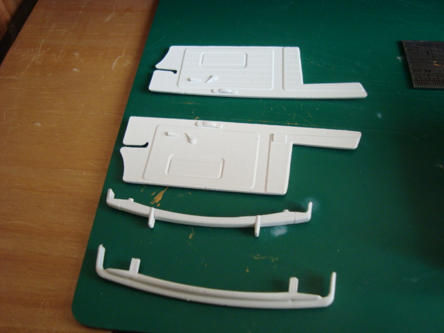

Next was building the wheels (no vinyl tyres in this kit) and getting all the white parts sprayed. I deliberatly wanted a non perfect base coat of paint so I used a satin white but sprayed it with a cold can in an even colder garage - this gave a slight orange peel effect and the roughness with take the grime washes and rust better.

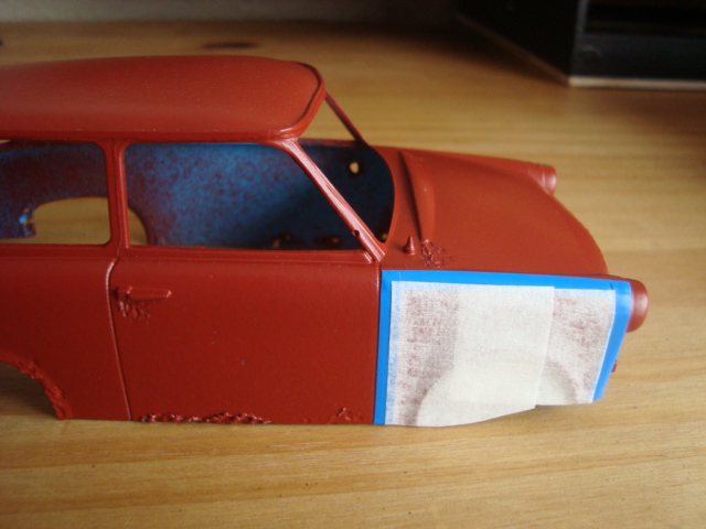

#6 Posted : 24 December 2013 13:48:20
I posted the last entry without pics so here they are - btw - I masked the one panel at the front as I want this to look like a new replacementBigGrin
The glass in the last pic was horrible to fit, completely the wrong shape so I will tidy this up later

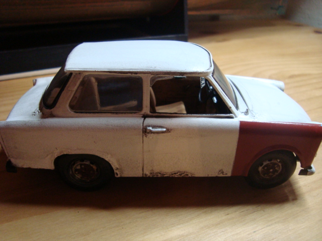

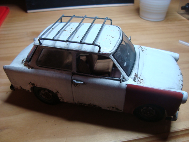

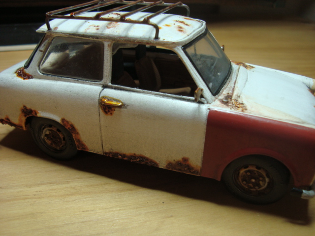

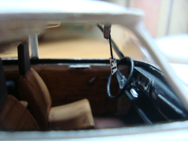

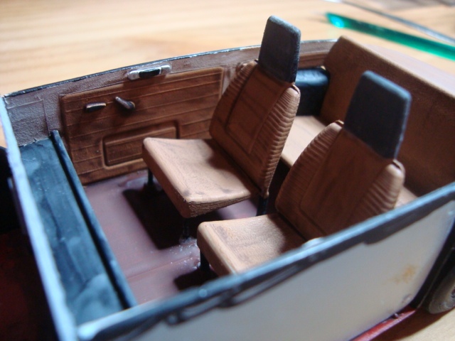

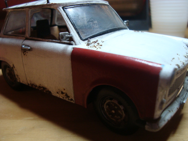

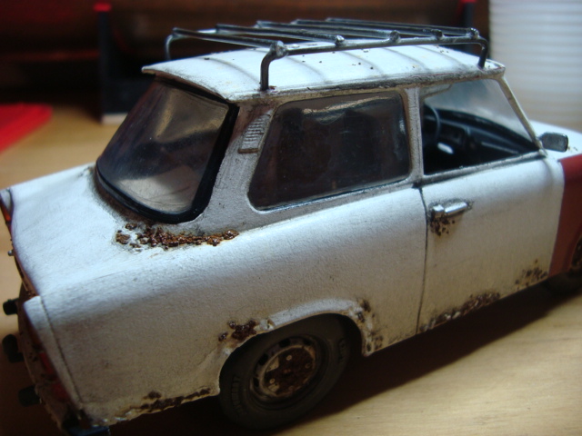

Got my pics in the right order now, I'm currently working on the display base and a figure to go with it and will update later, the car is nearly complete, just some more little details to add and another dirt wash over the rust - told you this was a quickie - only taken 3 days to the stage shown below as I used overnight time to cure the iron filings.
The inside was very simple, just seats and dashboard - I lost the steering wheel and had to make one from wire, you can just see the join in one pic, I also broke the roof rack but made that with wire tooBigGrin The fine parts were very brittle maybe due to age of this actual kit (24 years).

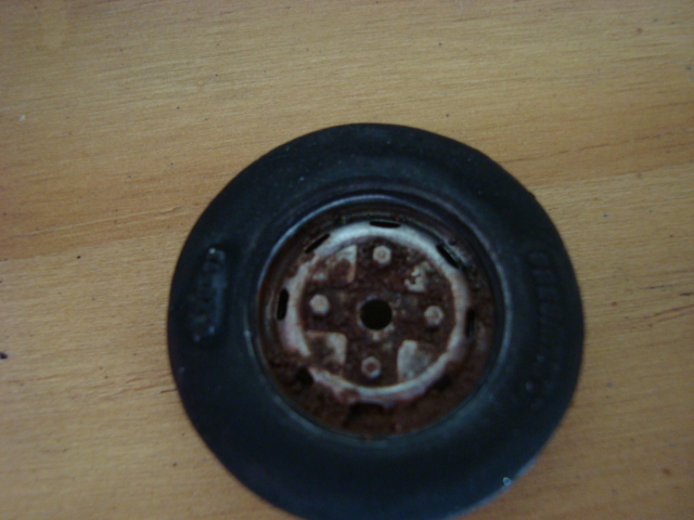

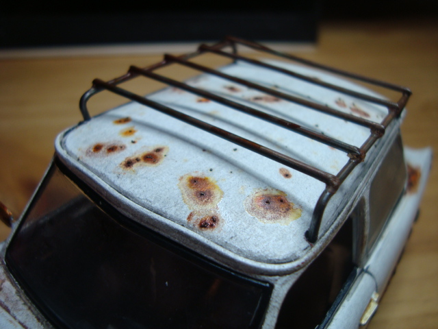

Here is the 1st wash layer using vallejo model color black. The wheel rust is not yet complete either, this is the result of iron filings and pva glue left overnight,it is obviously real rust but is dark as this is the oldest base layer of rust. If I re-wetted it and left overnight again it would turn more orangey but I will do this laterBigGrin

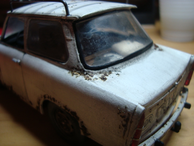

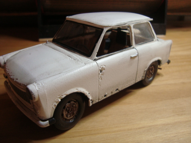

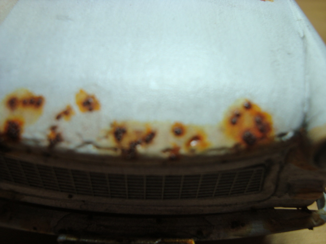

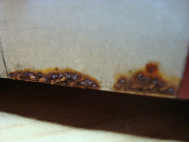

Here are some pics of the iron filings after a night, same as the wheels. As you can see the rust is very dark at this stage but this will be sorted out later with a couple of dabs of ak interactive rust followed by a last touch of tamiya clear orange... more coming up soonBigGrin

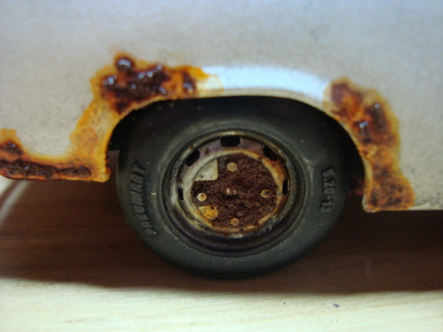

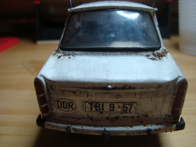

#15 Posted : 25 December 2013 22:54:35
Here are some more pics of rust, I have progressed further than this now and the base is also complete but not taken the pics yet.
The rust is now more orange but the original iron filings are still visible as the darker areas simulating the older rust.
Try getting them wheelnuts offLOL
