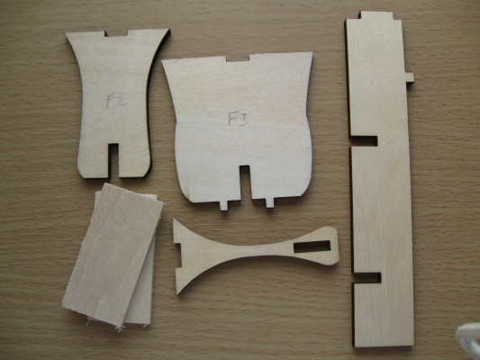

Let's start with the Hull construction, comprising of frames and beams.

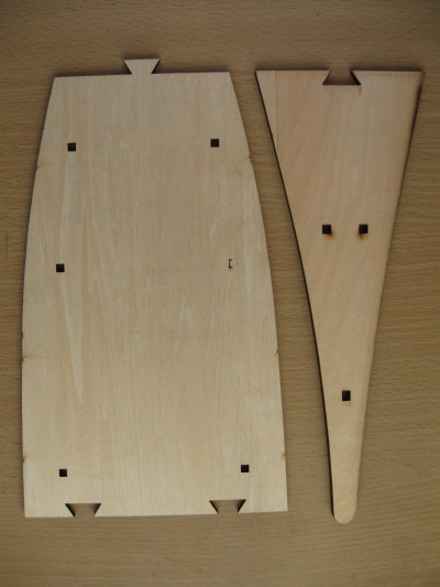

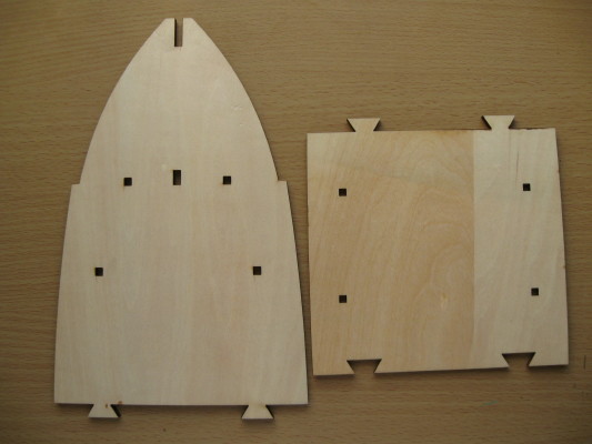

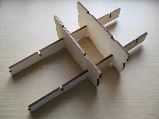

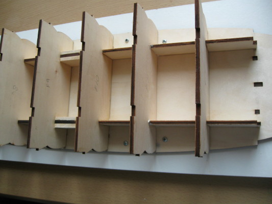

#2 Posted : 09 March 2010 17:42:40

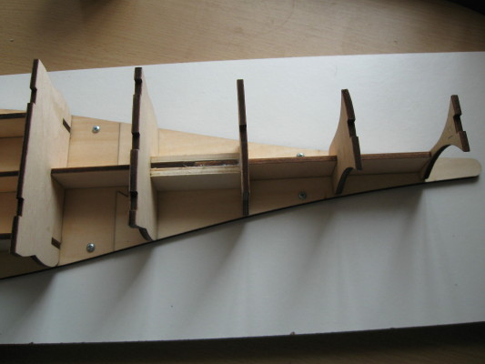

Hull base sections joined and then secured to a build board to avoid warp in the early stages of the Hull build.

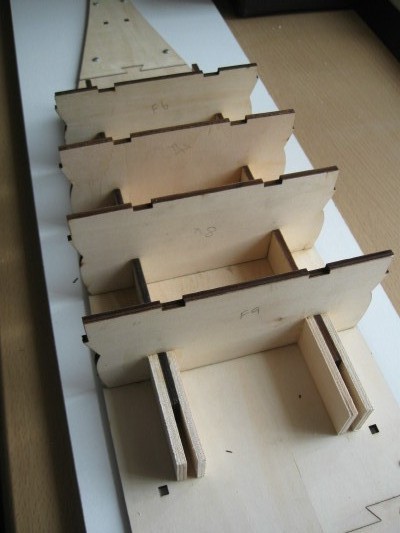

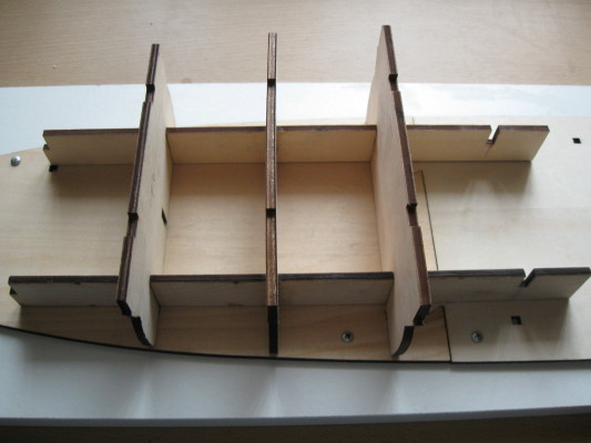

#3 Posted : 09 March 2010 17:45:04
More frames added
#4 Posted : 09 March 2010 17:46:54
along with beam joint strengtheners

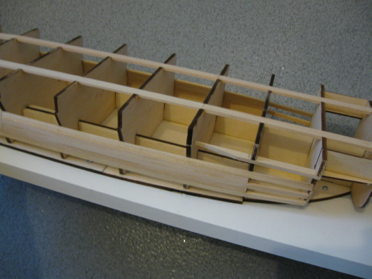

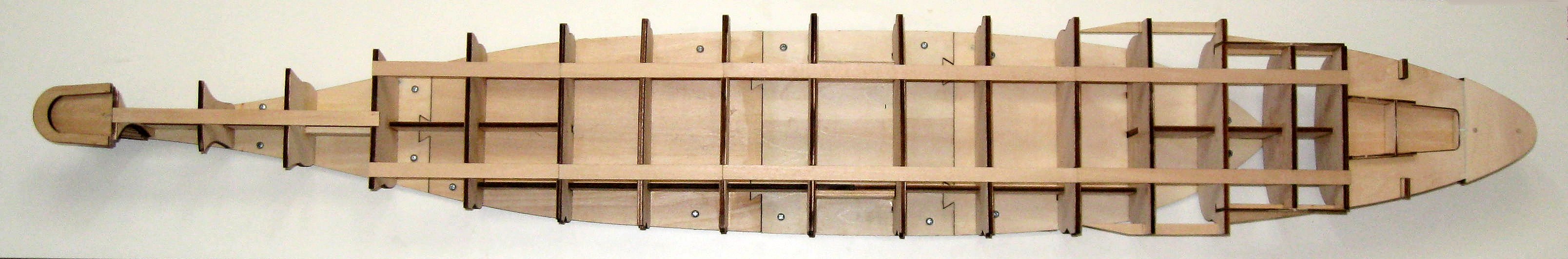

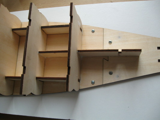

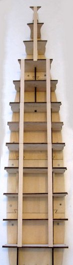

#5 Posted : 10 March 2010 09:27:35
More frames to add and two stern beams

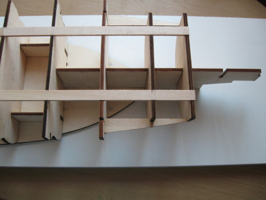

#6 Posted : 12 March 2010 09:23:04
More frames added and Keel half
#7 Posted : 12 March 2010 09:25:09
Bow frames added and the remaining Keel half

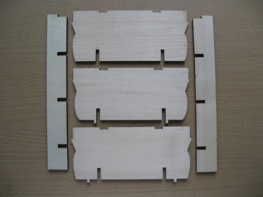

#8 Posted : 15 March 2010 18:38:48
Deck supports

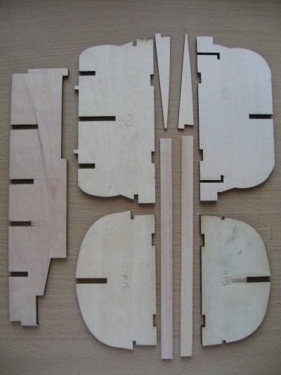

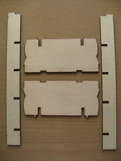

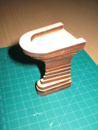

#11 Posted : 24 March 2010 09:21:31

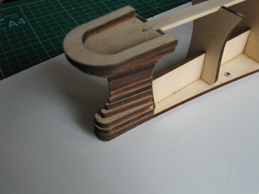

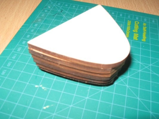

Building the stern block, I'wont be shaping the block until after the hull planking is laid.
#12 Posted : 24 March 2010 09:23:14

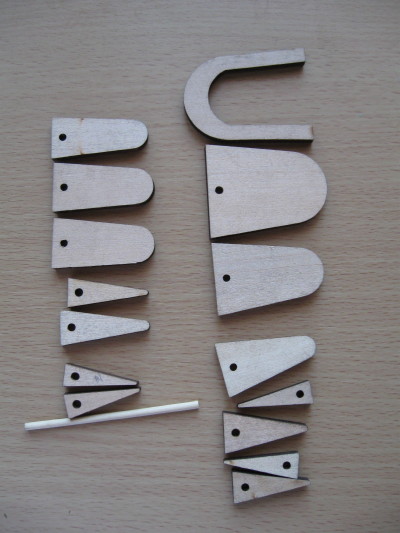

#13 Posted : 24 March 2010 09:28:20

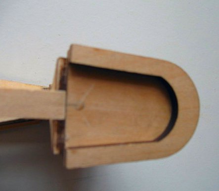

And now the Bow block, don't worry about the horseshoe sitting above the deck line, later on this is to be sanded at an angle to meet with the deck line, and is what transforms the top of upright bow block into the correct angle to meet with the deck angle.

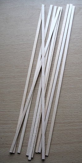

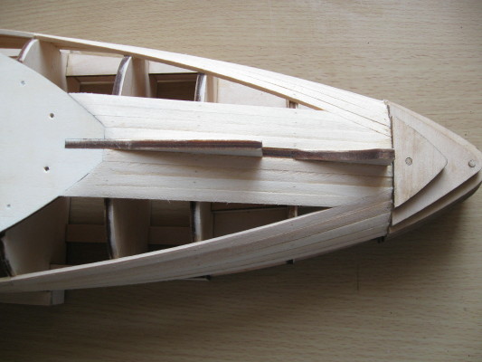

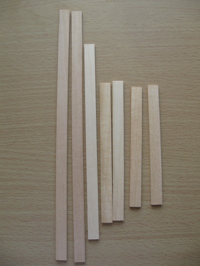

#16 Posted : 29 March 2010 09:48:43
The start of the hull planking which is single skinned, start at the bow and ensure you plank each side of the hull alternately, and that the planking is level across the beam, don't forget to glue plank-to-plank, the follow on plank gaps can be set with a plank off-cut, don't do any surface profiling until the planking is complete.

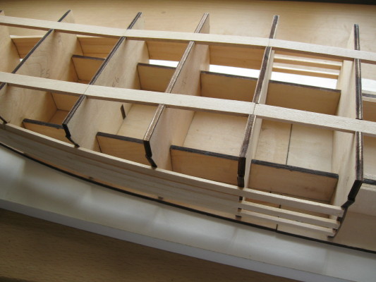

#17 Posted : 06 April 2010 12:04:07
More planking heading towards the stern, being a static dispaly model its a single skinned hull, both sides of the hull is planked in a 5 plank wide central band, where the above & below are tackled when both sides are complete, ensure you plank alternately either side of the hull.
#18 Posted : 12 April 2010 11:41:05
More planking running towards the stern, ensure that the stagger gaps are the same with of the planks, which can be set with off-cuts.

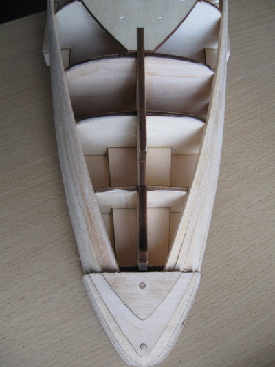

#19 Posted : 19 April 2010 10:39:24
Stern planking, the edges of the strakes will need to be slightly bevelled to ensure a good fit, ensure you retain all off-cuts and set aside two remaing strakes for later use.
