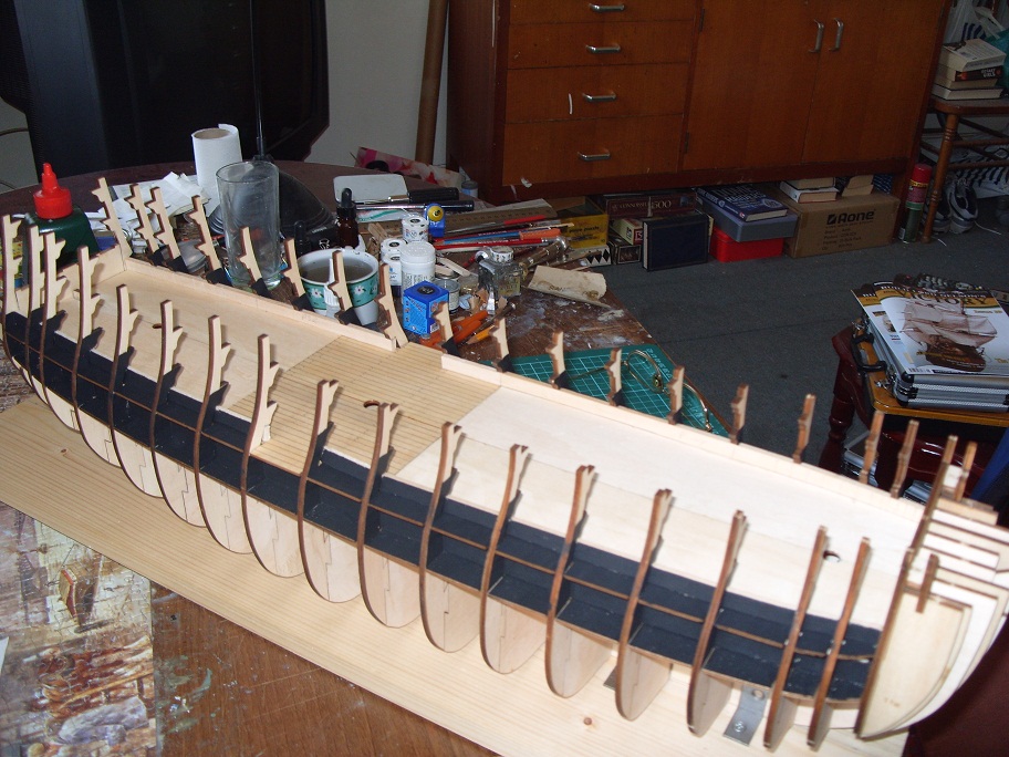

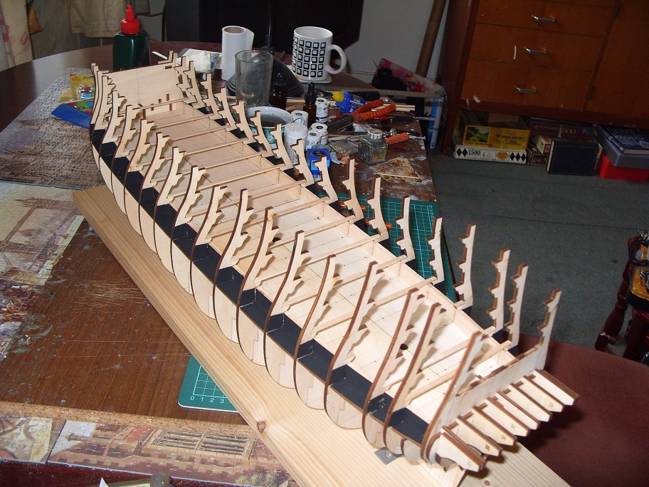

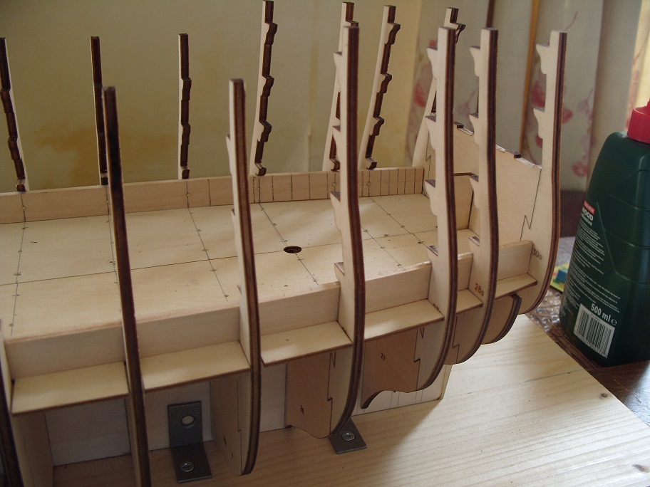

Well. here goes. This is my build upto now. Only the keel and bow section are glued. The cannon, anchor etc I have not started. I will do them as and when they are needed. (I'm worried about them getting damaged).

Sorry about quality of pictures. It's a new camera and this is the first time I've used it and the first time I've posted pictures.

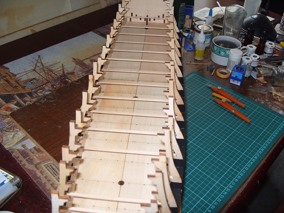

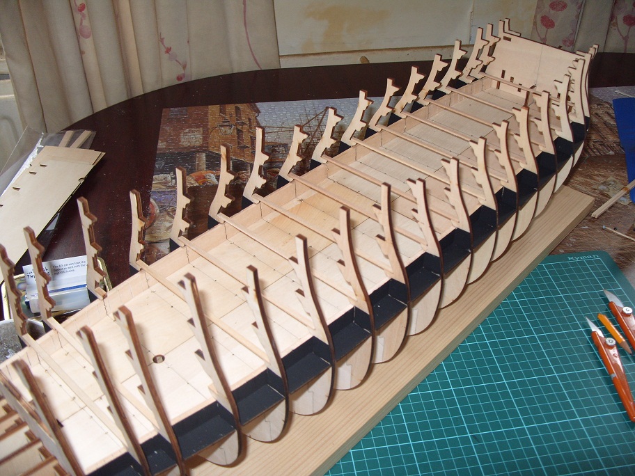

Sorry about the delay in posting more pics. I forgot that I was posting themBlushing.
Anyway, here's the latest batch. I must admit I've had very little trouble upto now on the hull build.

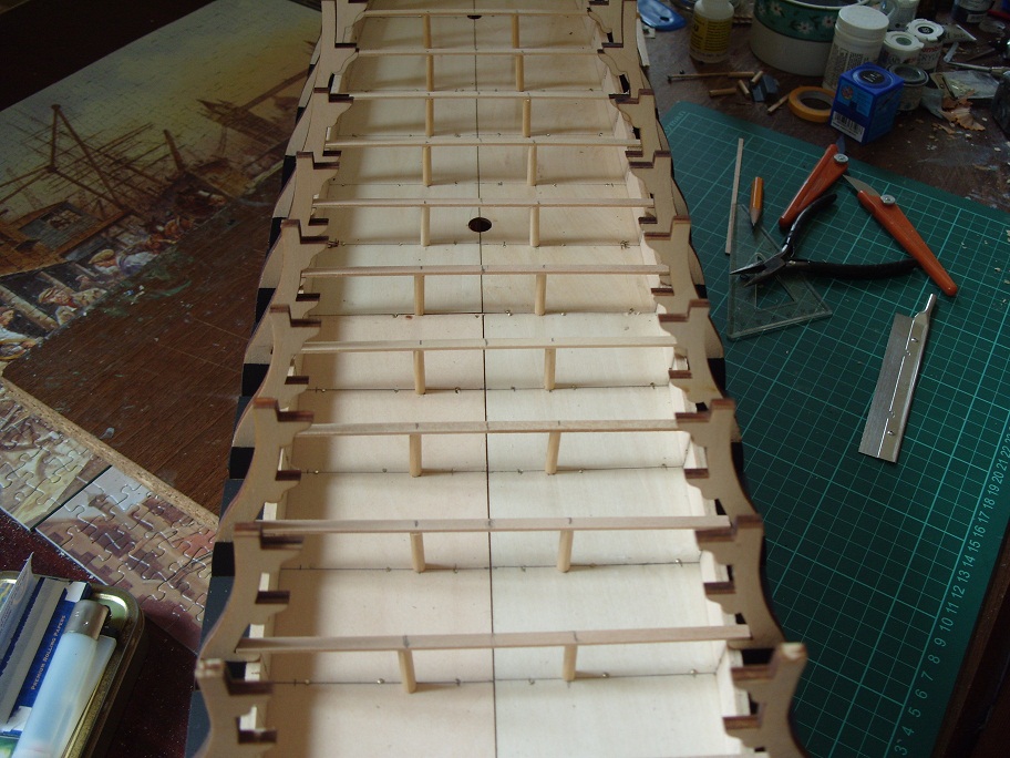

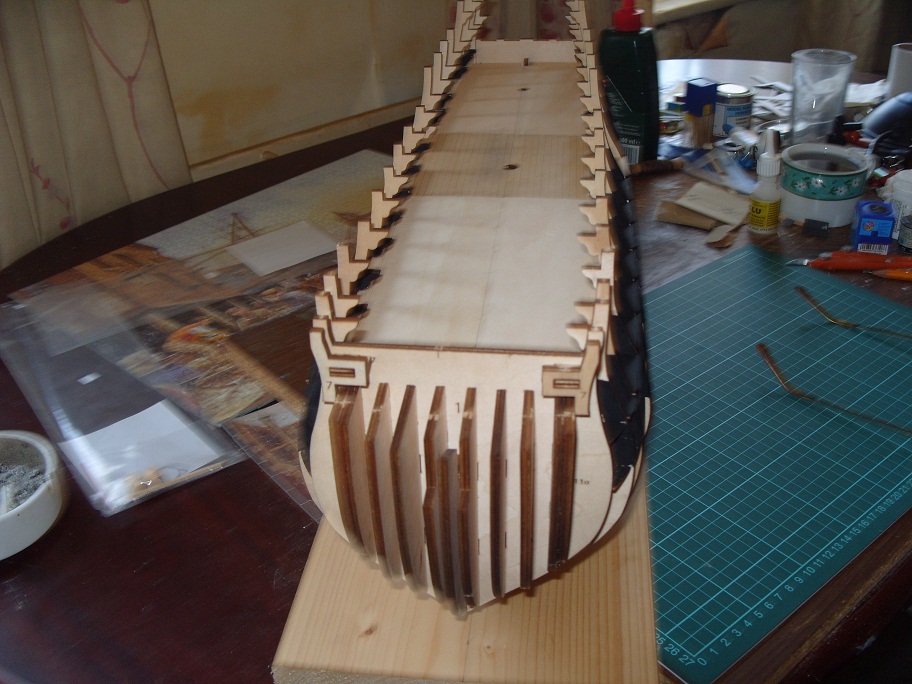

Some more pictures of my build. This is the completion of the lower gun deck including the deck beam supports that somebody suggested. (Apologies to whoever it was, I can't find your postBlushing ), but it was a brilliant idea. It took me about 2 and a half hours to do supports as each one was individually fitted, but it was worth it. I can now look forward to fitting the middle gun confident that the deck beams will not snap under pressure.

Just noticed that one of the support beams isn't verticalBlushing , never mind no-one is going to see it when the middle gundeck goes on.

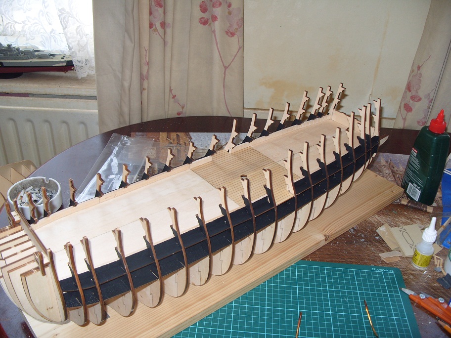

Some more photos of my build. I'll post some more with comments later today when my camera batteries have recharged.

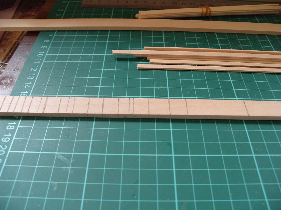

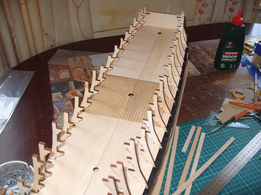

Thanks for the gee-up Karl. I appreciate it. Anyway, back to the present. More photos. I had a lot of trouble trying to fit the mid-gundeck support beams. I had to sand/file about 2mm off along most of the length. I don't know if anyone else had this problem. For what it's worth, I cut the rear supports to length first, then the two short bits,then the bow lengths. It made it a lot easier to measure the various bits.
