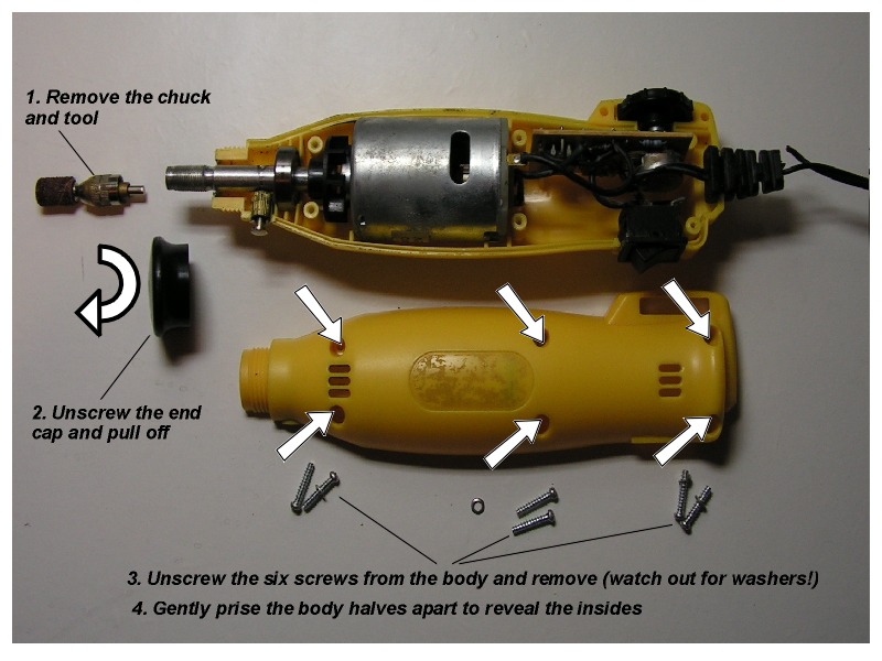

The first step (after removing the chuck and any tools from the front AND unplugging from the transformer) is to remove the outer casing of the tool to have a look at the innards. As I said, this is a cheaper ‘clone’ of the Dremel, the real thing, being far more expensive may have more bells and whistles and may be more difficult to get inside of. If anyone has a Dremel (sick or dead or you have taken it apart, please post a photo of how you get it apart on this thread for others to see!)
As far as the Rotacraft is concerned, there are six self tapping screws as indicated on the first picture, each one has a tiny washer, some come out with the screw, some stay put so be careful when you turn the body half over. Use a fairly small Phillips screwdriver to remove all six and then, instead of trying to figure out why it still won’t come apart like I did, simply unscrew the black plastic head from the front of the tool and then gently prise the left hand half of the casing off using a flat screwdriver head or similar.Blushing

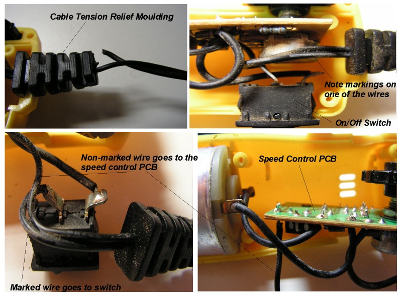

You should now have something like in the first photo. The interior is quite simple to look at, the wires come in through the rubber block with the marked one of the pair (white dashes in this case) going to the on/off switch contact and the other going to the PCB. The PCB houses the speed control circuit consisting of a rotary potentiometer (a variable resistor in other words) and a few other components. This is wired to the motor and the only other moving part is a little brass knob and spring which engages into a hole on the motor shaft to tighten and loosen the chuck.

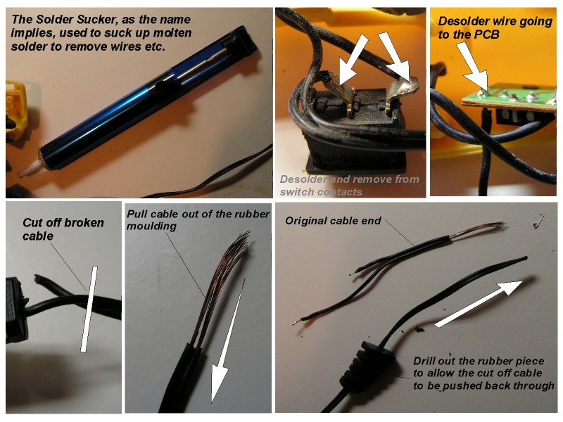

The next set of photos begins with the cause of the problem, a broken wire on the power lead just beyond the rubber strain relief. The first task is to pull the switch out from the plastic body and to de-solder and remove the two wires from the contacts. The best way to achieve this is with a useful little tool commonly known as a “Solder Sucker” or “De-Soldering Tool”. These can be obtained from any good tool supplier, the one featured here came from Maplins again. Not too expensive, expect to pay from £5 to £10 depending on the source. The suckers work just like a surgical syringe in reverse, pushing down on the black knob sets a powerful spring ( I first typed in the correct phrase for setting a spring but then thought FILTER! That word definitely won’t get through!) Blink Once ‘set’ pushing in the black button on the side of the tool releases the spring backwards and instead of injecting, the tool sucks the molten solder back up its nozzle.
So, applying the tip of the soldering iron to the switch contacts, the solder was removed and the wires pulled out of the contact holes. Note: if the wires won’t come right out once the solder is removed, just re-heat the contacts again until the remains of the solder melts and gently pull the wires free, there is usually no need to re-suck the joint. You might ask at this point why both wires were removed when only one of them was connected to the broken cable – well, you can ask!Cursing Cursing Cursing
Anyway, on to the next part! Once I’d removed the correct wire at the second attempt, the switch was free of the body and PCB and easier to work on (And that’s what I’m sticking to!)
After the switch was removed I then removed the other wire from the PCB. This one you have to be a little more careful with, applying just enough heat to melt and de-solder the joint but not so much that the copper track and pad (the circular disk that the wire or component leg is soldered to) comes away from the PCB surface. Largish pads like this one aren’t usually too much trouble, but if it’s a tiny little one for IC’s (chips) or very small components its very easy with too much heat to melt the varnish which seals the copper down and they can lift off. No problems here however and both wires came out cleanly.
The next step is to cut off the damaged cable and then to try and pull the de-soldered wires out from the rubber moulding. Sometimes, the wires are simply passed through the rubber block and they will come out complete with their insulation but in most cases as here, the rubber block is formed over the wires, effectively welding it to the PVC sheath. In that case you will end up with the situation as seen below, the wires will pull out, but the insulation was left inside the block. This is no problem however, simply hold the rubber block in a suitable vice (horizontally is best) and use a succession of drill bits in a hand drill to drill a hole through the block where the cable used to be until the previously cut cable end will ‘just’ pass back though the block as seen in the next photo. Pull the cable through until you have approximately the same length sticking out the inside end as the original cable had, this makes fitting it all back into the body a little easier when it all goes back together at the end.
Unfortunately, I didn’t take any pictures of the re-assembly as I needed both hands to do the work! Flapper But its essentially just a reversal of the stripping down procedure. The new ends of the wires were stripped of their insulation (the one going to the switch being shorter than the one to the PCB as before) and both wires were soldered back in place. The second wire from the PCB to the other switch contact (YES, THAT one!) was also replaced (By the way, if you do possess a digital camera I would highly recommend taking a series of photos as you go, when re-assembling, I just couldn’t remember if that second wire went into the contact from front or back, in this case it probably wouldn’t matter either way but sometimes wiring routes are very tight for space, a quick check back on the camera and there it was – simples!)
With all wires back in position and soldered on, the two halves of the case went back together, the black plastic nose cap was screwed on and the six screws went back in (noting which ones still had their washers on!)
