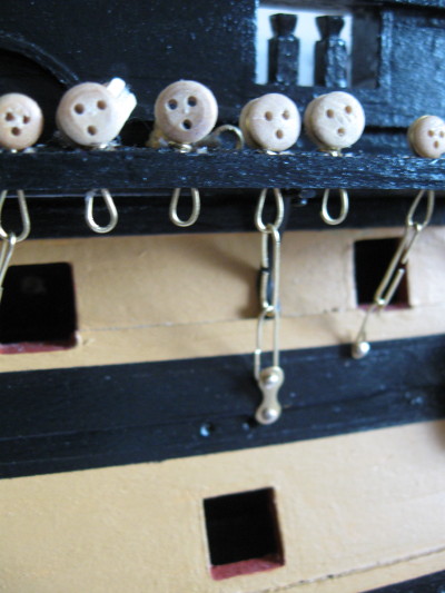

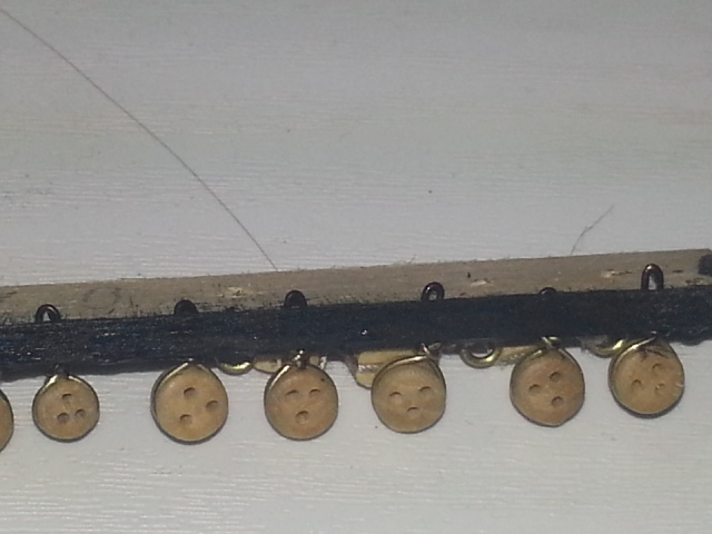

Ive got them together ok but does anything go through the loop as there isn't much sticking out on most of them
cal attached the following image(s):

Have a look at the official build for 87/87
cal
#5 Posted : 14 November 2013 15:54:08
Joined: 24/01/2011
Posts: 206
Points: 614
Location: halifax
B$%£&KSCursing looks like im redoing the wire on the dead eyes thanks tomick glad ive noticed it now not later on only one set to redoMellow
