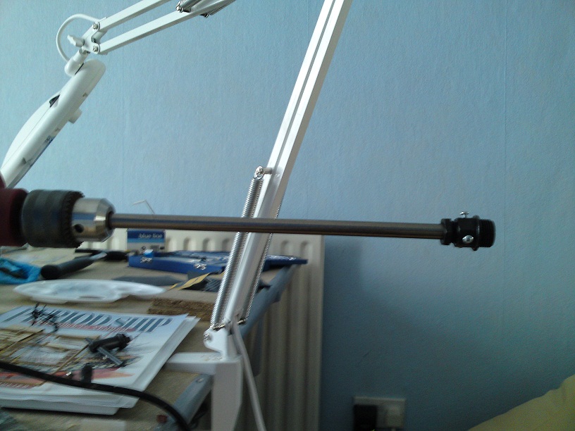

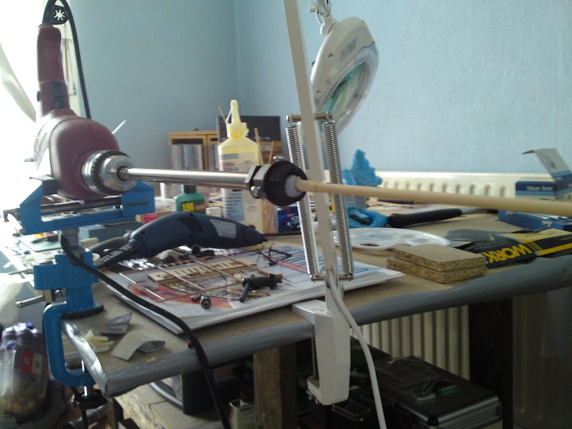

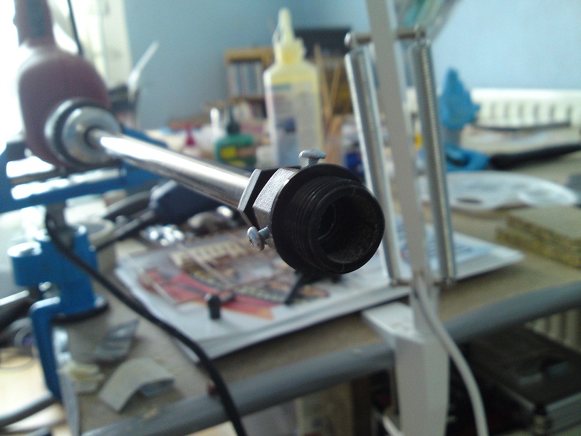

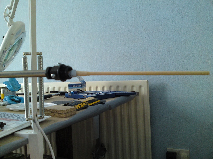

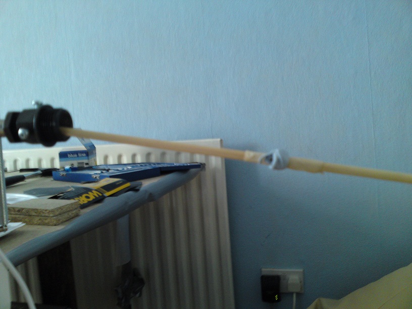

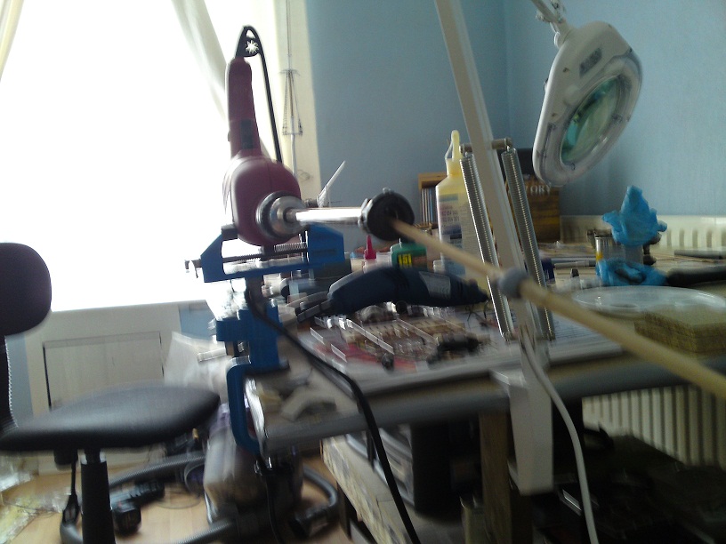

Mike, i use an attachment for the drill which holds the dowel in the centre so you can sand one side then turn it around, so no clamping the side already sanded. Must admit i did not make this but i did draw it and someone i know made it. Its just a hollow tube that will fit into a dremel or drill. The 3 screws holding the dowel do not have to be tight so as long as you put tape around dowel centre they dont leave a mark.
andylangtree attached the following image(s):
