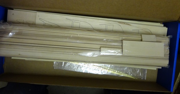

#9 Posted : 16 October 2013 17:42:42

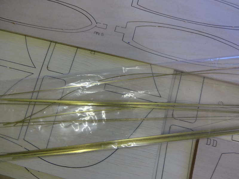

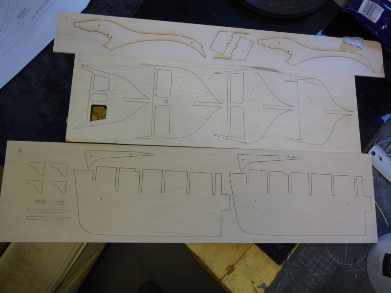

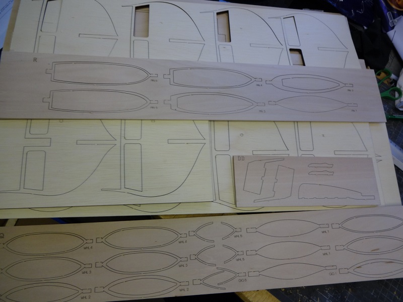

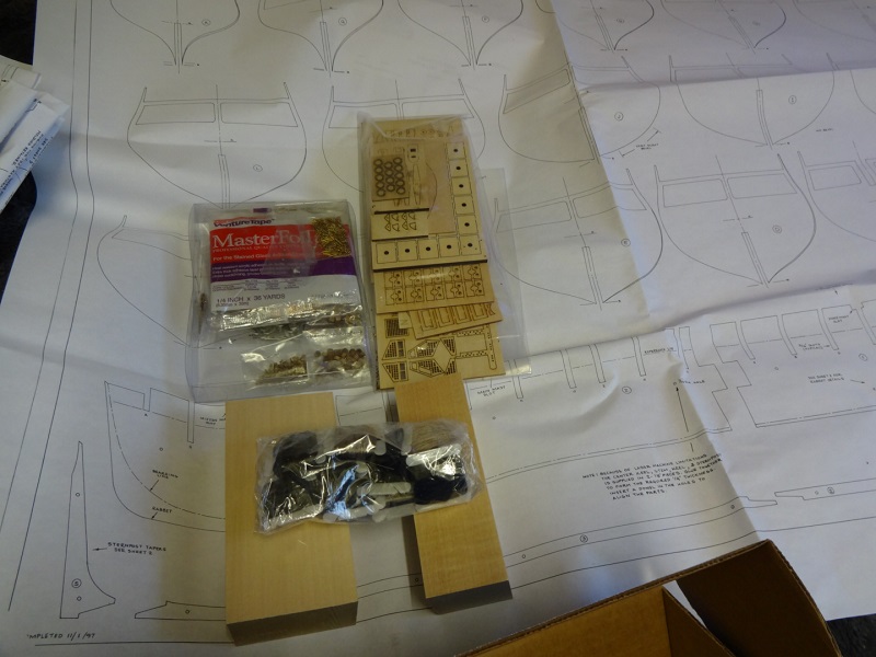

it has arrived at last,postie delivered this morning,having got a new camera for the I-pad/phone,it took the wife an hour to get it working,it is a sony dsc-qx10 http://www.amazon.co.uk/...=i%3Aaps%2Ck%3Adsc-qx10
need to get a tripod,so here are the first pics using hand held with flourescent overhead tube 5 foot.(white).

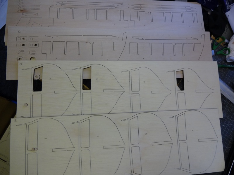

#10 Posted : 16 October 2013 17:47:53
the blocks are for the bow/stern infills.I'll have to buy balsa.

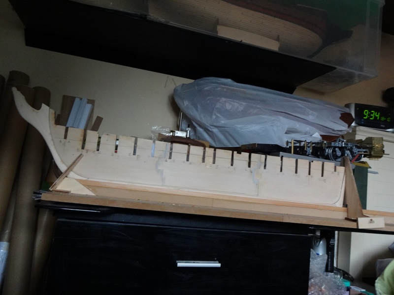

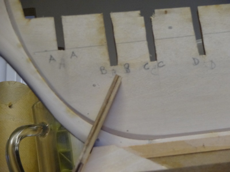

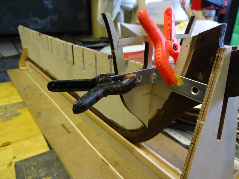

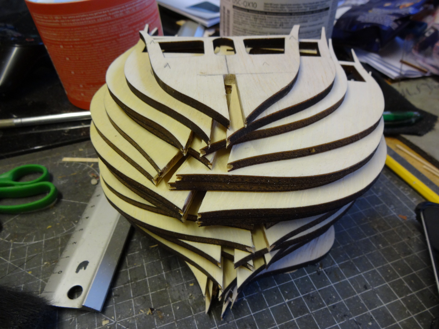

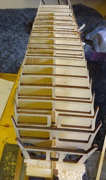

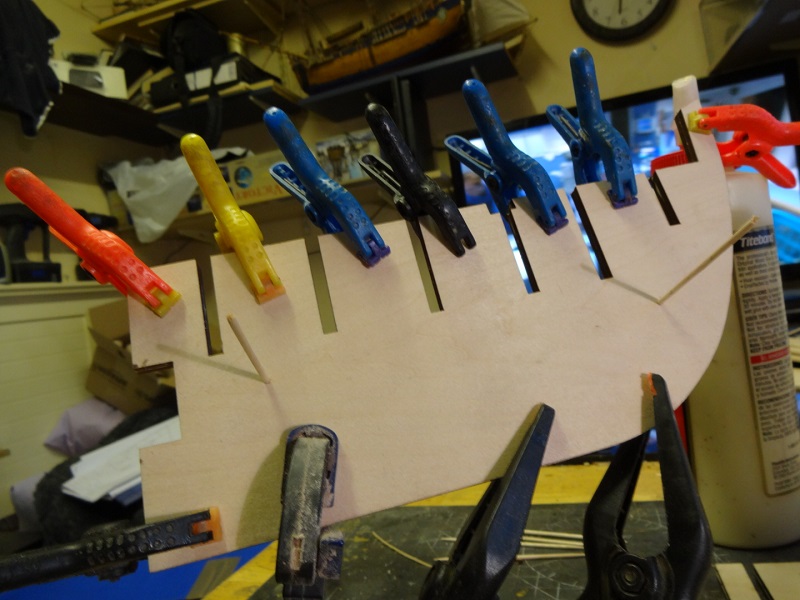

having studied the instructions and plans for two days,I've finaly made a start.this ship is not for the faint hearted,as the options given are for a scratch build.you choose which way you want to go,a bundle of wood is supplied and they say that should be enough. the plans are devoid on details on the gun deck,but suggest you look at pics and make up your own mind.I am going to go the way that is closest to the real thing.
the first job is to prepare the keel pieces for the rebate that goes all the way around the edge of the keel.and then the bearding line was sanded.every former and it's corresponding slot on the keel was filed out,owing to the fact that the keel is doubled up with 2 pieces of 3mm. ply stuck together, with dowel holes running along it's length.
