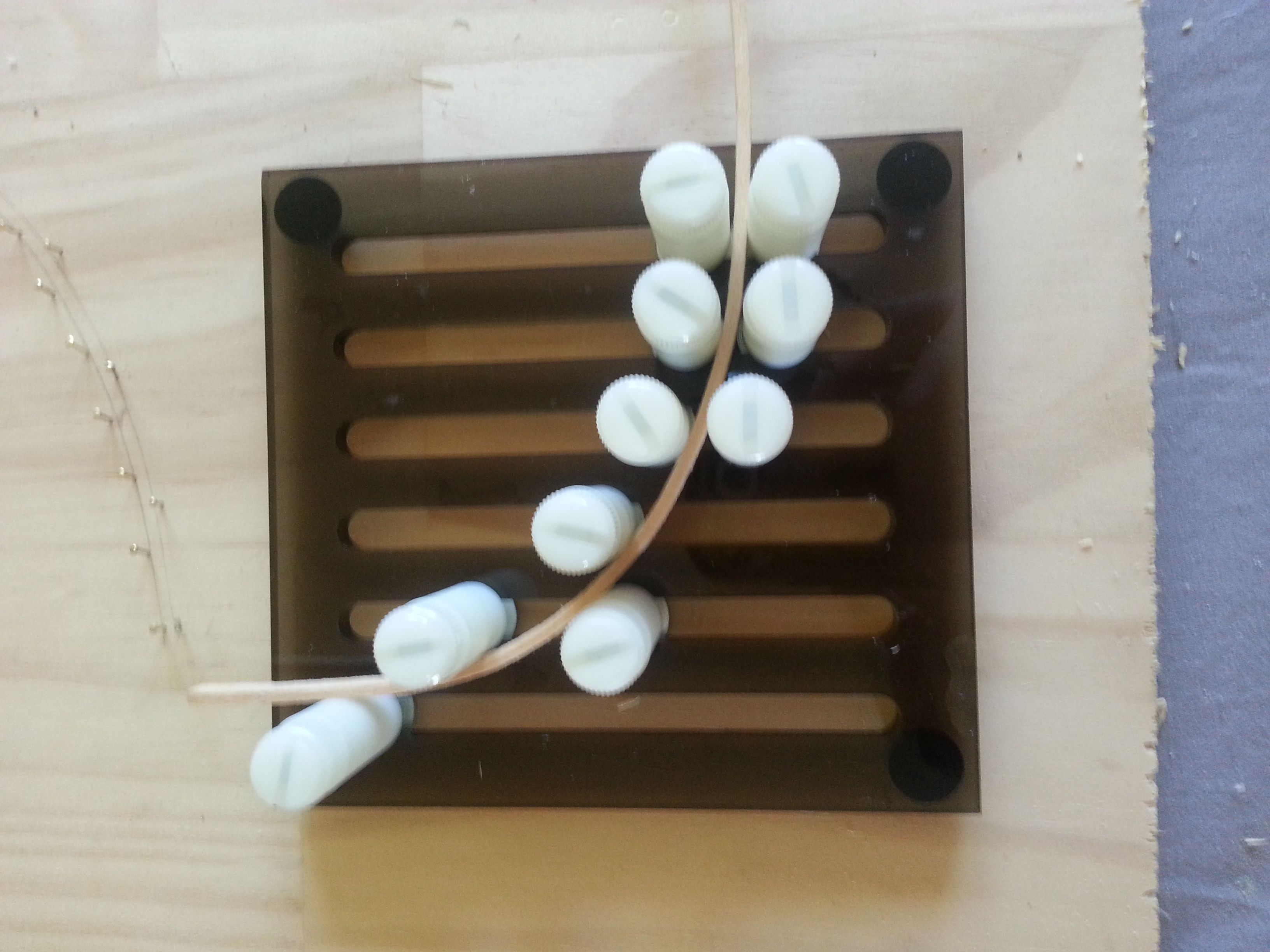

Just my thoughts and experience...
If you are going to use the supplied plankbender, the best thing I have read to do, is to pull the blade out and turn it round so that you now have a thin flat blade rather than a pointed one. Much easier to use and far less breaks. ;-)
My favorite tool by far ( to date ) is my trusty plank bending jig. Fully adjustable and can bend up to 5 planks at a time. Simply soak the planks for 30 mins and slowly bend them into shape round the jig. Leave to dry completely and bingo. A few tweeks with the supplied plankbender here and there and Bobs your uncle ;-)

Hi Sean,
Did you make the jig yourself?
Looks very useful.
Wilfy

Wilfy the Sea Dog wrote:
Hi Sean,
Looks very useful.
Wilfy
Hi Wilfy,
No, I got it from Hobbytools....
http://www.hobbytools.com.au/plank-forming-jig/
Sean
