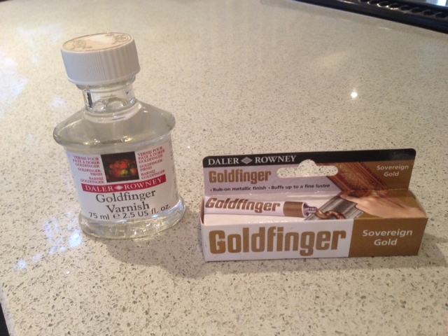

Deepest apologies Andy,the stuff I bought is 'goldfinger'which is the same idea as rub and buff.Been on the hunt for it as you were struggling to find the sealer.The sealer is goldfinger varnish.Both are made by a company called Daley Rowney.Will post a pic
Kind Regards Nigel
NMBROOK
#15 Posted : 15 September 2013 20:06:57
Pic as promised

Thanks Nigel, I might try that too. It's a fair bit more expensive than the Rub n'Buff, but that's often a good sign.
The information I could find on Rub n'Buff seemed to indicate that after several days it went very hard and was tough enough to stand wear. But, there was some mention of it changing colour as it aged and to stop this a sealer was required, but no one could agree on what to use.
