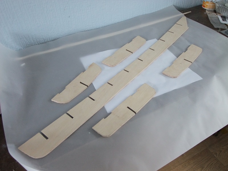

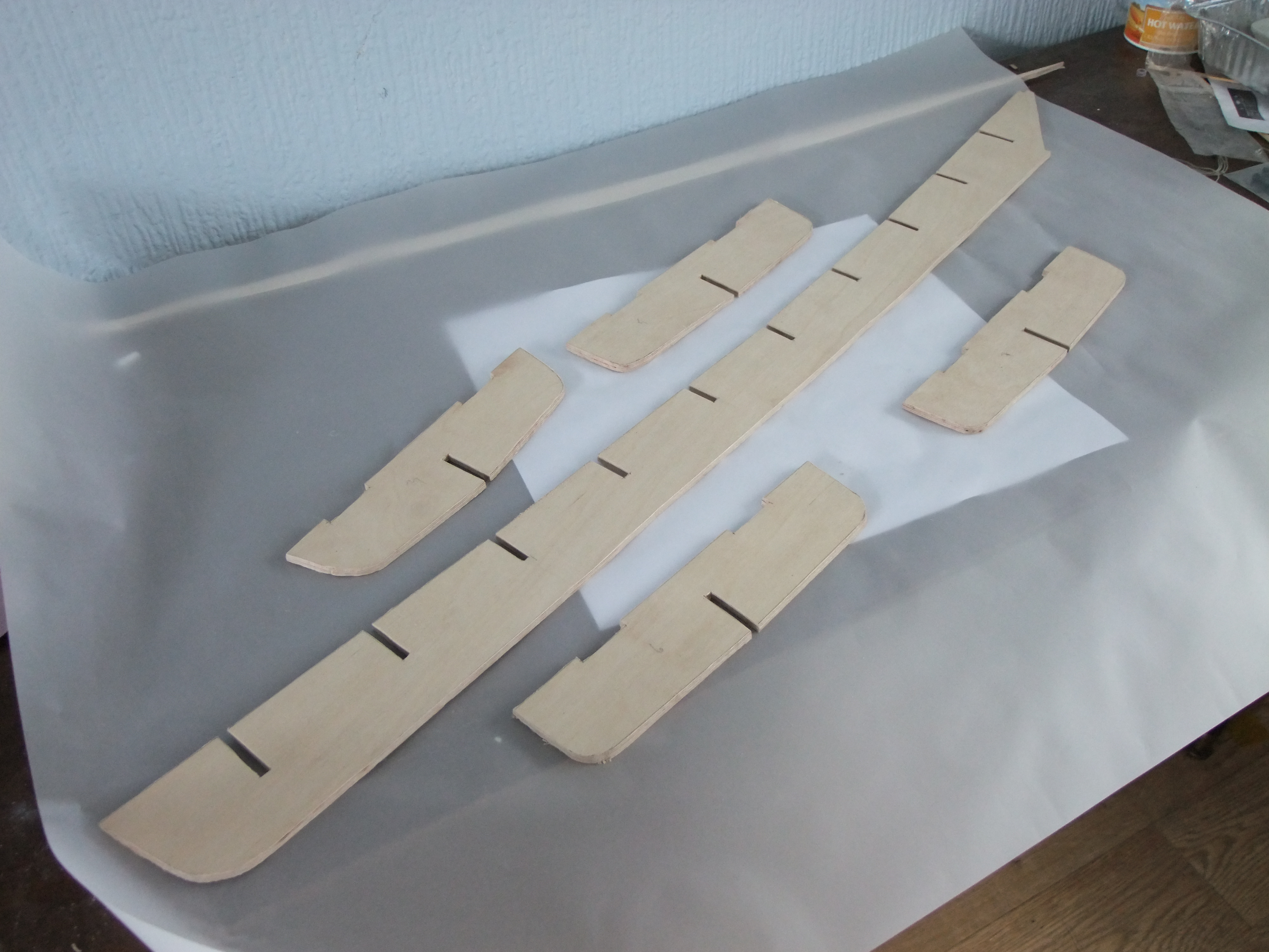

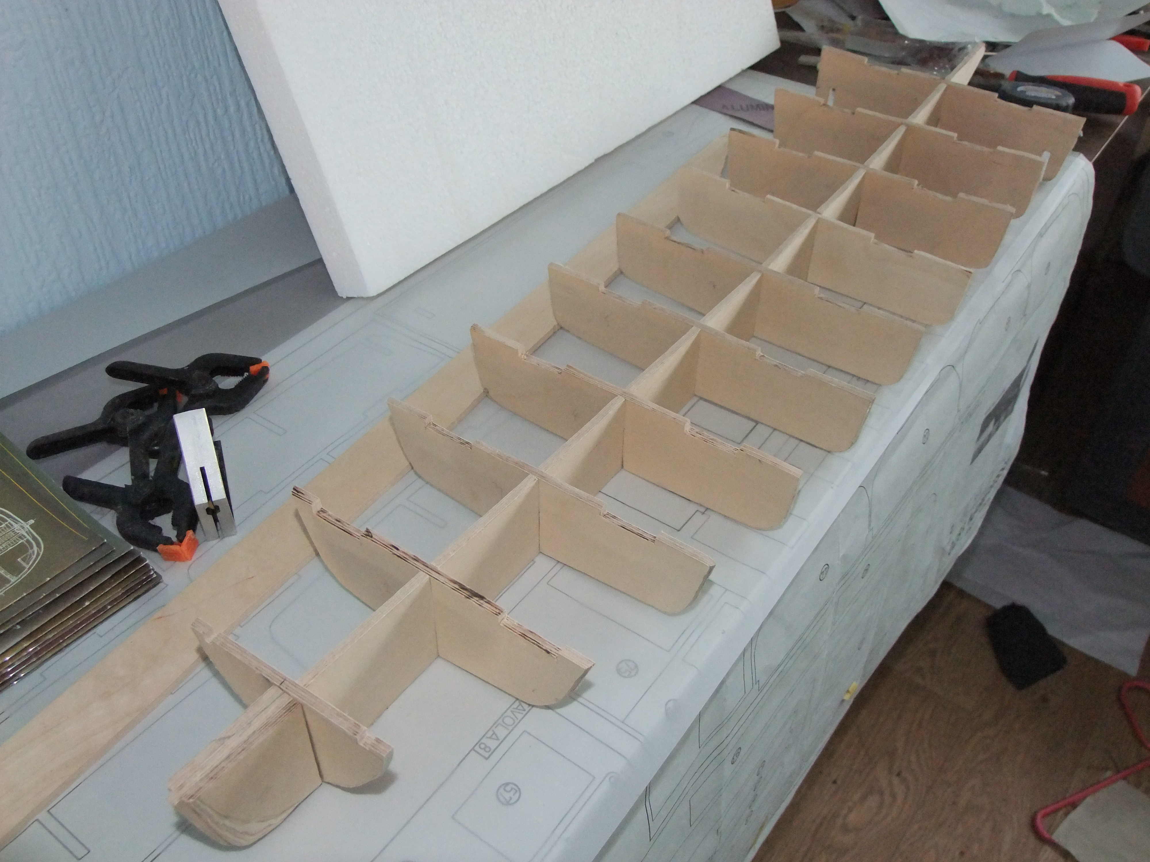

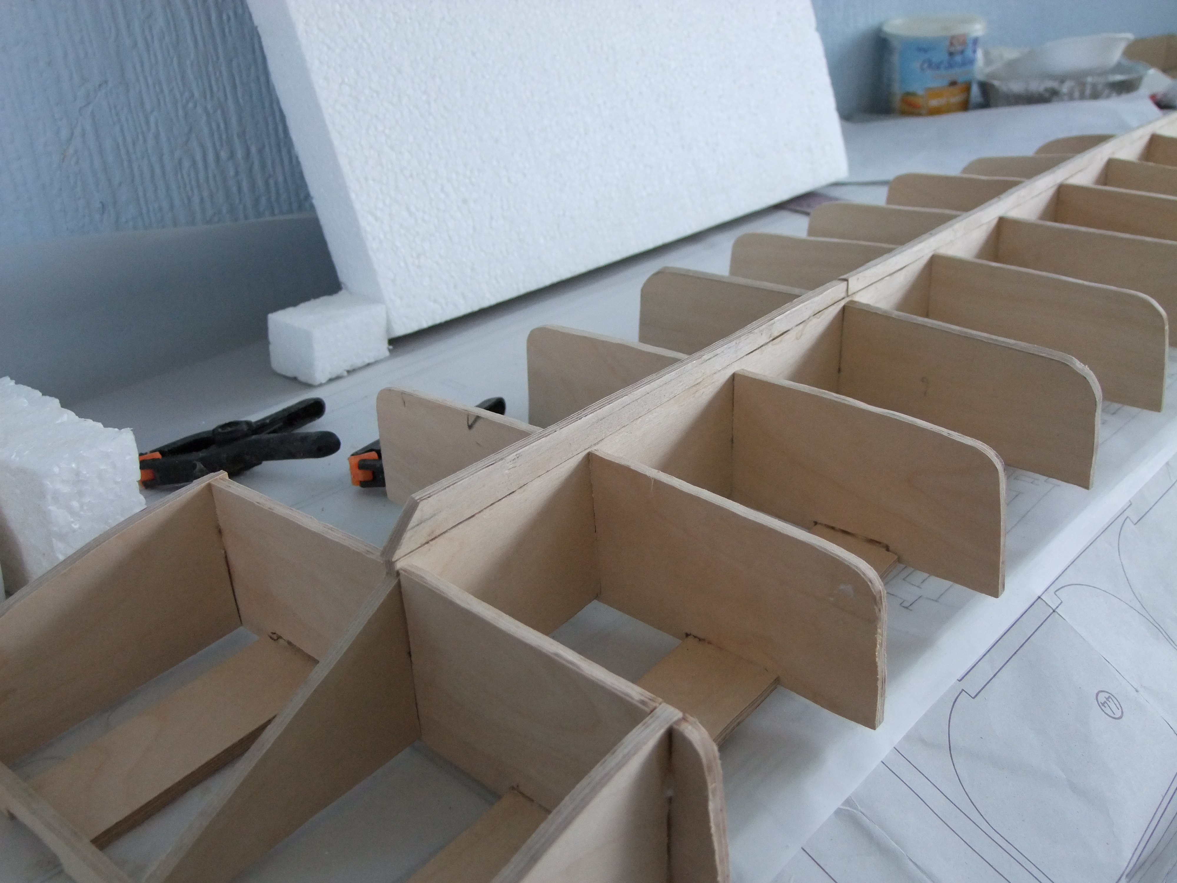

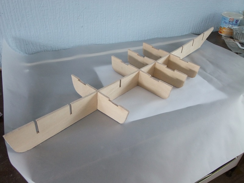

Hello all, Some progress has been made, I have cut out the keel and some frames. I ruined two frames,with over enthusiasm with the fret saw, I have attached a couple of photos to show progress. One tip to anyone contemplating a scratch build, buy a power fret saw. That and my trusty motor tool are a god send. My wood supplier is out of stock of some of the wood I need, but has the 5mm ply so I can finish the frames, (6 to make). I have found what could be a very good engine to model, I need to work out the valve gear though.

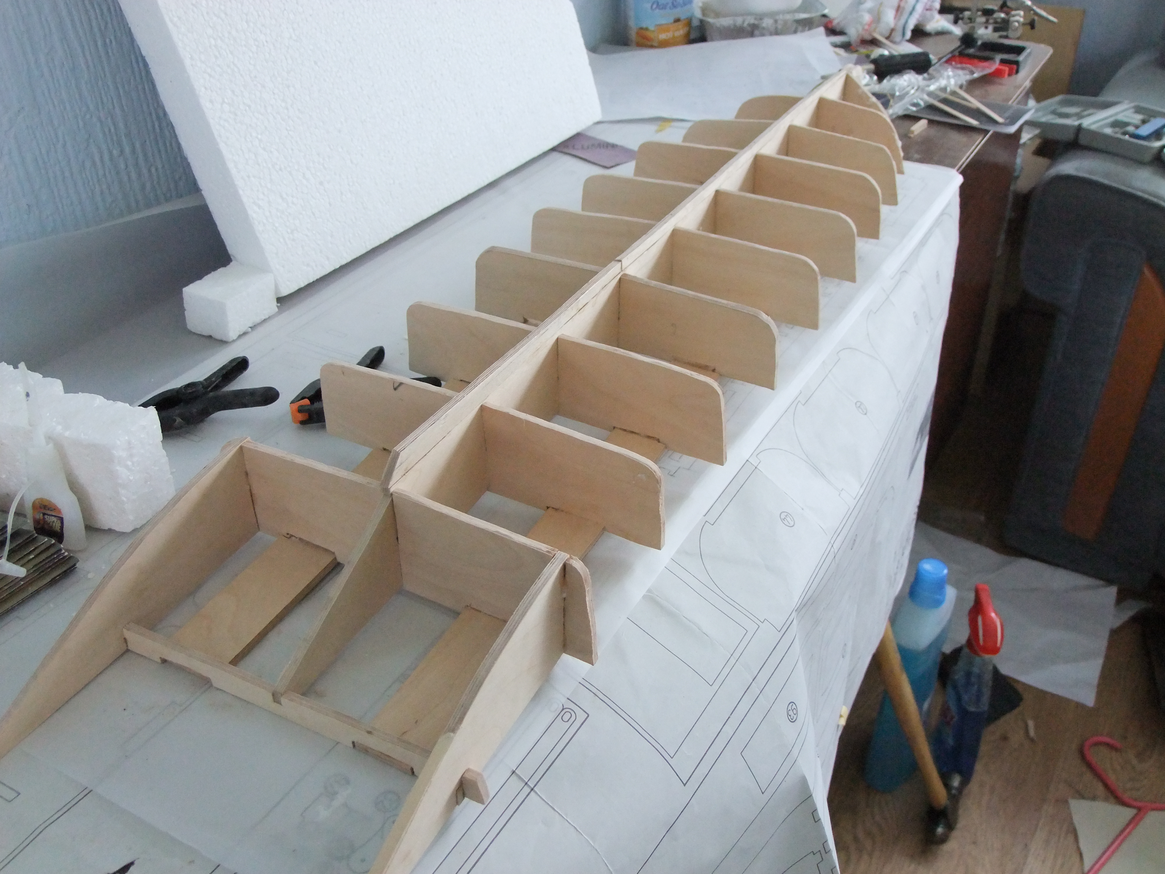

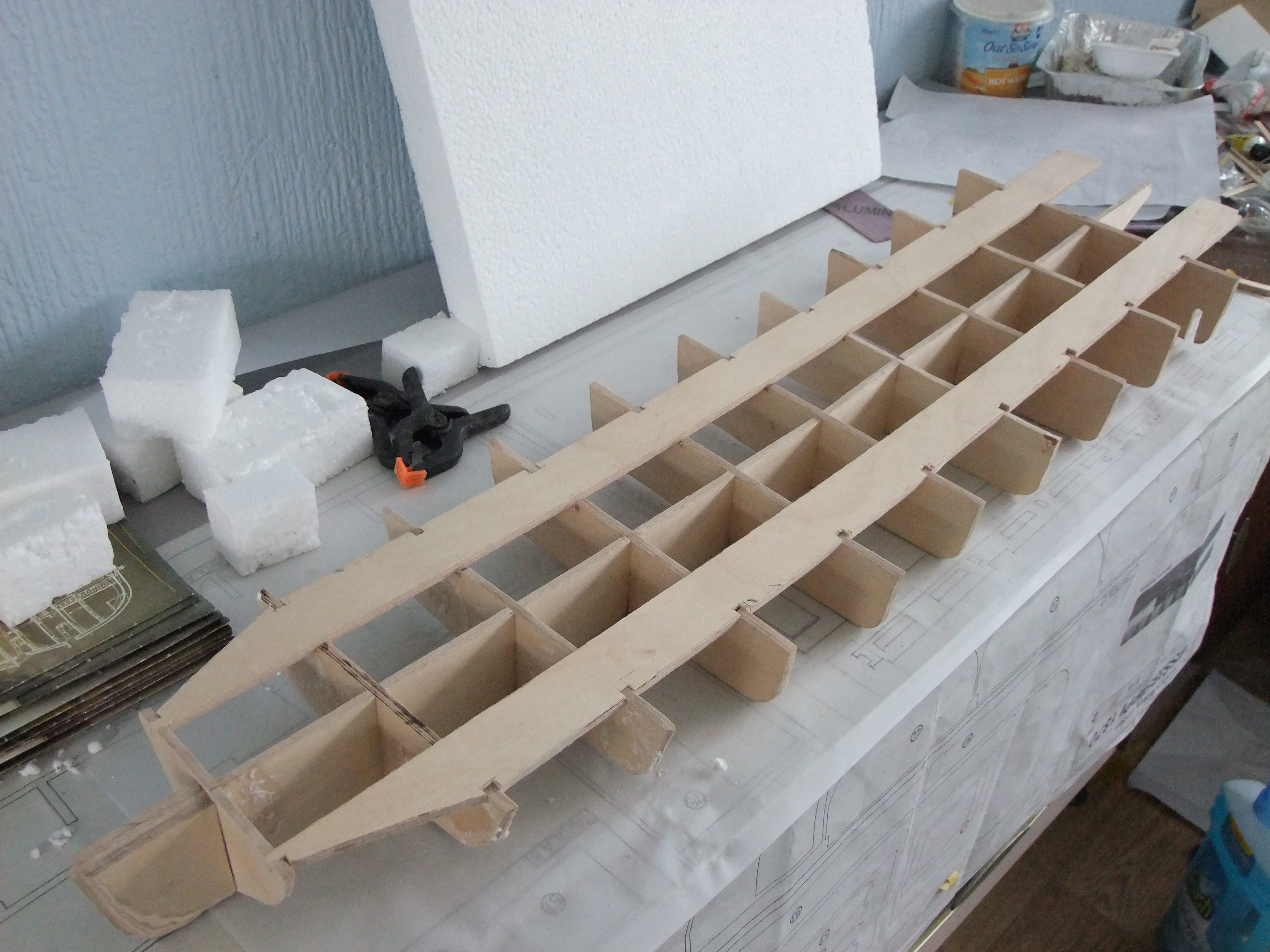

Progress has been made, and providing I can make Karl's instructions work, with photos too. The rest of the frames have been made and fitted, plus the two longitudinal reinforcements. The supports for the paddle wheel have been fitted, these will be planked as a continuation of the main hull. The keel has been made and installed. I am now awaiting delivery of a block of balsa, to fill in the first three frames. There are some possibly awkward curves between frames one and two. I wish I had thought of balsa, when I did Victory's bow. I faffed around with templates, and I am still not sure I got it dead right. My outstanding order of wood strip should arrive later next week, so I may be able to make a start on planking the hull.

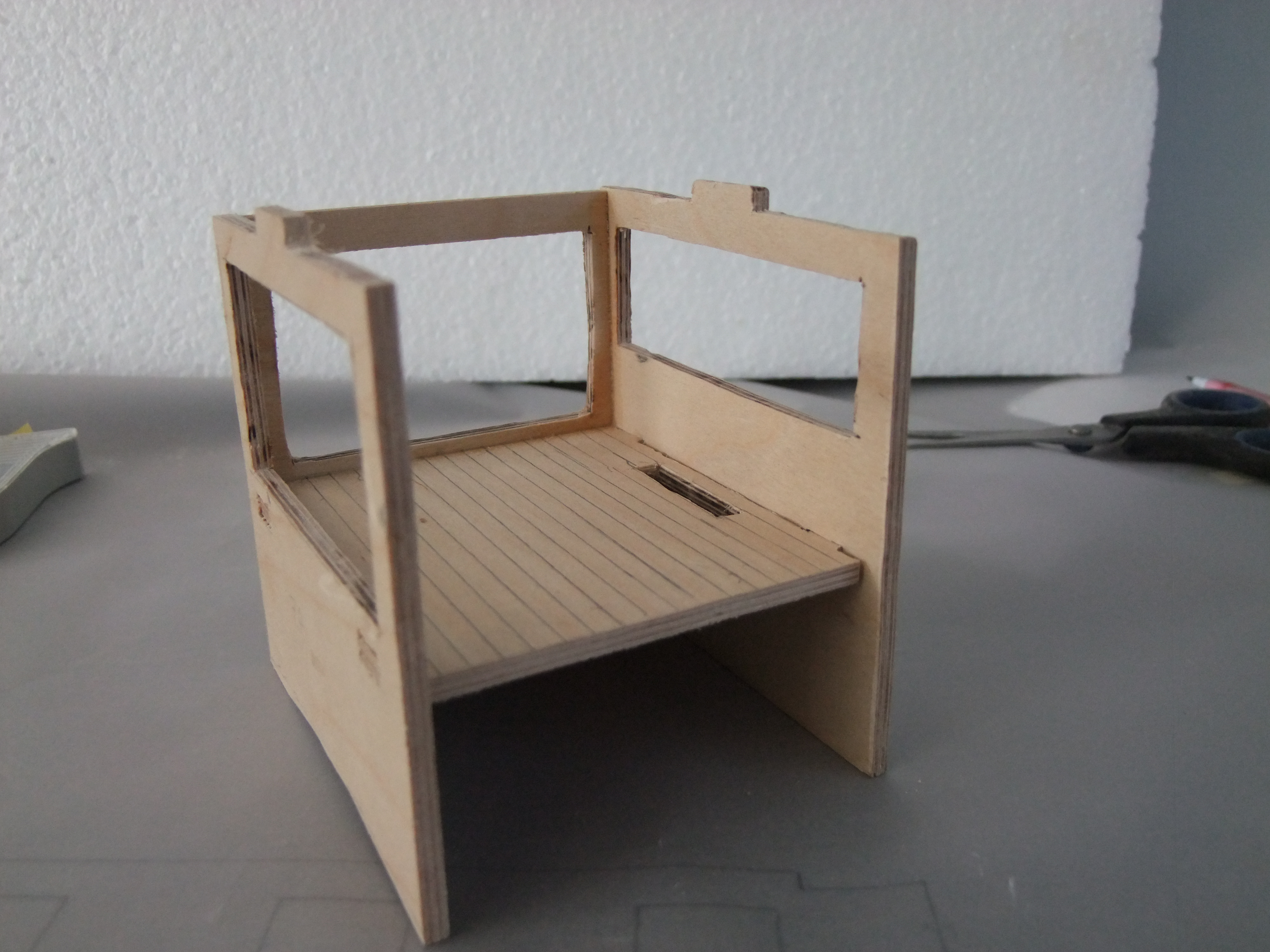

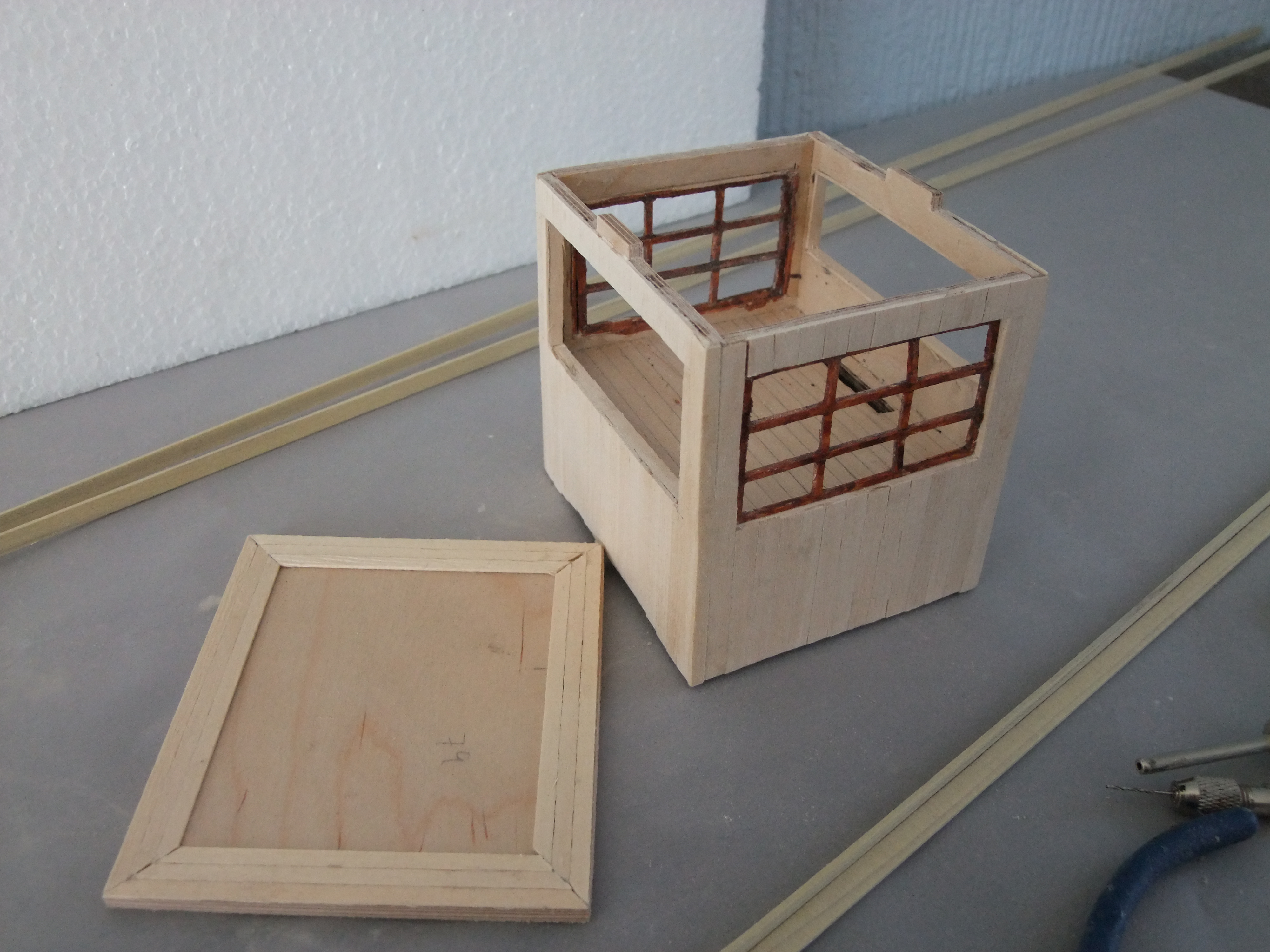

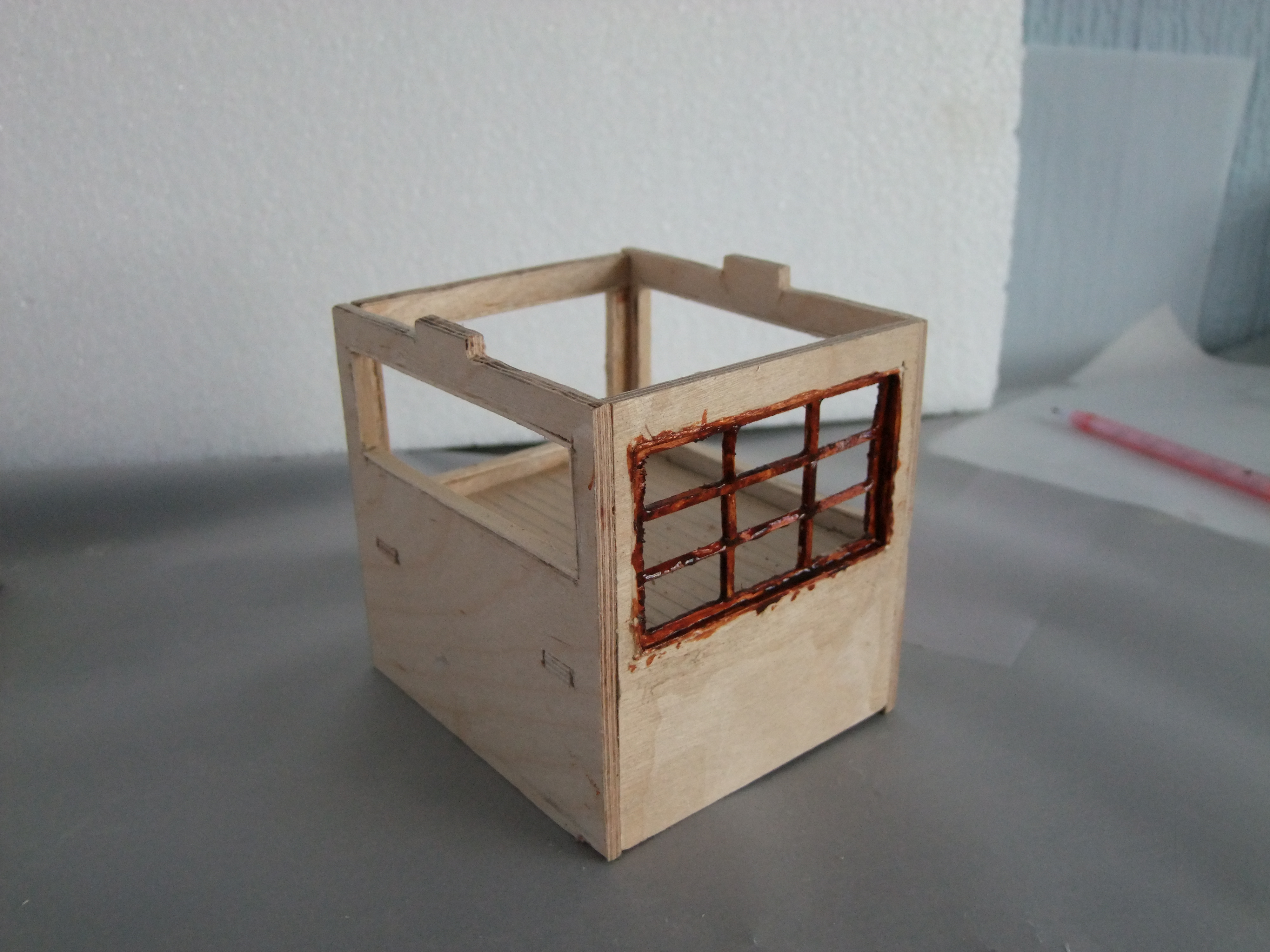

Not a great deal to report, I have made a start on the pilot house (wheelhouse), while waiting for the strip wood for planking the hull. That arrived yesterday, so hopefully I will be able to post some photos of the hull being planked tomorrow. In the meantime, acouple of photos of the pilot house.

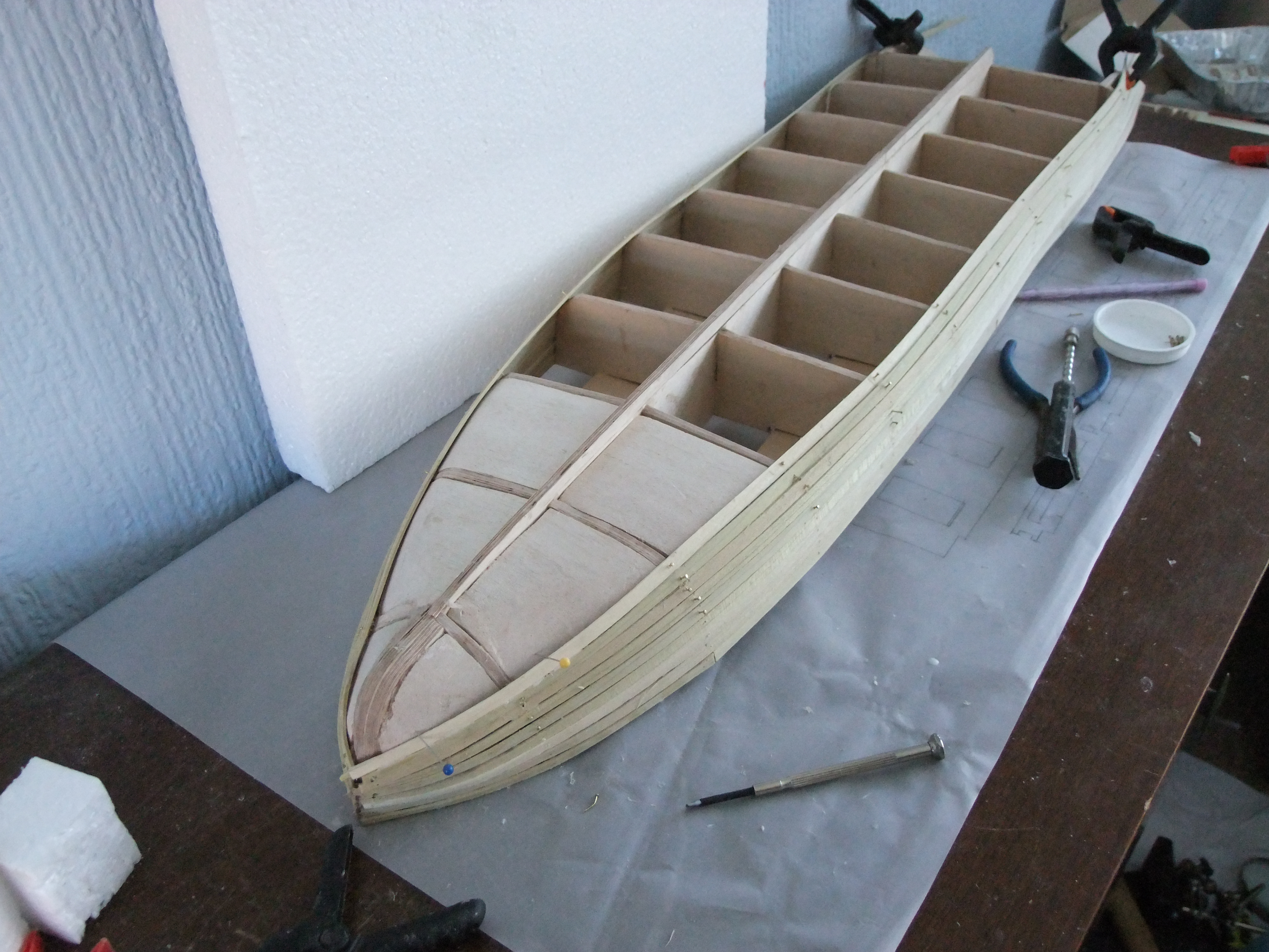

Further progress has been made, nine rows of planking fitted to the hull. The next planks are fitted starting 40 mm from the keel, this is to get the required shape of the bow. A second window has been fitted to the pilot house and the exterior planked. A start has been made on the roof, I have to make the formers for the roof dome first. I will now try again to properly upload photos.
