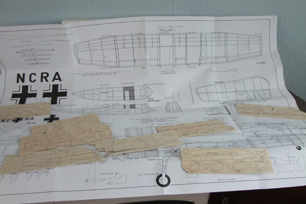

Hi Andy,
My BV141 plans and parts arrived today, bit annoyed that HMRC nailed me for £6.09 VAT, this on a $31.50 cost??? The laser cut parts are balsa, I am thinking, maybe a coat of varnish to strengthen them once separated from the sheet (other ideas welcome). All being well, I will post a photo or two here over the weekend.

BigGrin Hi Tony
interesting, maybe a coat of laminating epoxy using 1oz nylon would impar more strength or you could recast the parts in resin/plastic using the wooden parts as mould masters just some thoughts

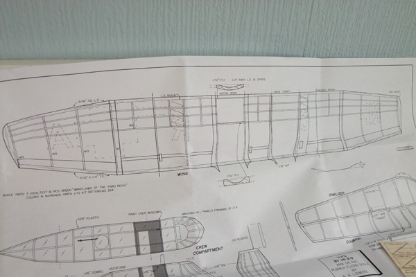

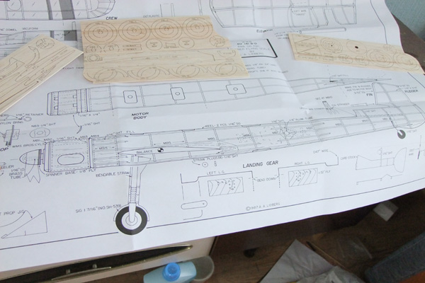

Hello all,
Here are a couple of pics of the BV141 kit.

hi tony,another way of strengthening the formers is to dope on tissue paper,not as strong as nylon but lighter,also stop wood splitting when cutting out.interesting subject though.are you intending to fly? r/c? or co2 and finally rubber powered?

Hello Karl,
I don't intend to build it as a flying model, the plan is for a rubber powered model. My intention is to skin it with 0.3mm or 0.5mm strip, and dope tissue paper over that to hide any obvious joins in the wood; then paint over that. The landing gear will be more robust than the bent wire shown on the drawing, with something resembling the hydraulic retraction kit. I hope to make something that looks like a 9 cylinder radial to stick under the cowling.
