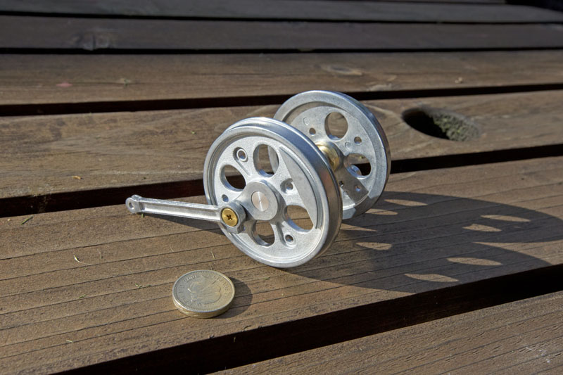

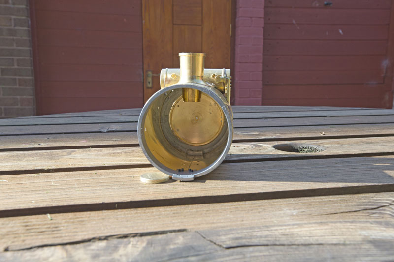

Hi Everyone,
Somewhat a little late I have just started a D51 subscription. My interest in model steam and a friend noticing the D51 offer when viewing CB750 build had me signing up.
So far I only have parts 01 - 04.
So most of you will have long moved on. I am perhaps building the kit slightly different since were possible I will solder. The extensive use of brass makes this method quite easy and there is always something more substantial about soldering compared to epoxy or superglue. Some parts will still be fixed using slow epoxy these being the cast alloy to other parts.
My interest in steam models is mainly 'O' gauge brass which are also in the main soldered together.
I hope my first build will be of interest.
Dennis

#2 Posted : 22 August 2013 11:51:48
Welcome to the forum and look forward to seeing your progress. Cool
Be mindful that some of the components are Zamac, which will need a good quality acid flux.
Dennis
#3 Posted : 22 August 2013 12:04:52
Joined: 08/08/2013
Posts: 184
Points: 567
Location: Runcorn
Hi Tomick,
Are you indicating that some parts that appear to be brass are not? Or are you referring to the cast alloy parts such as the boiler joining rings? I will still use epoxy on the alloy parts.
Dennis
#4 Posted : 22 August 2013 12:23:16
The majority of what you see as brass is mainly brass and some of it for manufacture reasons is brass plated.
Such as the backhead, is plain diecast metal as per the wheels.
Dennis

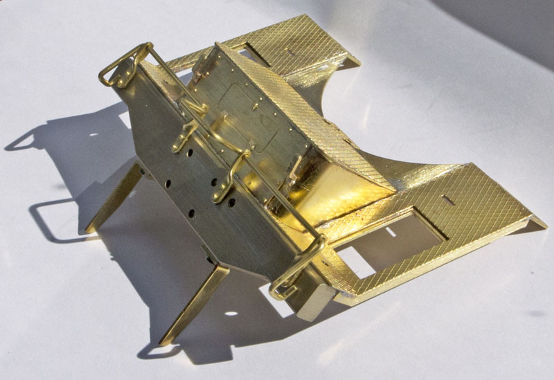

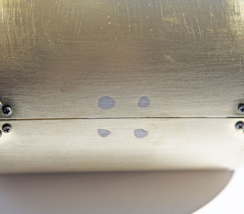

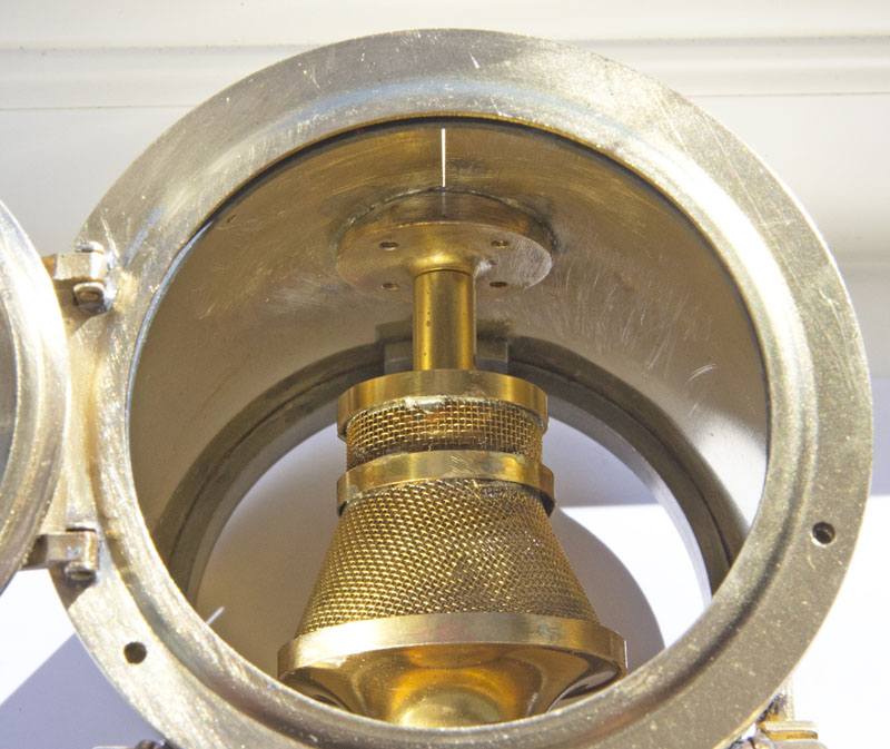

Hi Everyone,

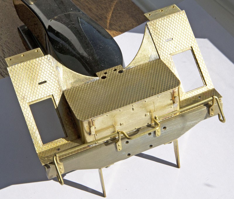

Just received and built parts 02 (05 - 08). As per first entry still soldering most parts. The spark arrestor assembly was excellent being all brass even the gauze parts were already soldered each end no doubt to stop fraying. All these soldered well however I had to be careful and have the blast pipe in place. Although this was initially screwed I soldered this as well.
The front deck was mainly brass and soldered well. The two edges were a little difficult to hold and solder but they are in place. I found the hatch upper surface was slightly too wide at the rear edge but slight filing solved this.
The release lever bar although looking like brass was alloy and probably anodised to look like brass. The bar and the associated parts were fixed in place using slow epoxy and finally the release bar was fitted in place below the front deck as per the instructions.
I am hoping to catch up set wise with the early subscribers if that is possible.
Dennis
