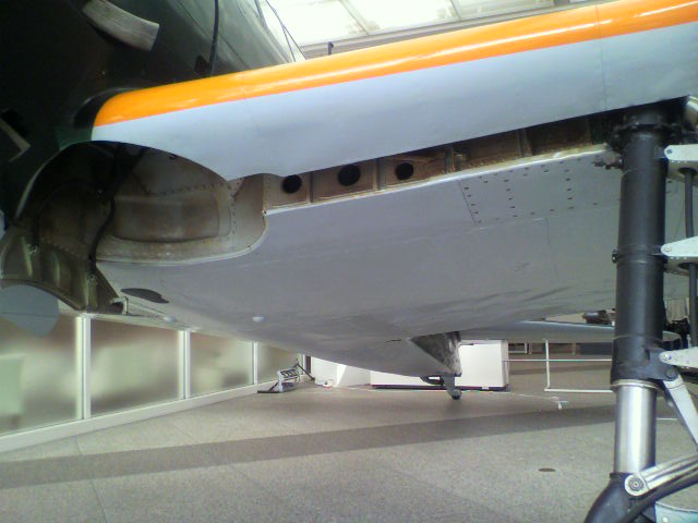

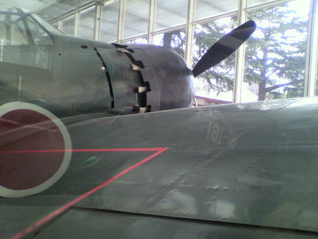

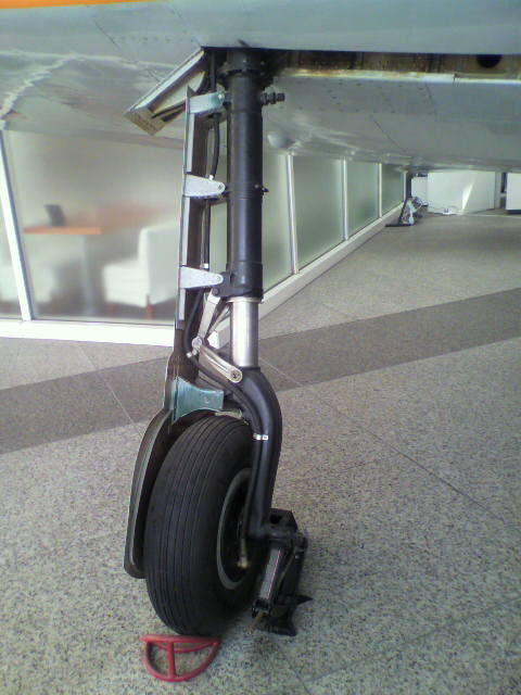

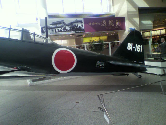

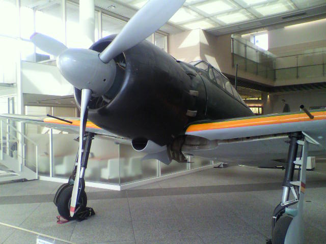

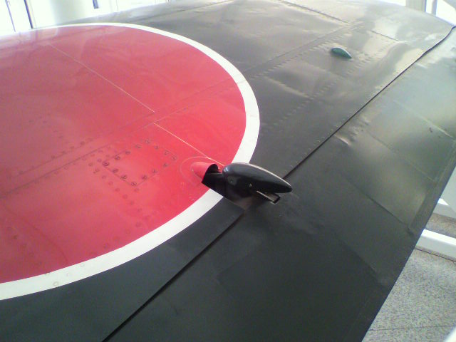

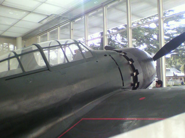

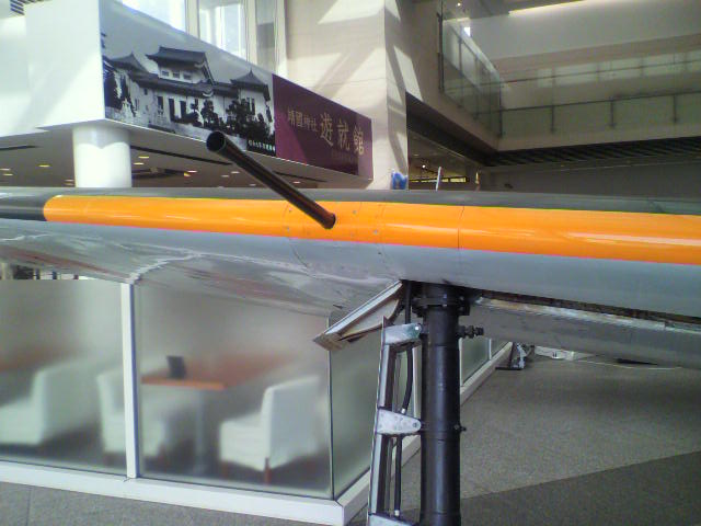

Hi Zero builders!
I attached several pictures of a restored zero Model 52 displaied in Yusyukan(遊就
館).
http://en.wikipedia.org/wiki/Y%C5%ABsh%C5%ABkan
The place displays articles left by the fallen soldiers' in order to
comfort the soul of the enshrined fallen soldiers in Yasukuni Jinja(靖国神
社) in Tokyo.
Since the articles contain the weapons, we can see them there. But we can
see not only the weapons but also fallen soldiers' cloths, tablewares,
letters and other livingwares.
Best Regards,
Yutaro

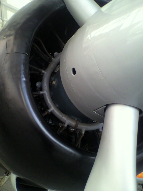

Thanks for this. It gives us a good opportunity for colour matching and one thing I noticed...
It is me, or is the engline block painted aotake?
James
dandare
#4 Posted : 21 August 2013 16:50:33
Joined: 27/06/2011
Posts: 437
Points: 1,321
Location: milton keynes
James
james, im of the same opinion, the reduction gear housing is aotake
dan
#5 Posted : 21 August 2013 23:19:58
BigGrin Hi All
Firstly thanks for posting Yaturo, secondly in my humble opinion the reduction gear housing is of a light blue colour this is more evident if you look at the front side view shot and not of the close up of the engine
#6 Posted : 22 August 2013 01:58:31
Hi All, Andy is correct it is and should be a light blue as per this build.

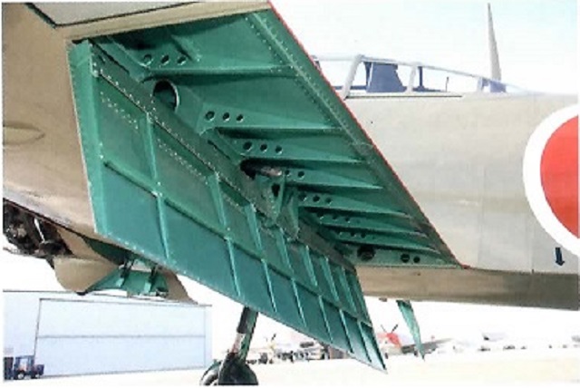

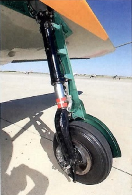

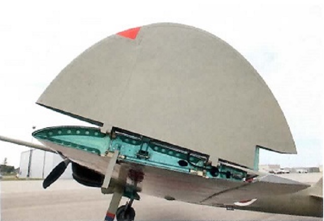

I guess some of Zero builders are interested in Aotake color. I have attached additional pictures of another restored Zero in USA. It was restored under the up-to-date evidence and can really flyBlink at this time.
I don't know what kind of paint is recommended by DeAGOSTINI UK, I usually use GIS "metallic blue green (C-57 or H-63)". It can be also used for 1/250 aircrafts on the Akagi.
Best Regards,
Yutaro
