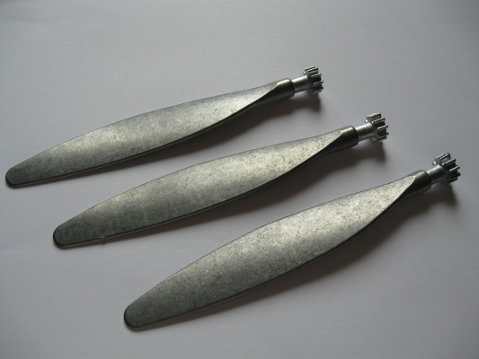

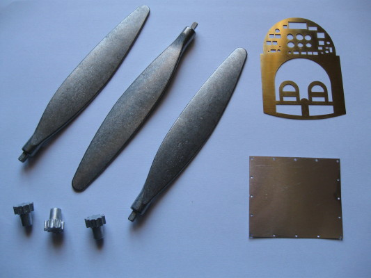

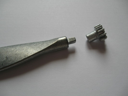

Stage 1 - Contains diecast propellor blades, gears, photo-etched brass intrument panel and an aluminium skin section.

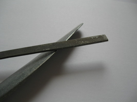

Use a fine file to smooth the casting lines from the edge of the propeller blades, then use fine emery paper to smooth any imperfections the surface of the blades.
Glue the gear onto the shaft of each propeller blade, (I used epoxy).
Later on, the propellor blades will be added into the propeller hub along with a gear ring to create the operable propeller pitch.
Thats it for this stage, carefully store the remaining parts within a numbered bag.

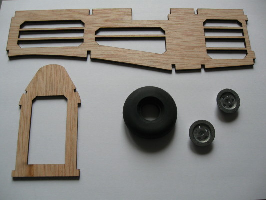

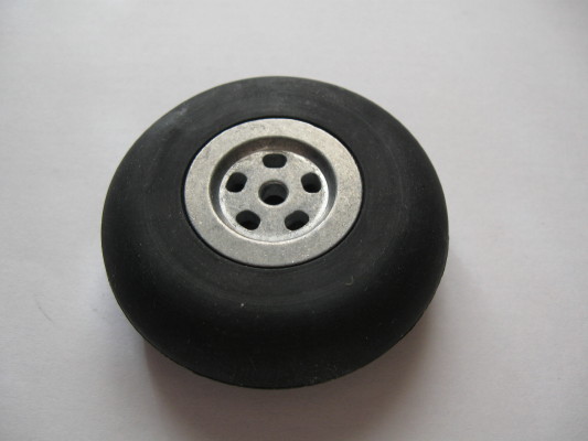

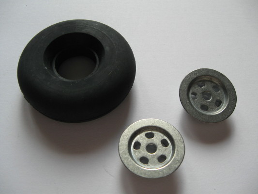

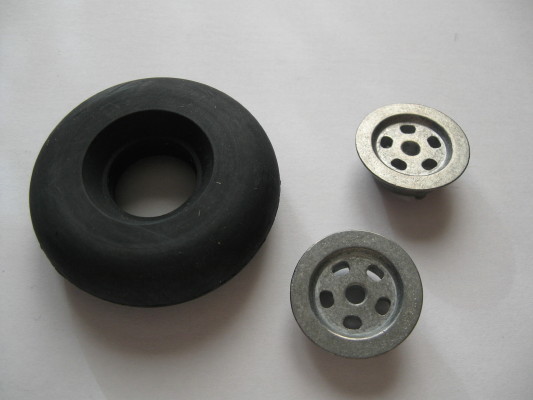

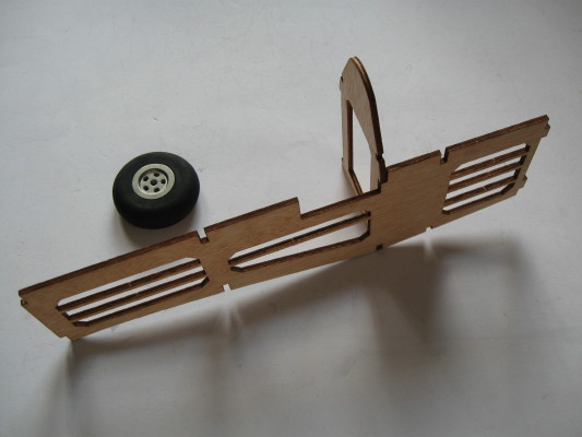

Stage 2 - Contains the left fuselage side, fuselage former, wheel rims and a tyre.

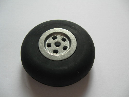

Fit one of the wheel rims into the tyre, apply glue to the seating area of the second rim, align the notches and fit the rim into the tyre, hold the rims together until the glue has set.

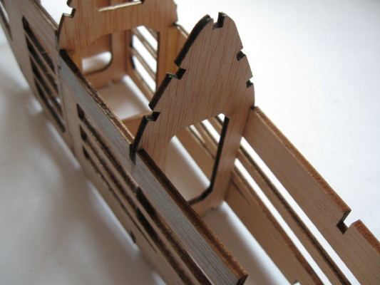

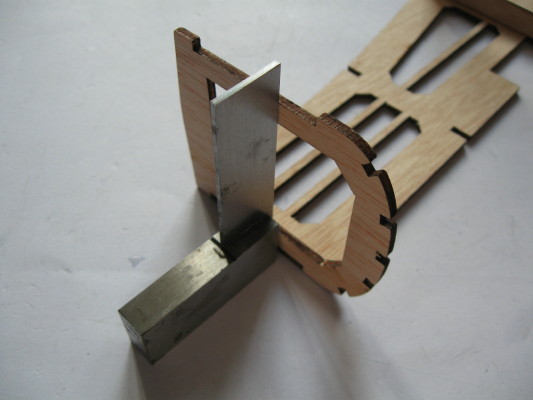

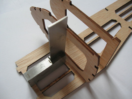

Take the left fuselage frame and the the fuselage former.
Position the frame in the orientation shown, then identify the location of where the first former will be fitted.
Apply PVA glue to the edge of the former and fit into the frame. Check that the former is set at 90 degress to the frame.
This completes this stage, store the wheel for later use.

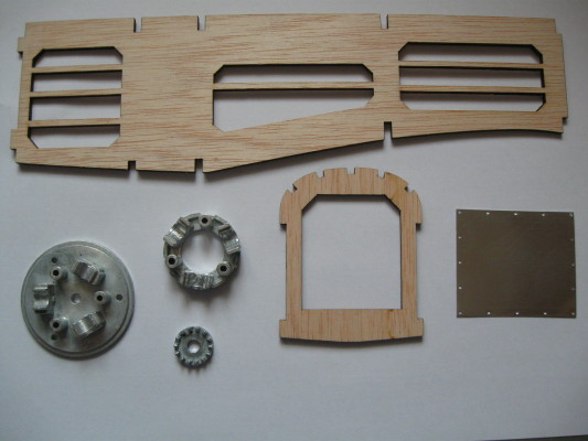

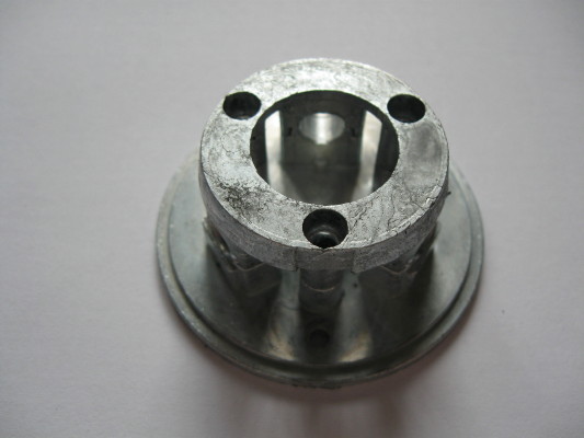

Stage 3 - Contains the right fuselage side, a fuselage former, diecast propeller crown ring, spinner back plate, propellor gear ring and an aluminium skin section.
Take the left side framework assembled at the previos stage and the fuselage former provided in this issue.
Locate the position for the former then glue it in place, ensure it is set at 90 degrees to the frame.
The right frame will be attached to the left frame in the next stage, you can test fit it, but DO Not glue it in place yet.
Take diecast the propeller unit parts, use a fine file to remove any burrs from them.
Test fit the propeller ring onto the back plate to check the fit, then set aside for later use.
This completes this stage.

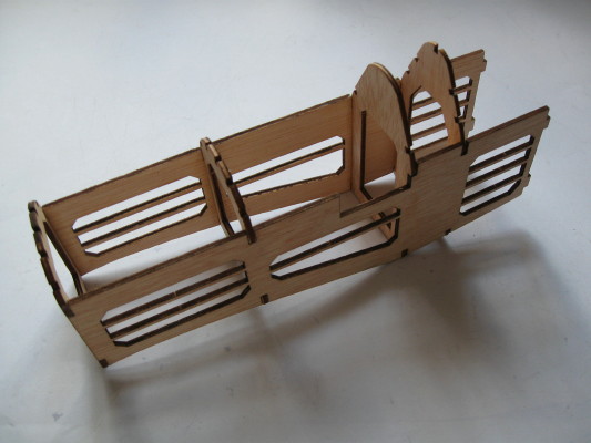

#5 Posted : 17 August 2013 09:43:49

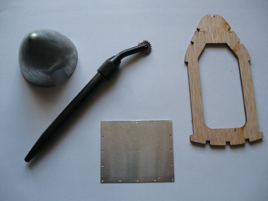

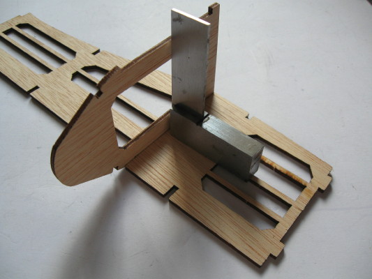

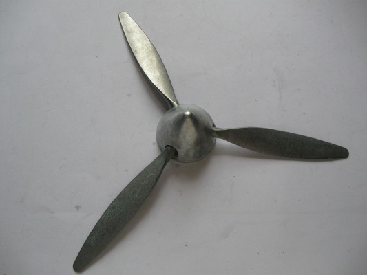

Stage 4 - Contains a rivet marking tool, propeller spinner, aluminium skin section and a fuselage former.
Take the framework previously assembled and the fuselage former provided in this issue.
Identify the location of the former on the frame work then glue the frame into position, check that it is set at 90 degrees to the frame side.
Take the right fueslage frame, apply PVA glue at the contaict points of the frame and formers, then fit the frame in place and secure with clamps while the glue sets. In the next stage you will fit the end former.
Take the propeller blades, back plate, ring and spinner (set the geared ring aside).
Fit the blades into the propellor unit, add the ring and then the spinner. This gives an idea of what the propeller unit looks like, further parts will be provided later on to secure the parts together and create the variable pitch mechanism. For now, carefully store these parts.

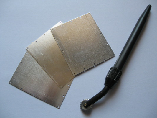

The final part of the instructions how the rivet marking tool is used to create rivet heads upon the skin panels.
At this stage DO NOT mark any of the three panels provided thus far, but store them safely for later use along with the rivet marking tool.
Panel marking information will be provided at the relevant points in the build.

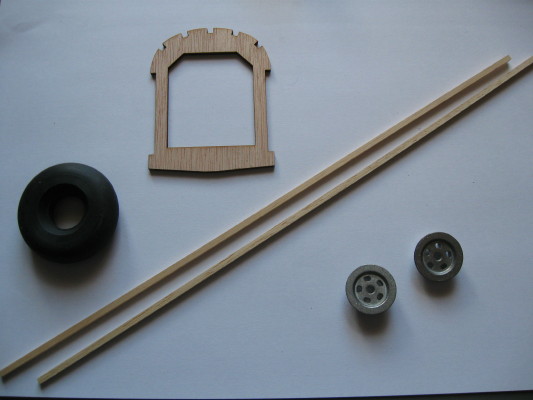

#6 Posted : 28 August 2013 11:16:03
Pack 02 contains Stages 5-8

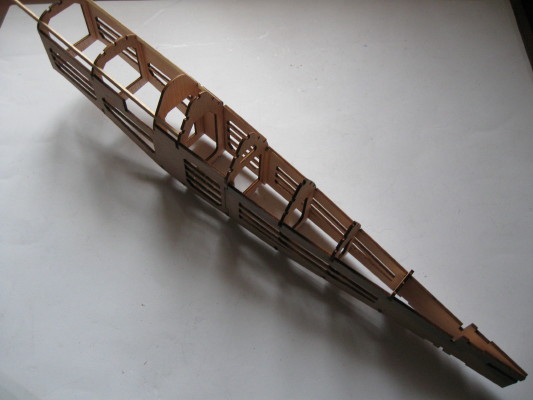

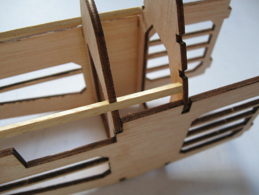

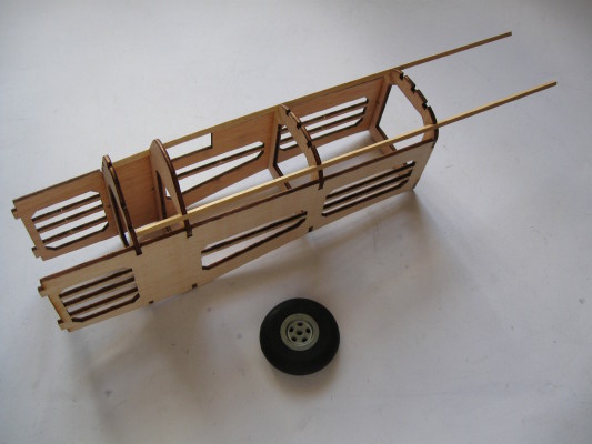

Stage 5 - Contains a tyre, wheel rims, wooden stringers and a fuselage former.
Fit and glue the former into the indicated slots of the fuselage framework, then glue the front of frame onto the end former.
Fit and glue the stringers into the indicated slots on both sides of the fuselage, they should butt up to the aftmost frame and run their full length forward.
Assemble and glue the wheel rims onto the tyre as before.

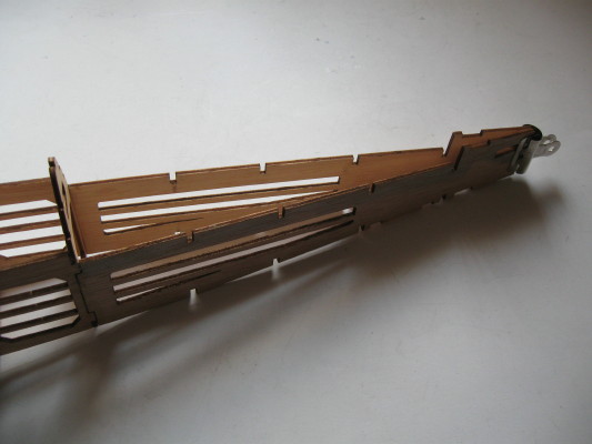

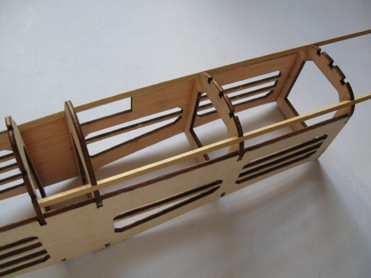

#7 Posted : 28 August 2013 11:20:28

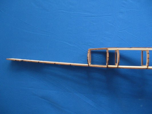

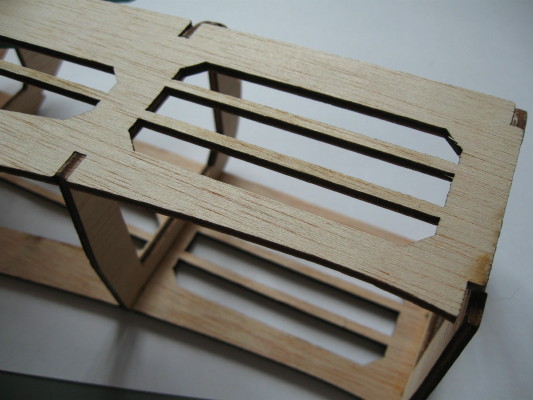

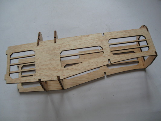

Stage 6 - Contains the starboard aft fuselage side, wooden stringers and a fuselage former.
Test fit, then glue fuselage former #5 at the aft end of the fuselage framework, clamp the frame in place until the glue has fully set.
Take the aft fuselage side, check its orientation with that of the images, then glue it in place onto the right (starboard) side of the fuselage framework as shown. The aft frame should be set so that it follows the angle rearwards of the forward fuselage section.
That complets this stage.

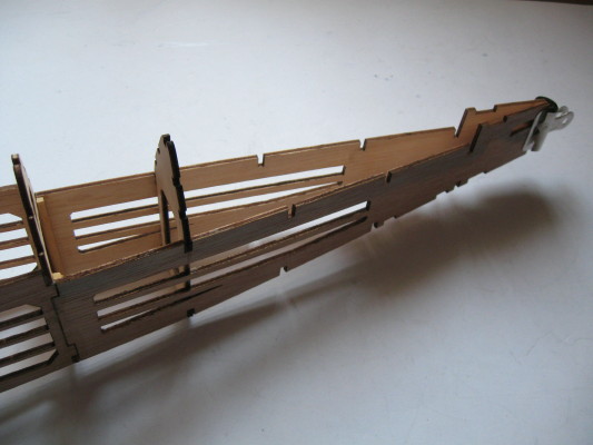

#8 Posted : 28 August 2013 11:25:42

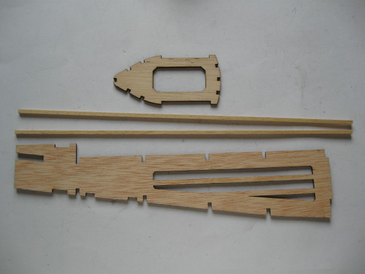

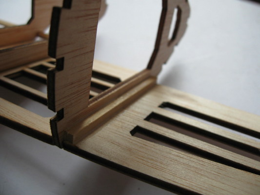

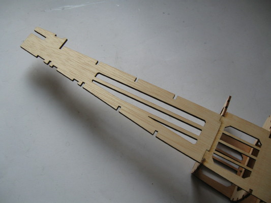

Stage 7 - Contains the left aft fuselage side, wooden stringers and a fuselage former.
Fit and glue the port (left) side, aft fuselage side in place as before, then set aside until the glue has set.

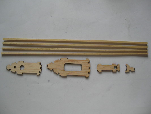

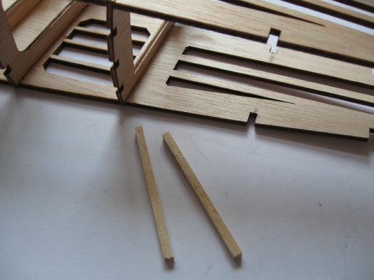

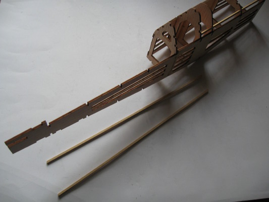

Cut two 58mm long strips from the 3x3x300mm wooden strips provided.
Glue the strip lengths along the joint of frame #5 and the fuselage aft sides just fitted.
Test fit then glue frame #6 into the first pair of slots on the aft fuselage section, clamp the frame in place until the glue has set.

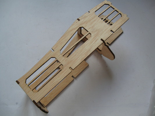

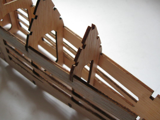

#9 Posted : 28 August 2013 11:28:58

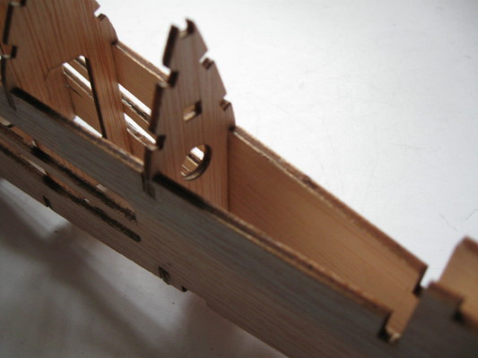

Stage 8 - Contains wooden stringers and four fuselage formers.

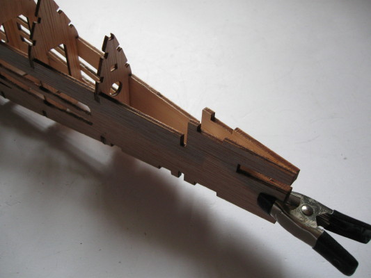

Test fit then glue frame #7 into the aft fuselage framework. Clamp until the glue has set and also place a clamp at the end of the framework, to ensure that both side are level and the end is flush.
Testfit then glue frame #2 in place, place a clamp at the end of the framework until the glue has set.
This completes this stage and despatch. Carefully store the two remaining frames from this stage and the wooden strips.
