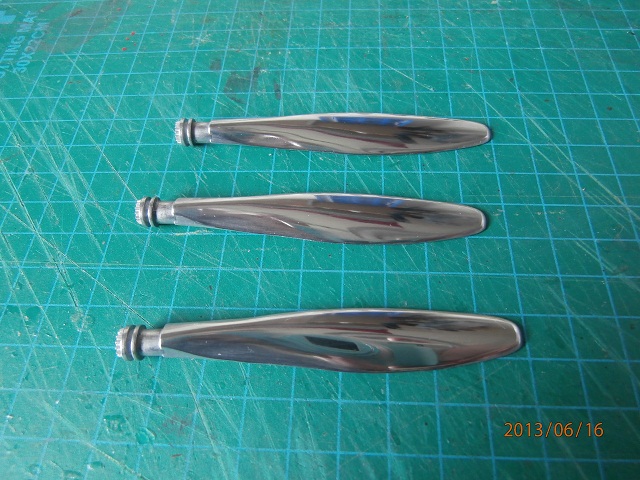

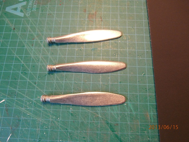

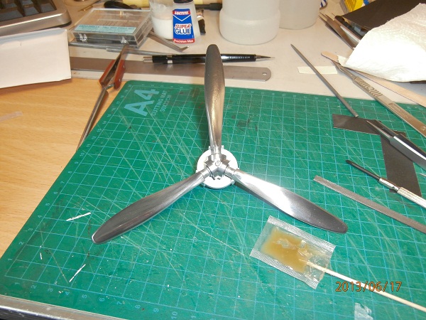

Decided not to wait for more parts and to get started on the prop.

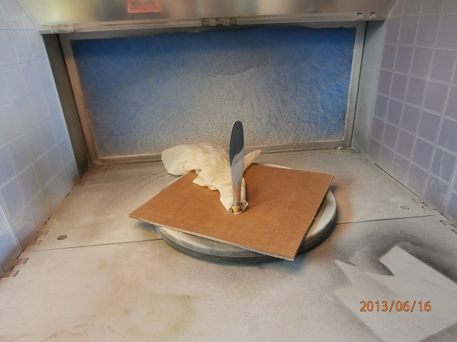

Polished the blades using Brasso then gave them a good clean with acetone before giving them a coat of clear primer. Held the blade gently in a pair of vice grips, which I first put inside a surgical glove to stop them getting coated, to facilitate spraying.

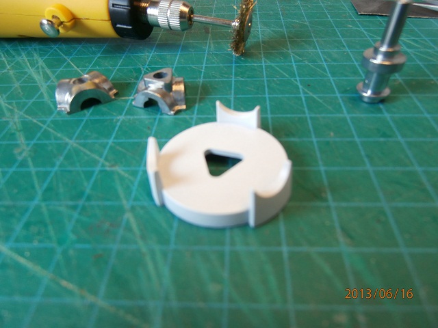

I cleaned the spinner back plate with a wire brush on a rotary tool before giving it a coat of Tamiya fine metal primer as I am doing a fully painted version.
I also cleaned up the prop shaft, front and rear boss and glued the rear boss to the back plate with superglue gel after first removing the primer from the contact areas.

The spray booth can be found at
spray booth
but may be cheaper elsewhere.
It was a relatively inexpensive one which folds away when not in use. Works great with an airbrush but the filter can get dirty fairly quickly if spraying larger areas with rattle cans (especially priming and undercoating)although a lot of the residue can be removed from the filter with a hoover (with the permission of the wifeLaugh ).

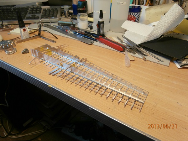

Did a little more last night - put the prop together and started drilling the holes in the wing spars. The 0.7mm bit that came with the kit lasted one hole before it broke but luckily I had others to hand.

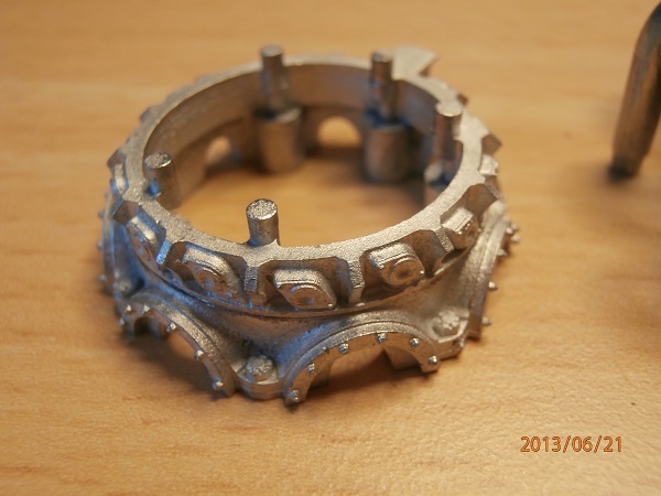

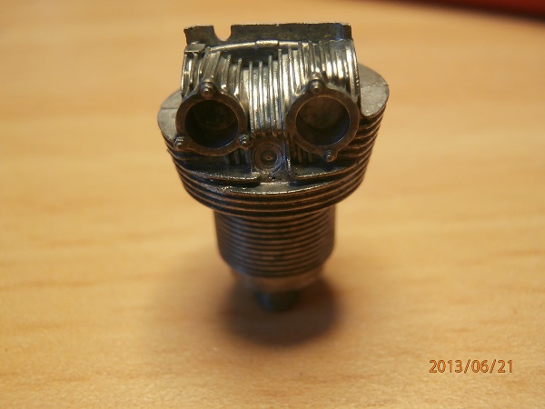

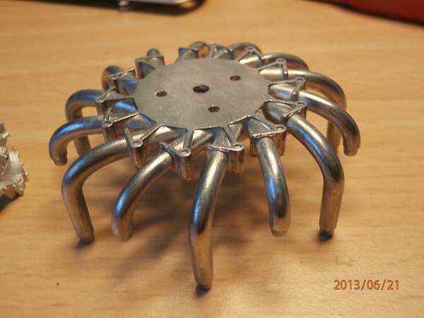

Hi folks, managed to get a bit more done. Wing assembly is complete up to stage 4.
The engine manifold has been cleaned up ready for priming and the crankcase has been glued to the connecting rod case and is ready for priming.
The two halves of the cylinder have been glued together and is ready for the seam to be filled and then primed.

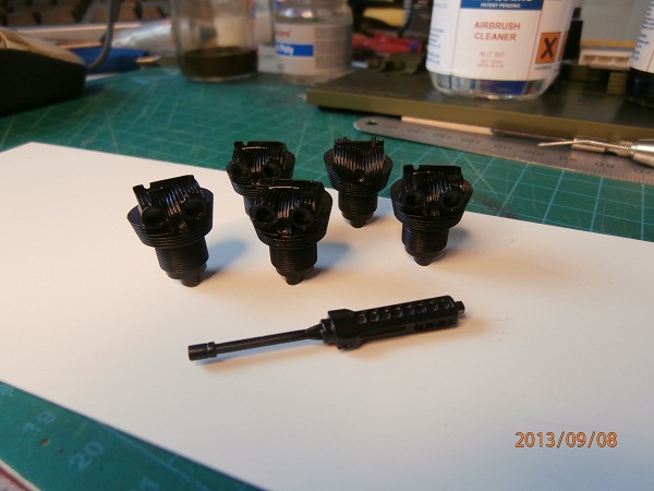

I have been keeping up to date with the build (up to the end of issue 4)but was leaving any painting until I had all the main engine parts.

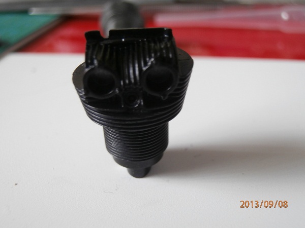

I have completed all the cylinders and filled the seams with milliput and used a wire brush on a rotary tool to remove any excess filler.
I have just primed and test sprayed 5 cylinders with alclad gunmetal and I think they look ok.
