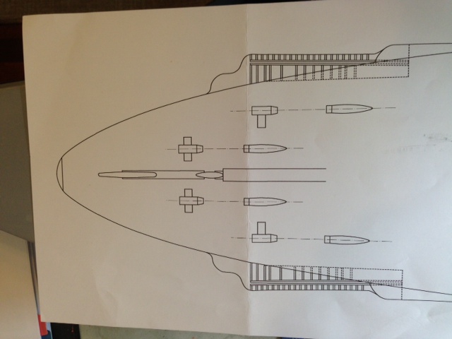

Hi there,
I have traced the hanger supports from the enclosed diagram, but I am having difficulty getting the trace onto the model. I know I am being vague so I have included a picture of what I made the copy from. Is there a specific kind of tracing paper I need to move to wood. When I rub the trace on a white piece of paper it works, but not on wood. Any and all help is appreciated.
Thanks,
Dan

BigGrin Hi dBarton
Have you tried using a hot iron, what you do is turn the paper over print side down on the wood heat up your iron to max and run it over the paper this should transfer the image to the wood. Look on PG7 Post 132 on my build diary for more info. Hope this helps
