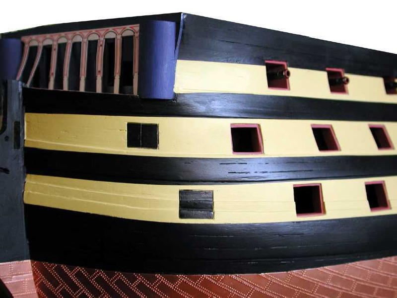

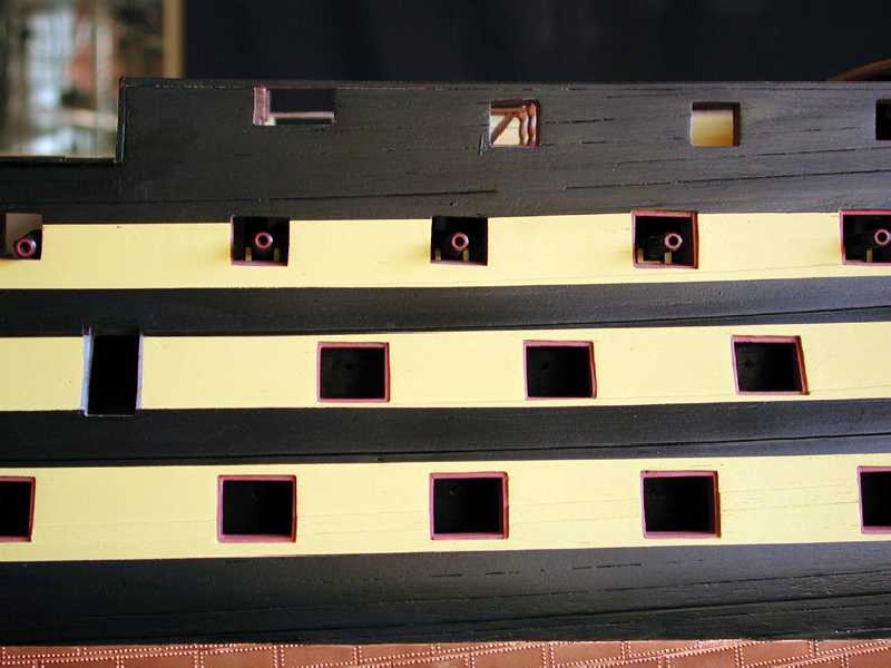

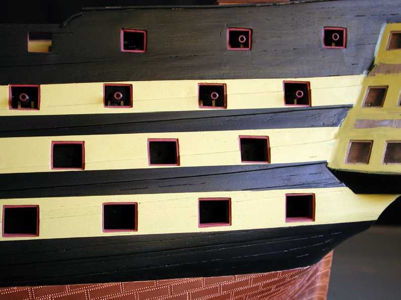

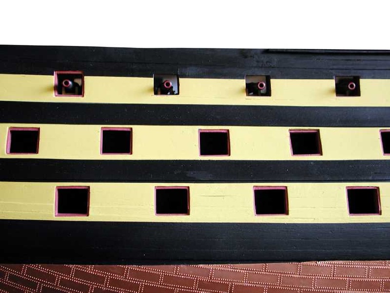

Try these four pics below. They are freely downloadable from the Jotika website along with their brilliant pdf's of the construction details (they're what I have been using to rebuild my DelPrado from).
I painted my hull before all the sticky out bits went on, it's far easier than trying to mask it off afterwards!
The stripes basically follow the top of the drip boards above the gun ports but the bottom of the yellow is wider in the middle of the ship and curves upward at the bow and stern, and the yellow stripes are wider than the black dividers. The gun ports themselves are not exactly flat and follow the curve of the decks so that gives the stripes a gentle curve to begin with.
The other thing to remember is that the yellow stripes do not match up with the stern gallery windows!
Hope this helps a bit.
Robin
