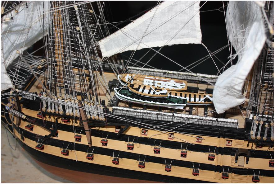

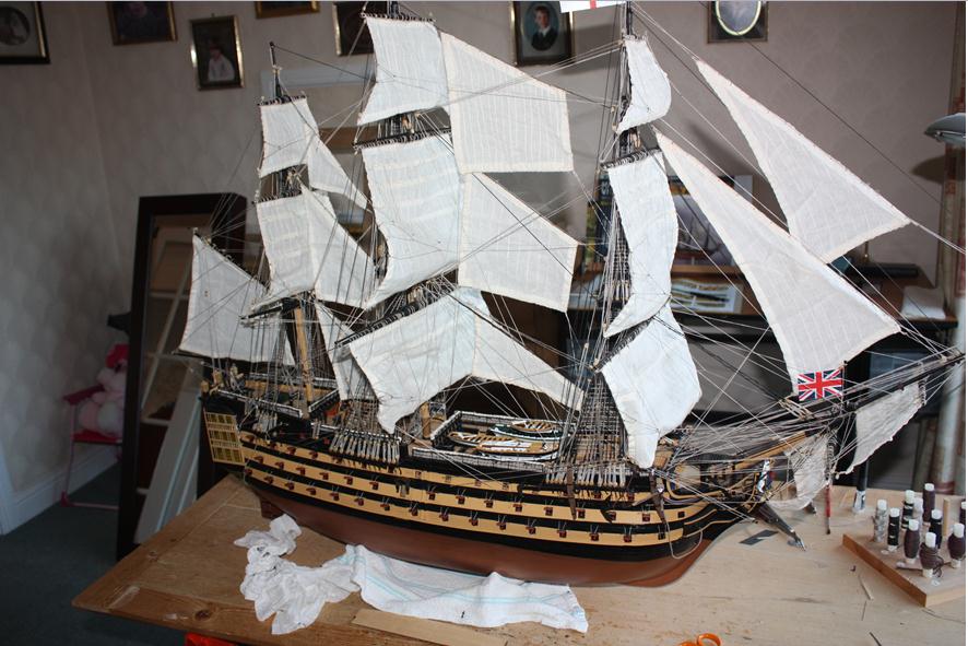

I have reached the heady heights of issue 120 so am nearly there. Pictures attached
Current Build:-
#20 Posted : 06 October 2013 09:44:32
That build looks absolutely brilliant. You should be rightly proud of producing such a wonderful piece of work.
