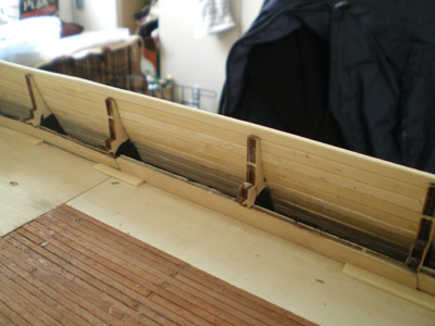

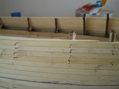

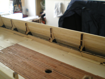

Confused I have fitted the top plank's .A bit confused on the sanding .Are they sanded down to the top of the rib's or just leveled. Blushing Thank's.for any info BigGrin

Not sure which issue you are up to, but I have not started the upper planking yet,so I looked at MrT`s official build and from what I can see there are several tapered planks to bring the top edge of the planks in the centre of the ship down to a lower level.From the angle of your pics I can`t see any tapered planks,that may be your problem.
I would suggest you stop for a short while until one of the more experienced builders may be able to give you the required help needed.
Sorry I can`t help any more than that, but I`m sure it can be put right.

Hi, i believe they are sanded to the tip of the ribs in that middle section, though not for all the ribs, but there will be measurements to follow so unless you want to follow the italian instructions its probably best to wait for issue 35 :)

Might be the angle of the photo,but your top planks don't appear to be tapered as per the Issue 33 steps, and there is more planking to add to the top planking in 34. None of the planking is smoothed/lowered in 33 other than blending of the tapered planks onto the previous planks.

BigGrin Thank's all for the info .have tapered as per step's in issue 33 .Have not sanded to blend in yetHuh
