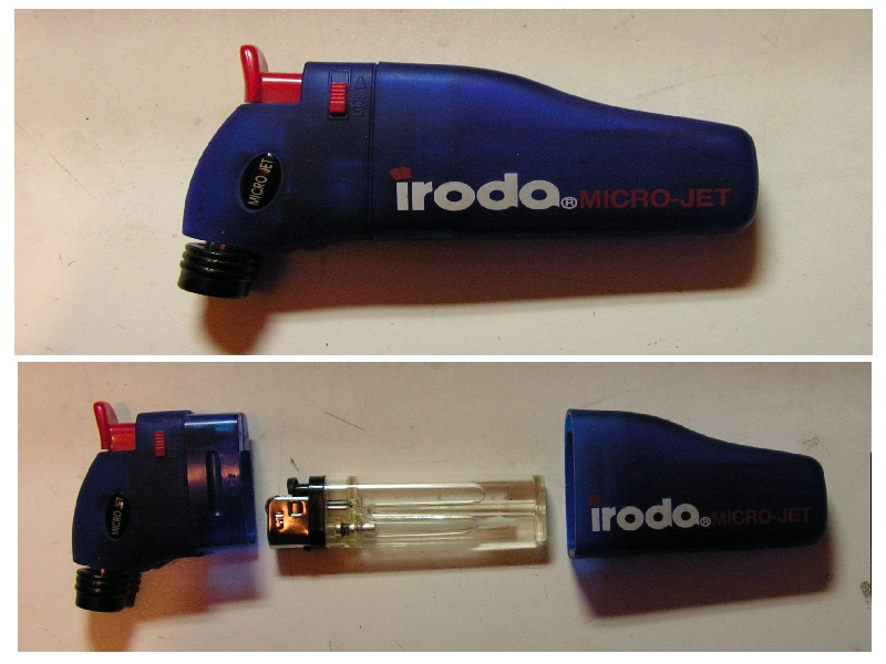

#11 Posted : 14 April 2013 20:05:43

Hi Kev.
You might be interested in this handy little tool from Maplins. Its a micro flame tool similar to the chef's gas burner but with a much smaller and more intense flame. It's powered by a simple disposable gas lighter and should be much cheaper than the bigger chef's version (not sure how much it is today, like most of my Maplin tools I get them when I receive their special offer emails and leaflets!)Blushing
I used this one on my Vic to melt the solder into a brass channel to produce the curved head rail timbers, you can just see the flame it produces on one of my diary pages.
Hope this helps
Robin
