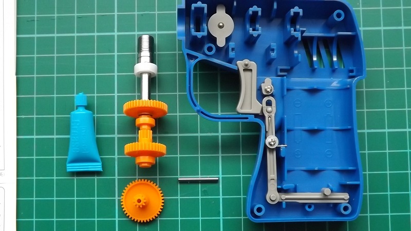

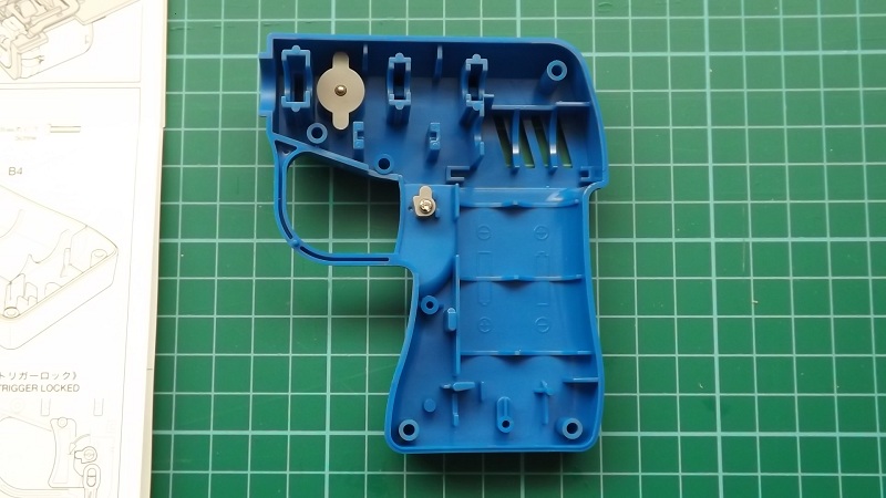

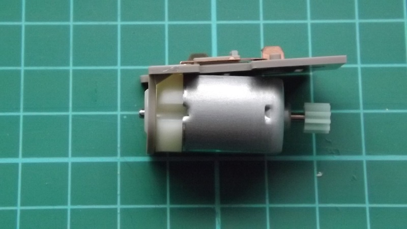

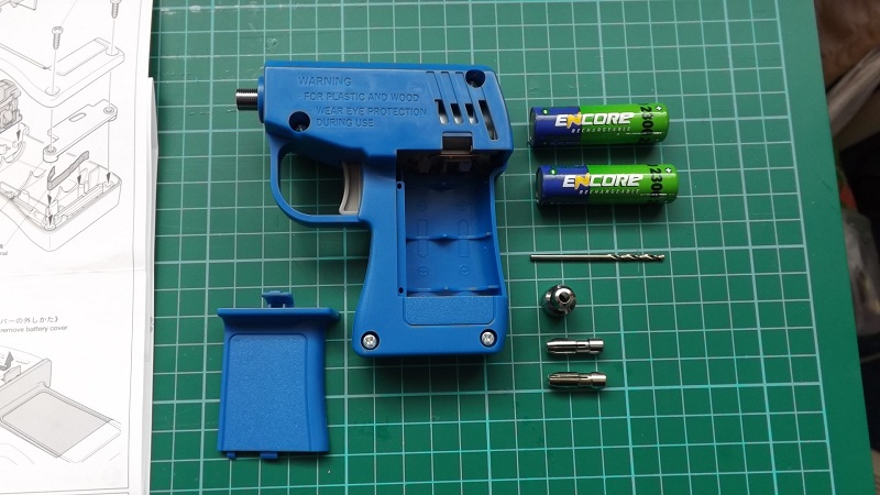

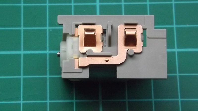

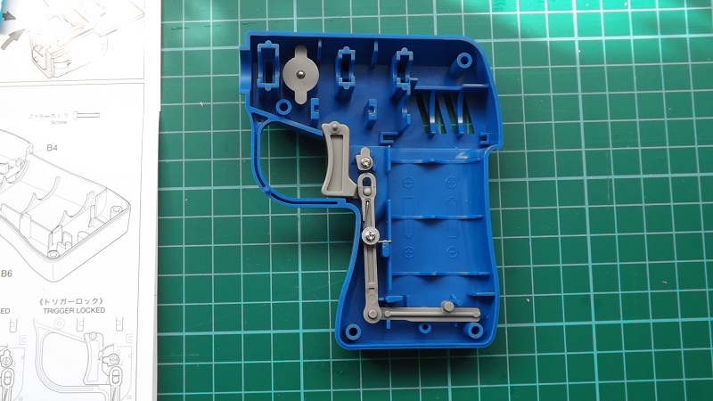

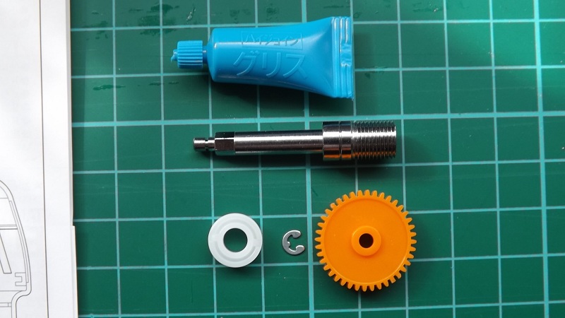

Maybe a slightly odd item to include in the finished build section but as this started out as a "Model Kit" I hope this is acceptable as it does not appear to fit into the Members Ship Build Diaries.
Also hoping that this might get me one of those "Completed Build Medals" (Hint Hint Admin Blushing ).

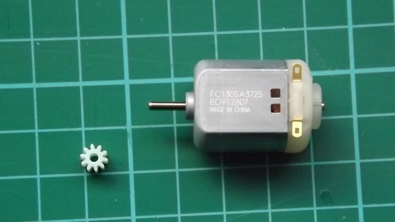

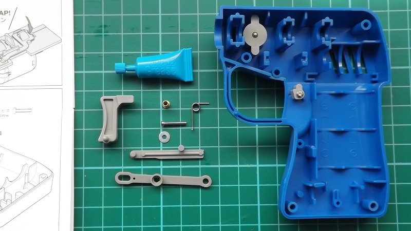

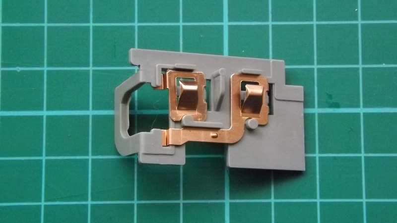

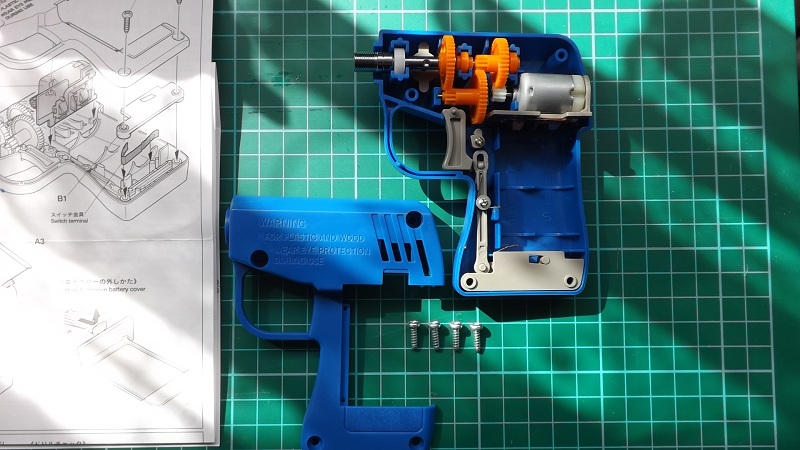

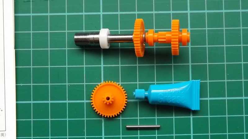

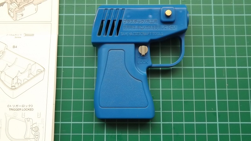

I do have a dremel and subscribers of the SotS series receive a mini electric drill so what, might you ask, is the point of buying this product.
In my case I have been struggling lately using the "manual" pin vices and to be honest while a dremel is very good its far too powerful to use with micro drill bits, and in most cases it’s too much effort to run an extension cable and plug the thing in.

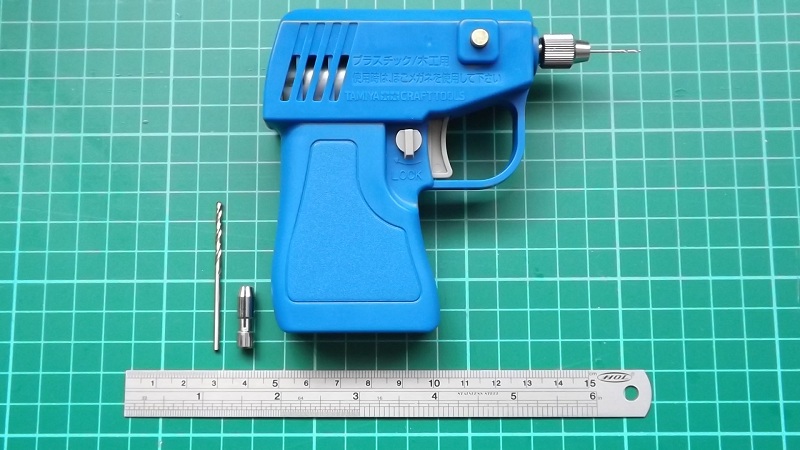

Hence a decision to but one of these Tamiya drills. I purchased this via eBay as a new item from Hong Kong on 27th March and received it yesterday (04/04/13). It cost me £11.00 but had a £6.50 postage cost so quite expensive. Did some scanning for UK suppliers but the few I found would have seen me spending even more on the item (guess this is where someone will write back with a "Did you know you could have got it for this" BigGrin

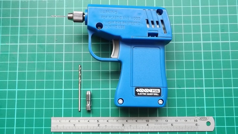

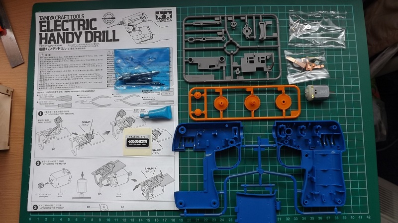

The drill comes with two collets that allow the use of 1mm to 2mm and the second collet allows 2mm to 3mm drills. Having had a little play I have found that the smaller collet actually allows micro drills down to 0.5mm to be used.

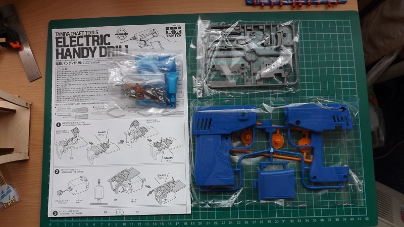

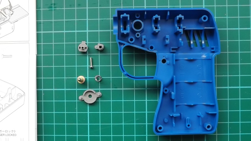

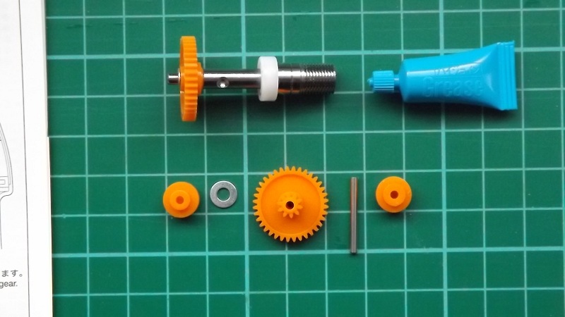

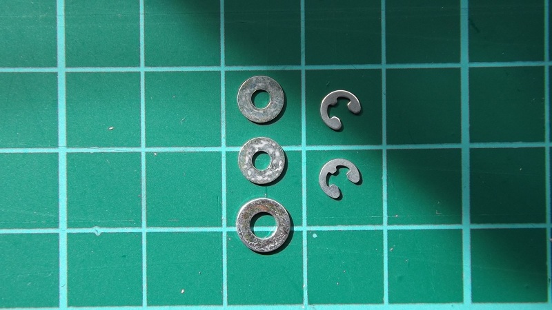

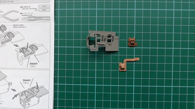

With this item there is absolutely no soldering or gluing required. Tamiya thoughtfully include a couple of spare washers and circlips as these are quite tiny and could be easily lost when doing the build.
Hopefully the following pictures will give you some idea of the construction sequence and the end result is a "Finished Build".
Happy to be "pulled up" by ADMIN if I have posted this in the wrong location or if the article is deemed inappropriate.
Hope you enjoy.

I like this, i dont always feel like getting the dremmel out either so a battery drill would be handy - does the speed increase with pressure on the trigger or is it fixed?
#3 Posted : 05 April 2013 14:41:48
Hi Steve
Its a fixed speed drill rather than variable.

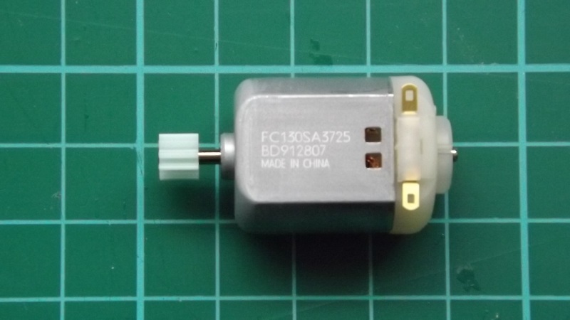

Cannot find the torque setting details anywhere but quite a powerful little unit for just 3 volts of battery.
The instructions state that its only really suitable for wood and plastic which is fine as that is all I use micr drill bits on anyhow.
