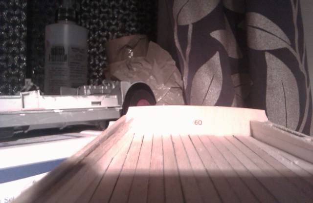

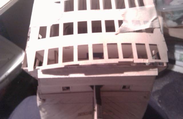

hi guys m in need of help after putting the poop deck the back end loks to reallyo ut of shap the ship as a whole looks to be straight but theres about 5mm differance from one side of the galley to the other the pics ive added are after i took off the panel (60) any suggestions what i can do to fix this problem
thnaks cal
cal attached the following image(s):
#2 Posted : 18 March 2013 21:57:10
I'm affraid it looks like you will have to remove the gallery and remeasure the gallery location on the starboard sid e and even it up,I suggest you soak the gallery in warm water for ten minuets then carefully remove the gallery.allow 24 hours drying time,then redo after measuring.good luck. k.

...and parts will shrink in the drying process after soaking in water. I had a little surprise but observed natural process and corrected position as required to get a good fit. As I measured position I had to learn that planking on both sides is a little bit different - only a mm but trusted my eyes to find correct position. So, no easy task but with a second attempt you will succeed. best luck & keep up good work, Stefan RollEyes

thanks guys here goes nothing lol
