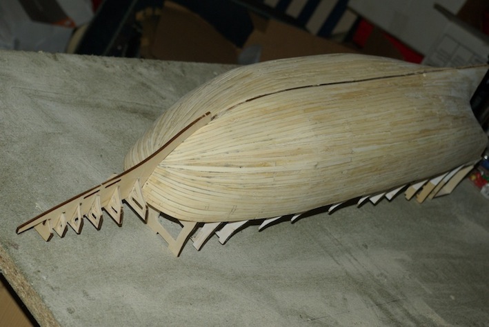

Thanks Andy,

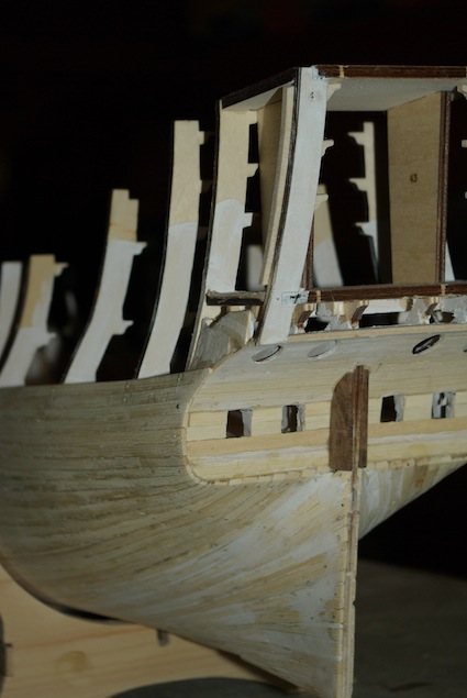

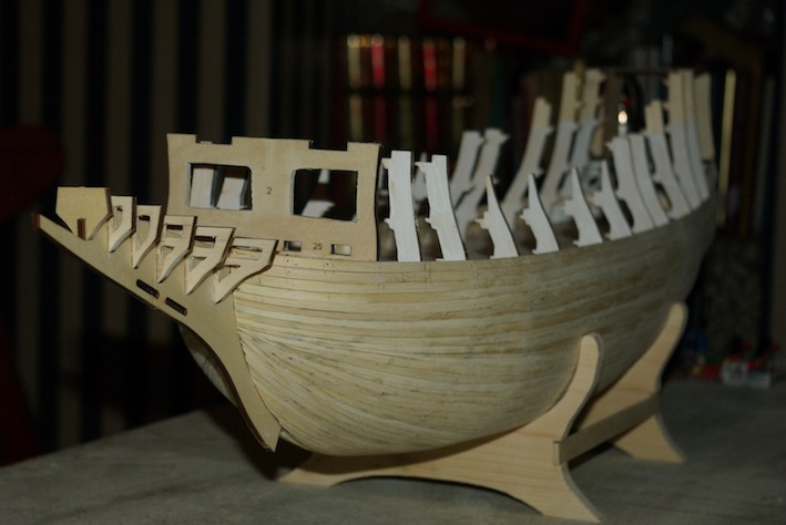

I don't like working with bamboo as the planking is full of lumps and bumps where the plank was cut through the bamboo node, no matter how much I soaked them I could not get them straight.
Sandy

I agree Sandy, those Nodes, which seemed to be present on nearly every length of the Bamboo, were one of the deciding factors for me to plank in Limewood. They are much harder and brittle, and as you say do not bend whereas the rest of the Strip bends almost too easily. I could see that this would cause problems with differential bending and differential sanding.

Looking really good Sandy... have to admit, I did the same as Dominic, carefully selected the strakes where the nodes would not be used... Still ended up with a few on the hull... Quite enjoyed using bamboo but probably because I haven't tried planking with any other kind of wood as yet..... Sanding and filler should leave us with a very smooth hull for the second layer.....Cool Cool

I agree Alan, sanding and skim filling, thank god it's a double skin model. I also cut out the worst bits , all I have left is a pile of match sticks until the next delivery.

looks great sandy! the nodes were annoying especially because they're harder to cut through, cutting the ports might be a challenge if they're in the place of the gun ports, though hopefully a dremel cutting disk should do the trick :)

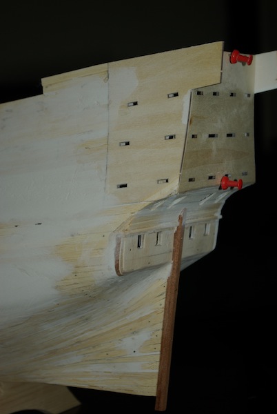

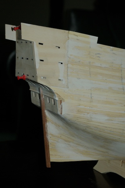

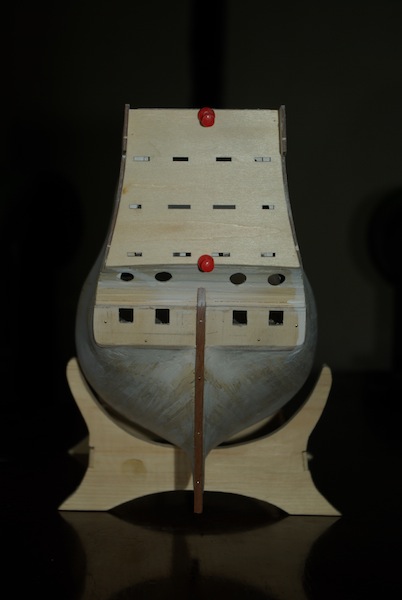

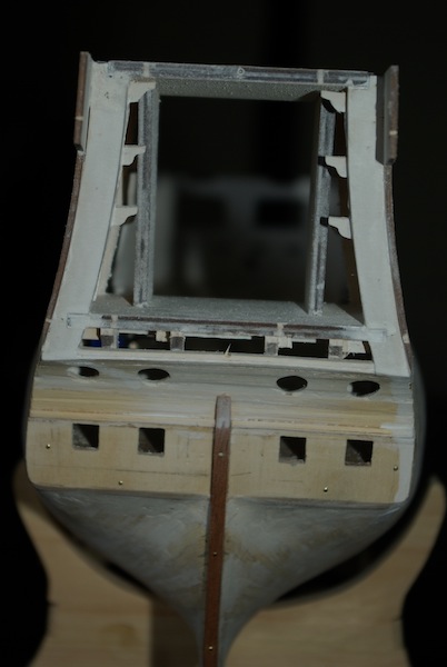

starboard stern castle
port stern
view with the aft gallery panel removed, the planking supports are dry fitted for later removal to make way for the gun rooms, upper-gun deck and cabins

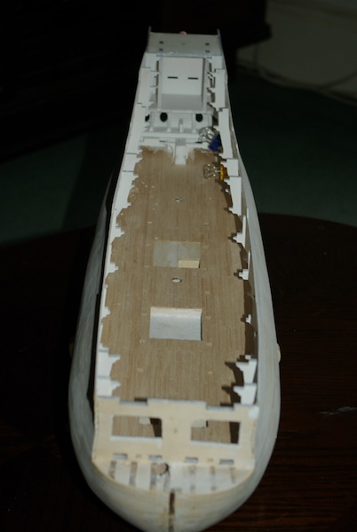

view aft of the lower gun deck
view forward

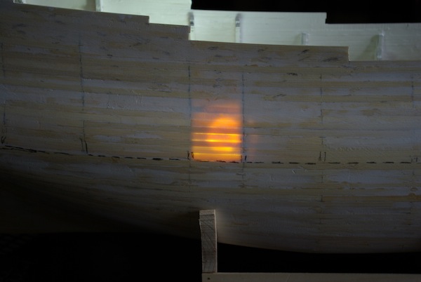

Not having the foresight to mark where the decks are I had to come up with a solution. I used a torch to accurately mark out the lower gun deck. Hope this is of use to someone.

#12 Posted : 29 April 2013 14:08:12
Hi Sandy the build is looking very goodBigGrin the touch idea is a good tip, I am framing the gun ports before I plank then I will not have to cut them Kind regards Mike
#13 Posted : 29 April 2013 14:53:23
BigGrin Nice idea to use the torchCool

Thanks guys for your comments the torch used was stronge led type that will power the fibre optics.

BigGrin Love the work Sandy . Good tip BrilBigGrin Rgd Martyn

I love the trick with the torch Sandy.You have some lovely flowing lines to the hull despite the bamboo.Thinking about your outer planking,have you considered Pear?I think this is about the nearest wood to the colour you want and is a lovely tight grained timber to work with.The only downside is its pretty expensive.

Very nice work Sandy, love the modifications you have made... BigGrin BigGrin

great work sandy! nice little tip too, should of thought of that!BigGrin

Still lots of sanding and filling to do one thing about photos they show up what still needs to be done all too easily.
