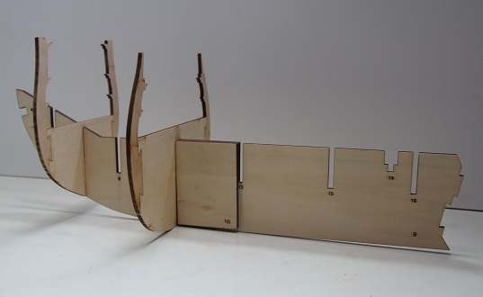

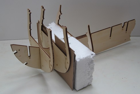

[img][]Well, I have started!
First off, I have to admit I haven't yet made a jig/drydock. I still might make one later. The bow has been traced onto a piece of 4mm ply just in case.
I notice that Tomick's official build doesn't use a shaped bow support anyway, just the supplied bow stand (pieces C1/C2).
The first 2 pieces of keel are a straight as a die when glued together with the bracing pieces. Just a slight warp of about 1mm, right at the tip of the bow, which the jig wouldn't correct anyway. I will sort this later, when the bowsprit is added.
Rib 6 had a slight warp too. About 1mm diagonally across the main piece. Not enough to send the part back but I made another problem by sanding too much out of the slots of the joint to the keel.
The problem was using a loose sheet of fine sandpaper. I was very gentle but I have rounded out the slots very slightly, so there was a slight wobble in the fit - which was tight as could be before I sanded. 45p at Tesco got me a pack of 10 fine emery boards; £1 at the local Asian hardware shop gave me a set of 6 needle files of different shapes. Controlled sanding is the way to go!
Correcting the wobble-fit and warp was done by packing the assembly. I knew that rib 7 was a perfectly square and tight fit - I had dry-fitted it when joining the keel pieces and clamping the bracing pieces to butt against it. Now that 7 is glued in, I dry-fitted 6 and used a vernier to measure the correct centre distance between them at 52mm. Packing was done with a piece of foam insulation slab (49mm) and two slips of cardboard from a wine-box, the same both sides. Anything would do really, so long as it is exactly the same on both sides and really tight.
I will keep the rib packed out until the lower deck is glued and pinned in place.

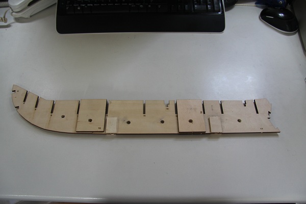

Amazed to get my next delivery on Thursday. CS had told me the dispatch date was Wednesday. So I got them the day after dispatch. Either brilliant service, or CS don't know what they are talking about LOL
Anyway, issues 4 & 5. All parts looking flat.
I glued up the next keel part, cut the slots for display mounting bolts (as per issue 5 Masterclass) and covered the slots with spare ply from the sprue.
Next, drilled 8mm holes through, between each rib, for my ballasting. These are for M8 bolts, which will be packed out with about 15-20 large flat washers each side. This should add as much as a kilo to the hull, near to the bottom. Mr T said that the finished model is about 5 kilos and I suspect most of that weight will be above the 3rd deck. I dont want it toppling over on it's display mountings.
I might not use the forward-most hole - wait and see what it feels like, balance-wise.

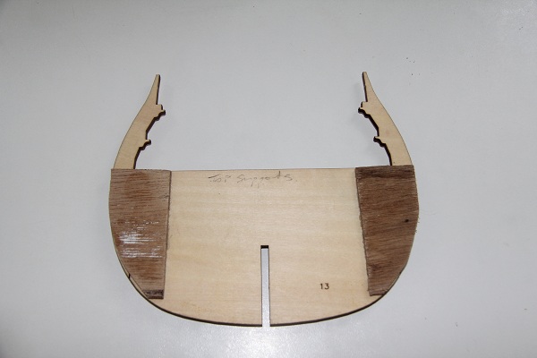

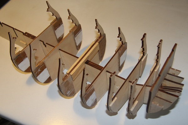

Next, strengthening the rib joints.
I found they were tending to come apart after glueing, so I did two things. First, get some better glue! The old bottle had been around for a few years and was no longer white.
Second, I cut bracing pieces from some 4mm ply.
These are cut to go from the outer curve to at least 10mm inboard of the joints. They are glued to be flush with the rib at the top, so they provide an extra glueing/pinning area for the outer edges of the deck. They don't go right to the outer curve, so I don't have to sand and fair them all later. They are set about 1mm inboard.
Rib 13 will get extra strips along the top edge, where the front and middle deck pieces will both have to be pinned. As they overlap on this rib, each deck section would only have 2mm of rib to be pinned to, so this gives extra room for glue and pins to get a proper grip. I will do the same on the rib where the aft and middle deck sections butt together.
That's it for now.

All ribs now braced. At least, the ones I have received so far.
The front two (5 & 6) done with ply cut from the fret/sprue waste and the rest with stuff I had lying around - this had been previously used, so there is still a bit of paint on one side, but this will not be seen so I didn't sand it all off.
Rib 13 now has top reinforcement as well, for pinning the deck joint between front and middle deck sections. This was made from some 5mm pine strip offcuts, again just stuff lying around.
None of the ribs are glued in yet. I am waiting for the lower deck to arrive, to use it as a fixing jig. The slots in the deck edges will be used to align the ribs as I glue them.
Captain David attached the following image(s):
