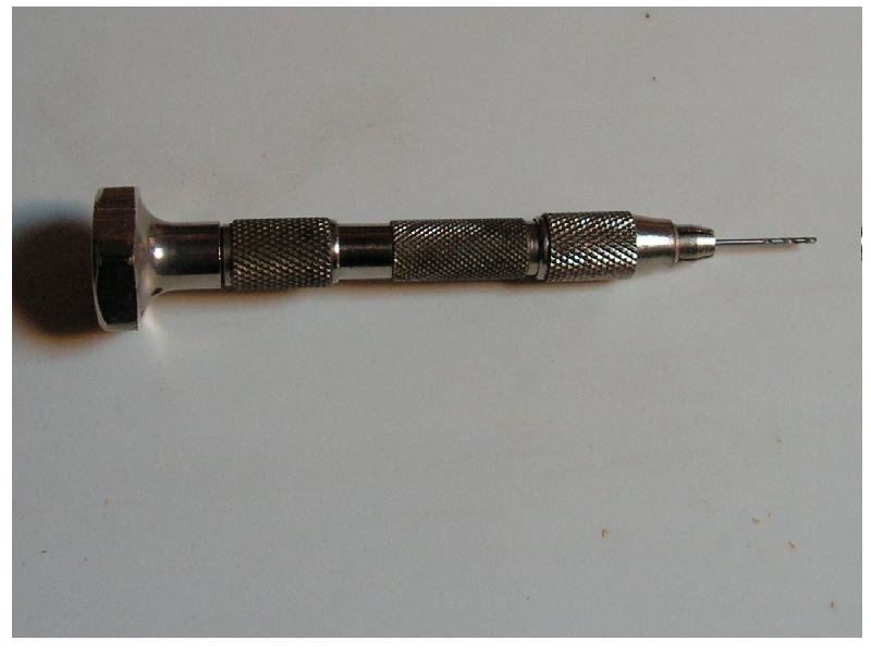

Personally I prefer to use a pin vice (see below) its much more controllable than a power drill and less likely to 'skid' across the planks.
The handle breaks down into three sections with a selection of different chucks inside. Most model shops will have them or try ebay and Hobby's Annual, roughly a fiver or so in cost.
Robin

I have one but for the life of me I cant get it to grab the drill bits properly.
Anyway, I went to B&Q. I found something called a Dremel multi chuck which does the job superbly. Obviously not on my screwdriver, but on my Dremel. Like a knife through butter.
#11 Posted : 17 February 2013 16:32:49
Have you tried unscrewing the chuck and turning the collet end over end, as one end has a larger collect bore than the other..

Yes, tried that, but it just doesn't seem to want to grip the drill bits.

Have had the same problem with a miniature hand drill, but cured the problem with a piece of very thin card between the spindle and the outer sleeve, it gives a tighter clamp on the inner spindle .

It's really strange but after years of perfect drilling my own pin vice suddenly stopped gripping the smallest drill bits, about 0.7mm or thereabouts. I managed to get over it by cutting a 1cm length of thin plastic insulation from a bit of 7/.02mm wire and (with some effort) slipped it over the drill shank. Works fine now but why it suddenly went like that I've no idea!Confused Might also work (and easier) with very thin heat shrink as well.
Robin

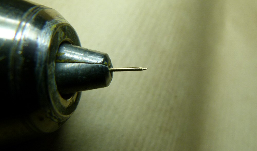

I just snip the head off one of the pins and put it in my cordless drill, have to be steady so as not to bend the pin
