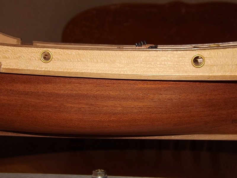

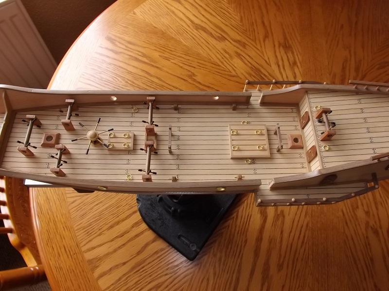

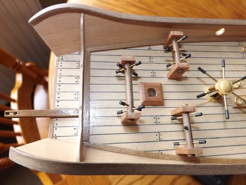

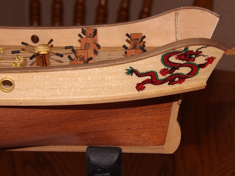

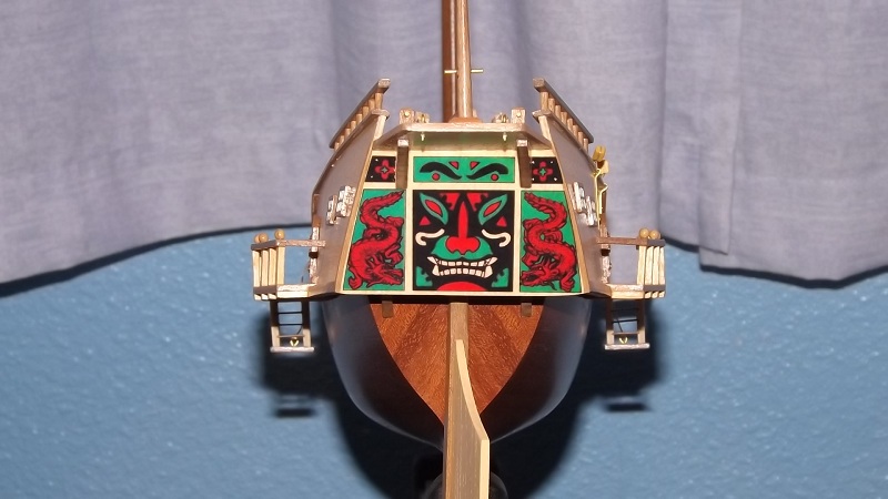

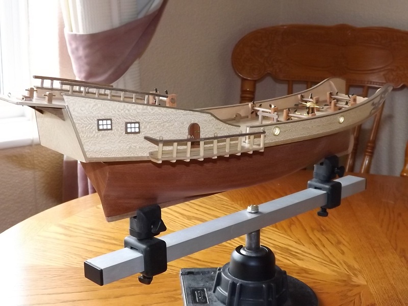

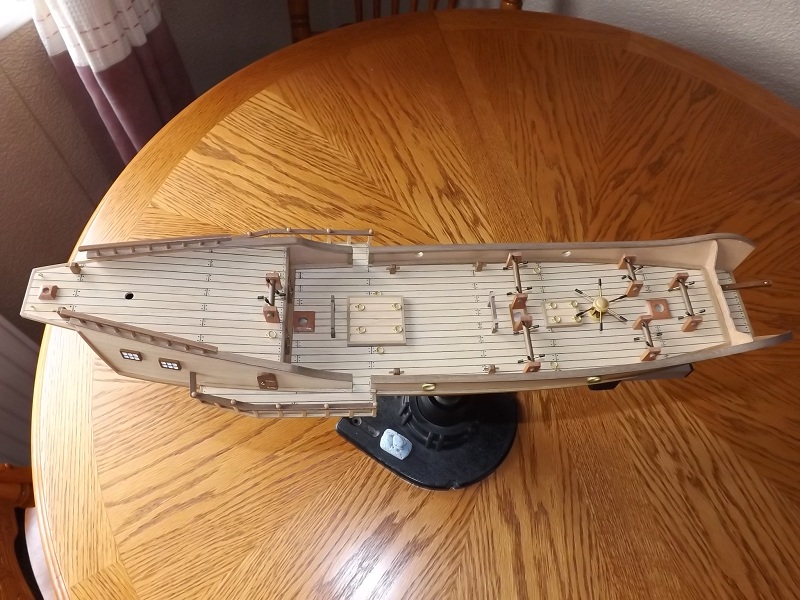

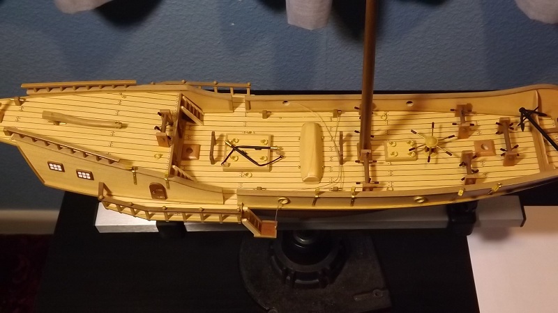

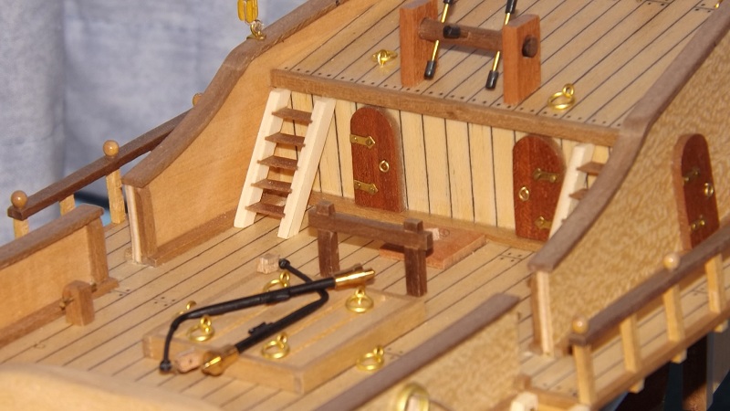

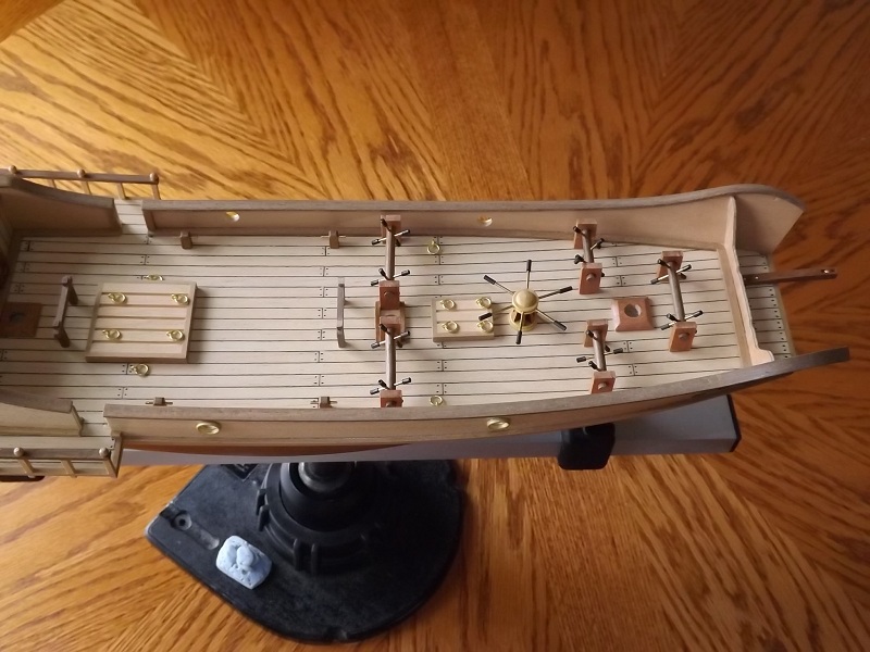

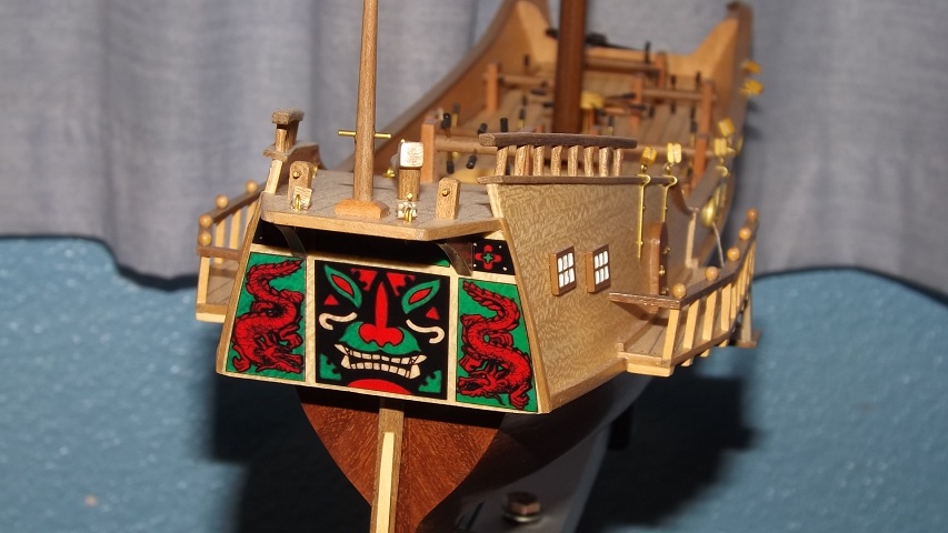

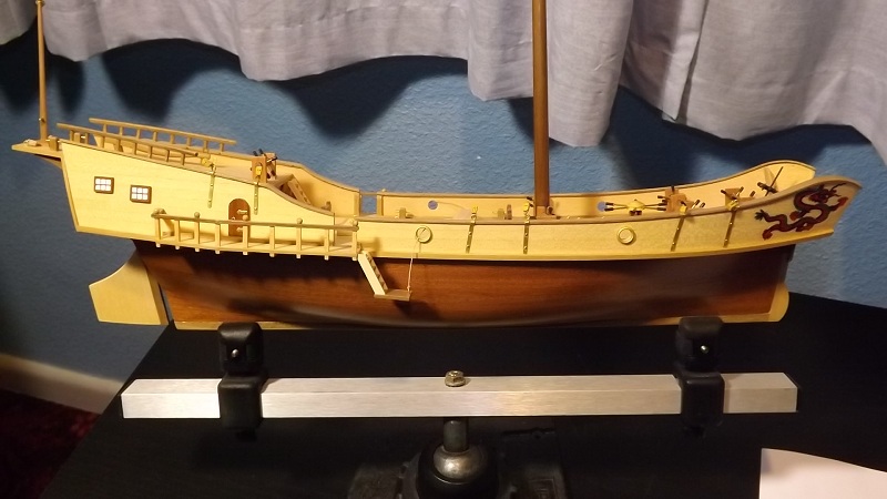

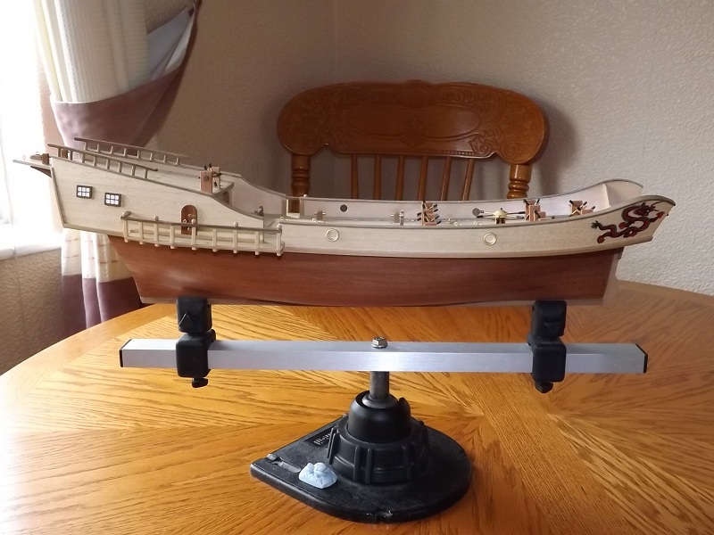

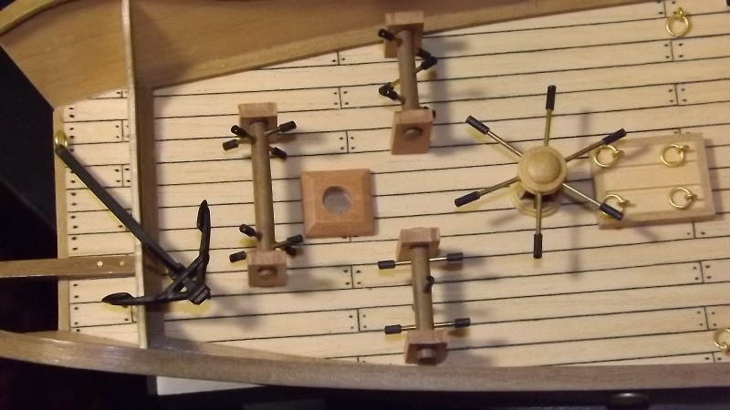

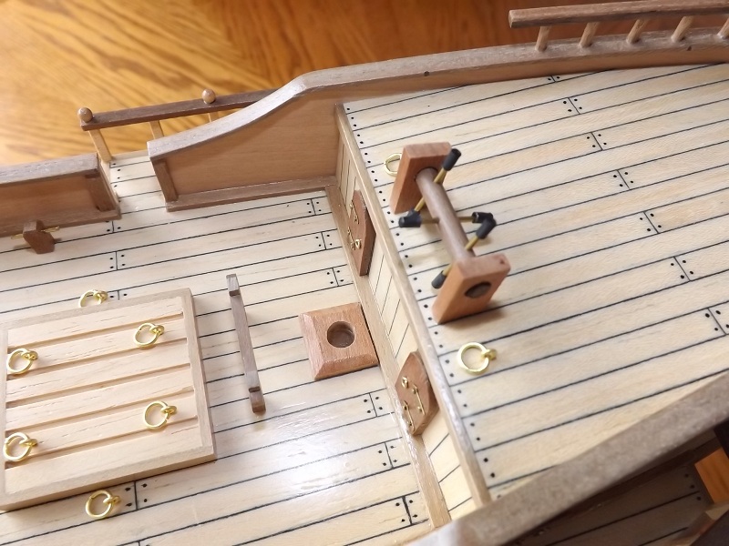

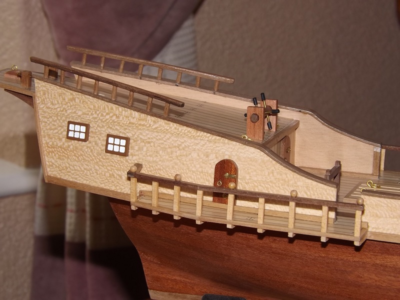

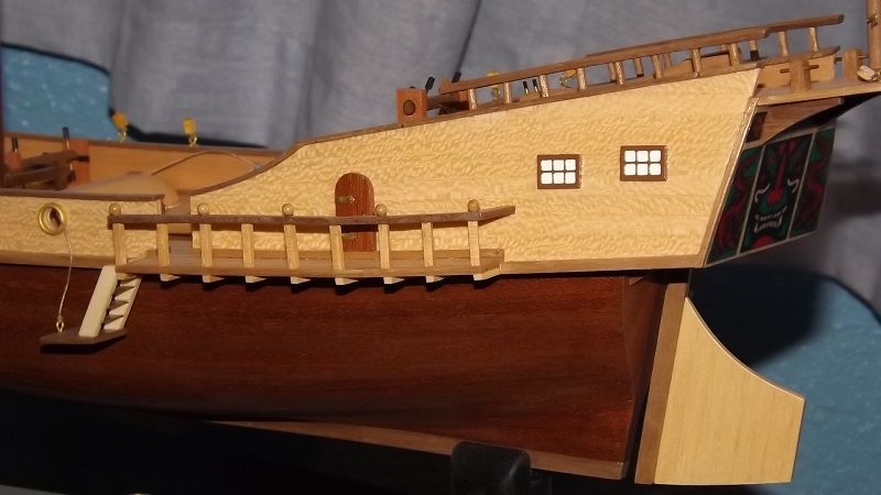

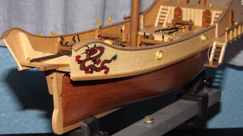

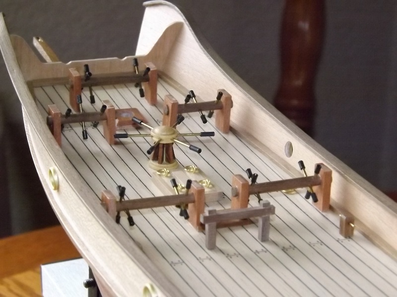

Anyhow that’s enough about me for now (some might say for a lifetime BigGrin ). I purchased last year the Artisania Latina kit called RED DRAGON CHINESE JUNK and these are a few pictures I would like to share with you. A good few things I have done wrong during the build, and still a long way from getting it completed but hopefully I will get there in the end.

I am certainly no expert and have made a number of errors as I have gone along. Believe it or not this is only the second build I have progressed with - my first (to help me learn planking) was the Caldercraft CHatham Yatcht. Its not gone as well as I wanted and at this moment resides in a cupboard waiting to be looked at again.
This particular model took my fancy 1. because it was a cheap buy from ebay, and 2 I rather liked the mottling on the wood. The lower half is sapele (so the same as SotS will be providing). The white wood is listed in the guide as Mukali (cannot say I have ever heard of it before).
For the deck caulking I used Black Quilling paper which took an age but turned out pretty well.
Everyones kind comments have given me a bit more drive so hopefully over the coming weeks I will be able to add to this diary to show you how this model progresses.

Was the Dragon a double planked kit or single planked? My own Grimsby was single plank and all the hull was Sapele, its a beautiful wood when its been varnished, almost like mahogany (but probably cheaper!)

To answer your question this model is double planked. To be honest it was a fairly straight word job in that next to no tapering was required. Started with what the instructions call Samba wood. Looks like lime to me but I am no expert on these points. 1.5 x 5mm was the thickness of these strips. Over this it was 0.6 x 5mm sapele.
Have a couple of areas of concern: one is the supplied cannon. They are traditional canons but without wheels. Look rubbish so I bought some caldercraft wheeled canon in the correct scale - problem they sit to high for the barrels to go through the ports unless the barrels are aimed at the fish! Also made a mess of the first sail. Bought some fabric glue which went on like a rubberised flour and water. Looked awful so had to buy some Amati sail cloth and must now decide how I will seam these (full credit to deagostini for made sails on the victory kit).
Hope you can see lots of issues and problems but I guess that is the nature of these sort of models.
