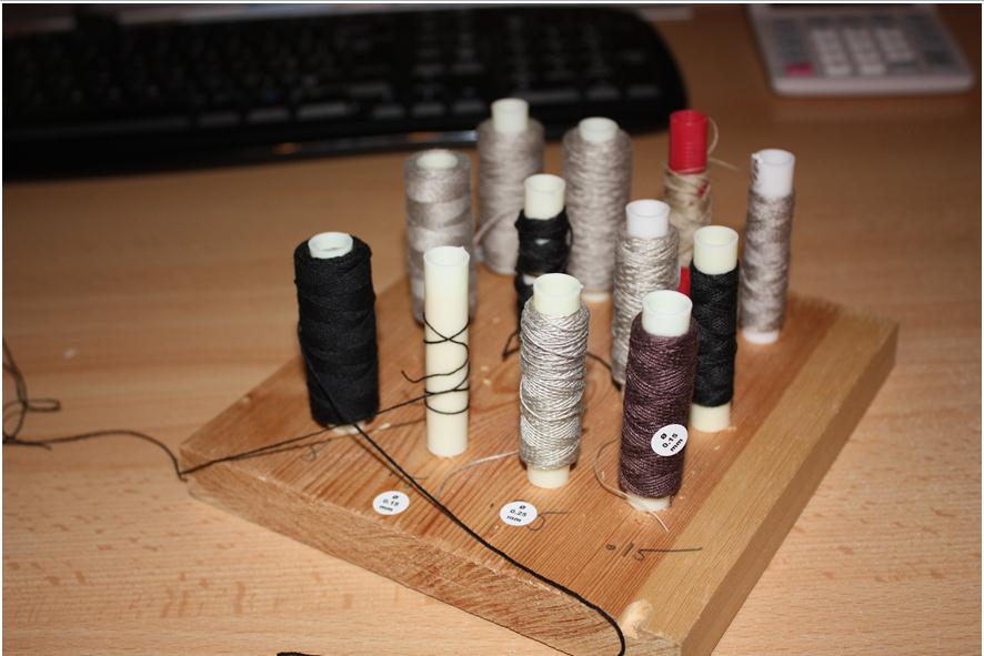

I am now into the high 90's with my build and at the last count has over a dozen spools of thread of various colours and sizes. One problem I have found is that when you remove the sticker you also loose the ref to the size of the thread and it is not always easy to see which is which. Also they are a bit like storing the hosepipe in the garage, you put it away nice and tidy but when you come to use it again it is all tied up in knots.
So I have devised a simple spindle rack to keep the spools tidy and also this allows me to mark the size for future reference. The thread is kept tidy and I can unthread enough for the current task.
Take a piece of timber approx 7 inches square, drill in series of holes in my case 8mm as this is the size of dowel I used and is ideal for the spools. Hammer lengths of dowel into the holes and place the spools onto the lengths of dowel. Mark the size of the thread on the base or attatch the label.
Simple but effective
Piccy attached

Lovely idea there Gil, simple's always best!BigGrin

Yep, second that. Having within recent memory rigged the Endeavour and been thoroughly muddled, I wish I'd had your idea then.LOL LOL

That's a great ideaCool I have added the size to the spool in permenant marker but had not thought about how to keep them untangled. Thanks for the ideaBigGrin

Great idea, and to-days plan is to make the spool rack.
Thanks for sharing it with us.

Thanks for sharing that one. Brilliant idea and really simple

Excellent solution to tangled reels of threading.... going to make one.. Perhaps you should have it patented.....BigGrin BigGrin .. Well done...

Brilliant idea, made one myself and works like a dream just one small addition, placed a small eye round the edges which i used to feed each spool. Works like a charm
