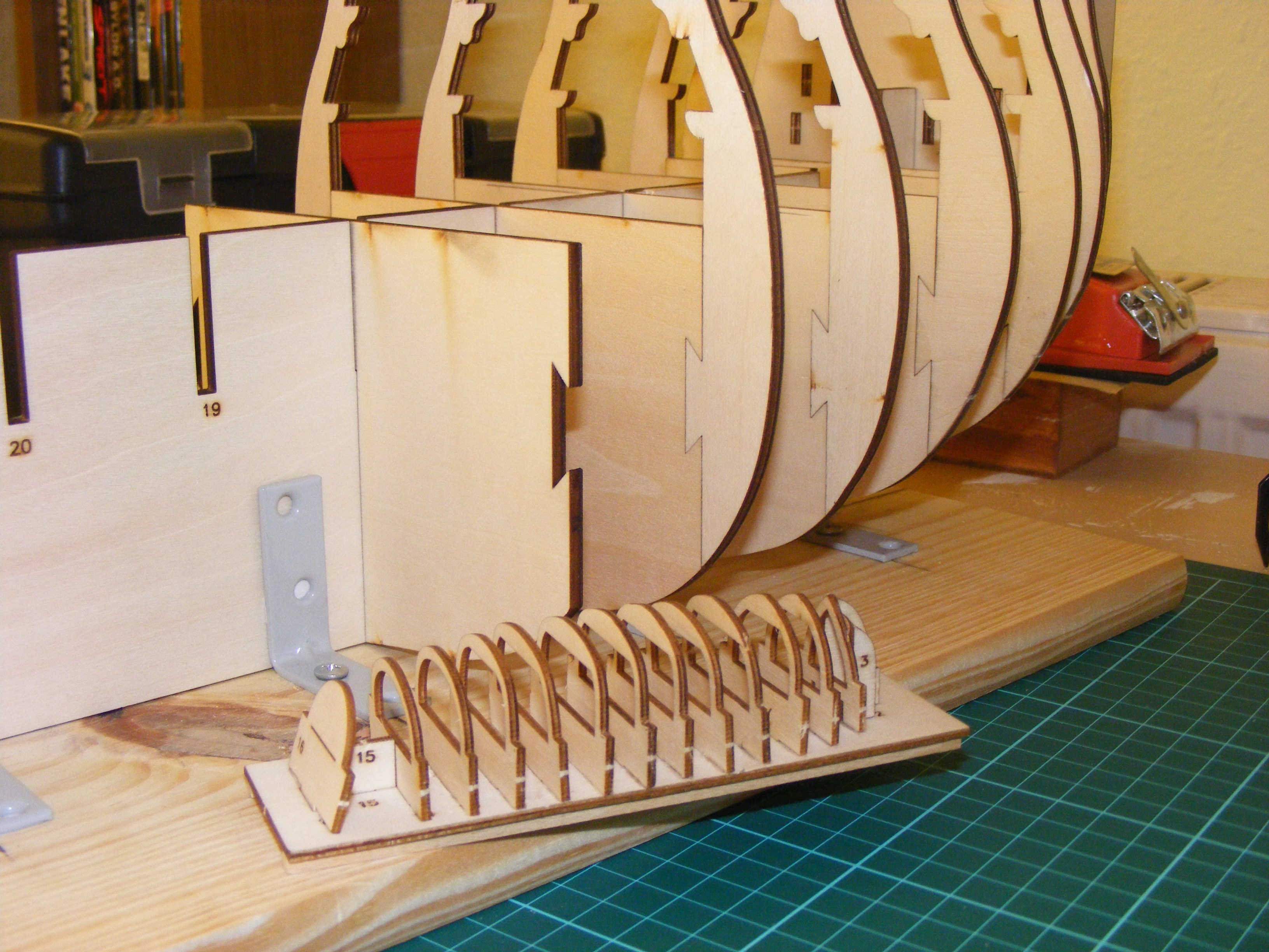

hay ship mates just done the launch very tricky not all the tabs fit
into the slots lots of filing to be done.

I have just attempted to build the launch however I failed miserably and snapped part #4, so didn't get very far.
This is, as you can imagine, quite frustrating.
How do you order the parts again?
Thanks
Mike Turpin
#9 Posted : 01 June 2010 17:30:06
Joined: 13/10/2011
Posts: 851
Points: 2,628
Location: Leeds, Yorkshire
Hi there
Several of us have had a similar experience -- the ribs are quite fragile. Before you re-order part 6, have you considered sticking the broken parts together with some super glue? If you can get the ends to come together, the strength of the bond should be greater than the surrounding wood. Once you start planking the ribs you will find that the whole thing gains strength and rigidity. It's at least worth a try and is an advantage of working in wood.
If you haven't found this yet it might be useful to you. Launch Construction
Welcome to the mad house
Cheers
Mike T

Thanks Mike for your words of wisdom. I did actuall try and stick the parts back together but I felt I wasn't getting the result. How do I Re-order part 6?
Thanks
Eoin
