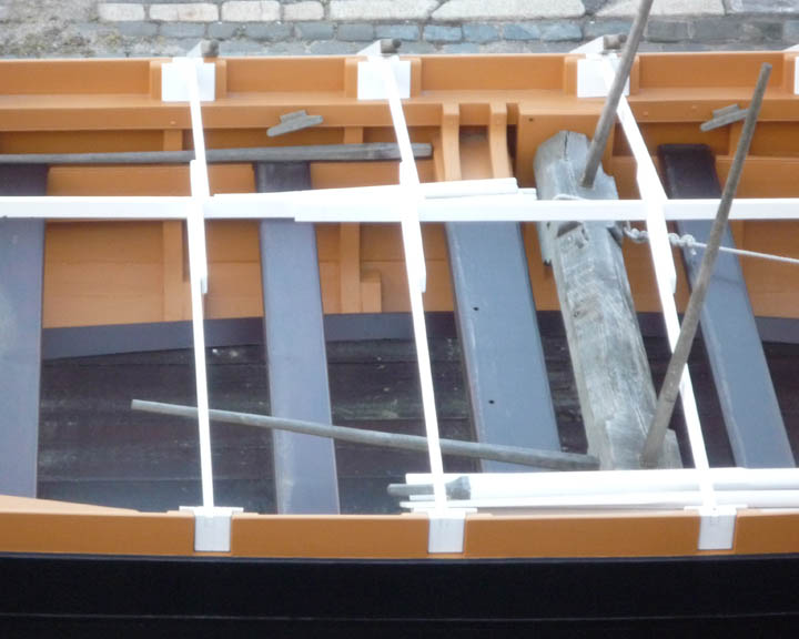

Here are some pictures of the launch at Portsmouth note the internal colour differences to the magazine model.

The Victory website provides guidance for the colours to use and states that the thwarts and sternsheets should be in a natural varnish, which is at odds with what they have done in your pictures!
I think ships boats were finished in a variety of colours depending upon what the boatswain had in his stores or what could be obtained from the dockyard.
I shall probably use yellow ochre, black and white as shown in the magazine but may well leave the thwarts and sternsheets in varnish.
It will be interesting to see how our motley crew respond to this challenge!BigGrin
I haven't started my planking yet so will wait and see what the next set of instructions bring with regards to painting. However the question is easily answered by the natural finish brigade!
Mike T

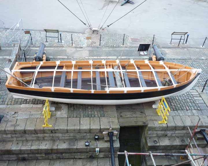

Another

It also occurs to me to ask whether you have a bows on photo of the hull of the launch which might show us how the planking is arranged/shaped ?
Mike T

No I do not hve a bows on photo.However this photo is taken from the oficial HMS Victory website.

True I forgot that one, but the plank lines don't stand out very well Heigh Ho
