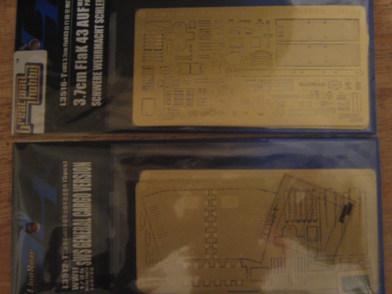

Hi All,
This is my first attempt at a proper build diary, so please be patient with me!
The SWS kit, Maybach Engine & the P.E. Set are all from Great Wall Hobby. The P.E. for the SWS, the Turned Barrell & Brass Ammo are from Lion Roar.
I've never made a Great Wall Hobby Kit before so it will be interesting to see the quality & fit.
All comments welcome!
Thanks
Wilfy

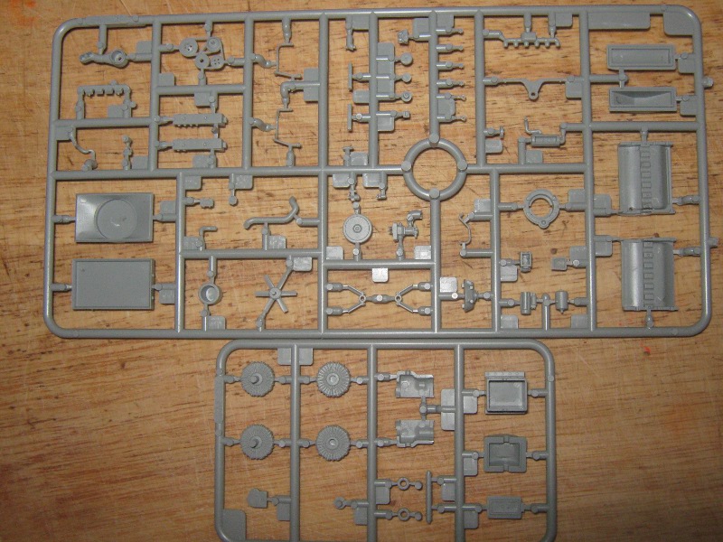

Hi All,
These are the sprues for the engine assembly. There is also a very small etch fret with 5 pieces on it.
On first inspection look very clean & crisp.
Wilfy the Sea Dog attached the following image(s):

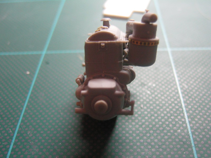

Wilfy the Sea Dog
#5 Posted : 31 October 2012 00:14:50
Joined: 06/06/2010
Posts: 566
Points: 1,657

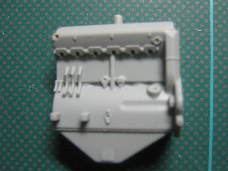

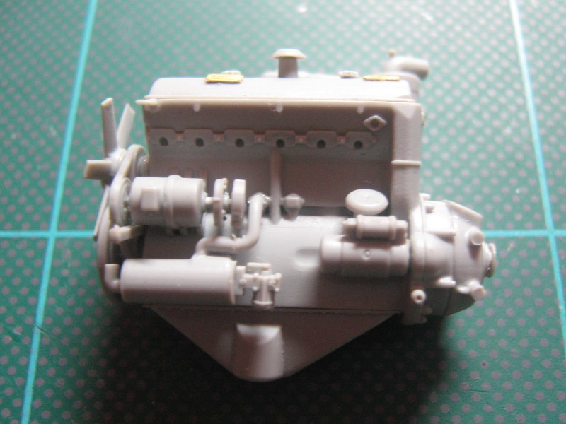

Don't like the sprue attachment points though, on many of the parts they run the onto item (don't stop at the edge) & are a little tricky to remove especially when they are on the mating faces.
Fit of parts is generally good though.
The first four engine parts assembled.
#6 Posted : 31 October 2012 09:09:28
BigGrin Hi Wilfy
what i do with sprues like that is i use the wire cutters provided in the free tool kit[victory,yamato,akagi issues] to cut the sprue about 2 mm above the part then use a small file to take it back to the part,or use a sherp blade to take the sprue off after cutting either way will do but the blade way can be a little to tricky for some,hope this helps

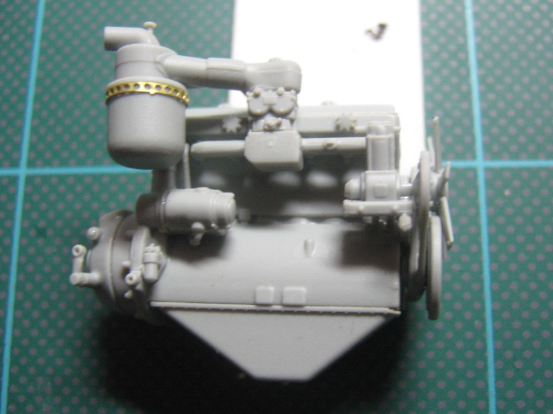

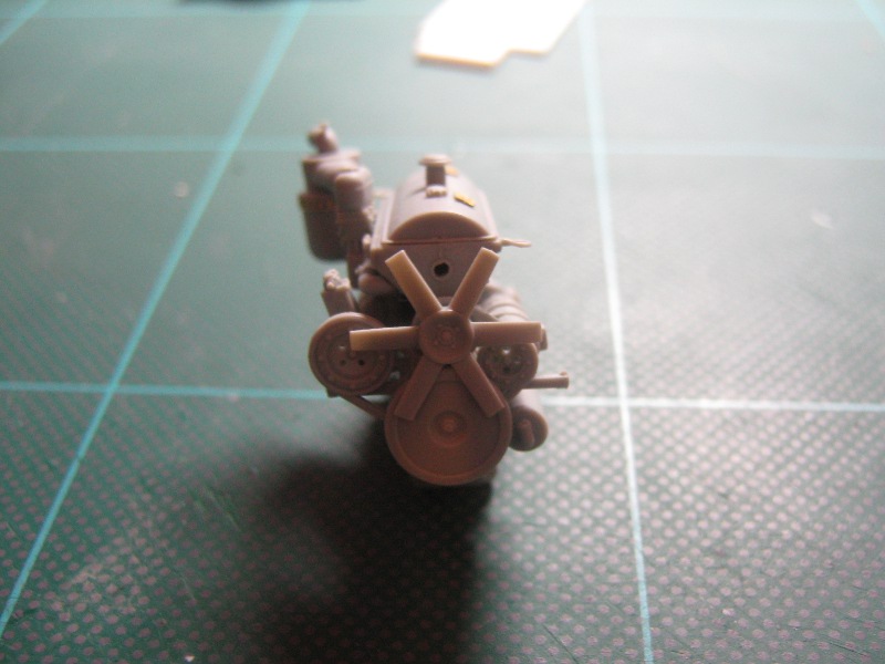

More shots of the engine with detail added. Fit of parts was excellant.
Would make a nice model in it's own right.
I have since found out that this engine is not strictly correct for the SWS, it should have a side mounted oil tank (rather than underneath) amongst other things! It was purchased as a bundle, so I didn't think to check. It would be possible to modify it but I think I'm past that point so will use as is.

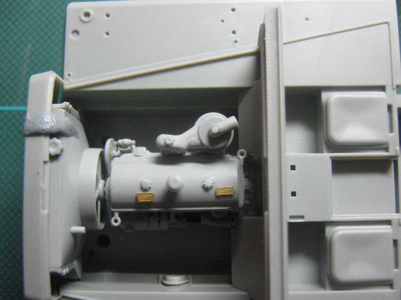

Wondered if you coul give me a bit of advice, I'm unsure what colour to paint the inside of the engine bay, I've tried searching the net but haven't found anything that really helps. Do you have any ideas?
Thanks again.
Wilfy
#14 Posted : 01 November 2012 13:20:35
BigGrin Hi Wilfy
the engine certainly looks good and aka Kevs coments on the sump,as for the engine bay colours as an educated guess it will be the dark green drab or the dark yellow drab base coat that was applied at the factory during manufacture as any other camoflage paint was added by the vehicle opperators in the field.hope this helps
Wilfy the Sea Dog
#15 Posted : 01 November 2012 13:43:38
Joined: 06/06/2010
Posts: 566
Points: 1,657
Thanks for that Andy, the base colour is olive green, so think I'll go for that.
The painting instructions are the only real let down of the kit so far, no detail painting covered at all.
Thanks again.
Wilfy

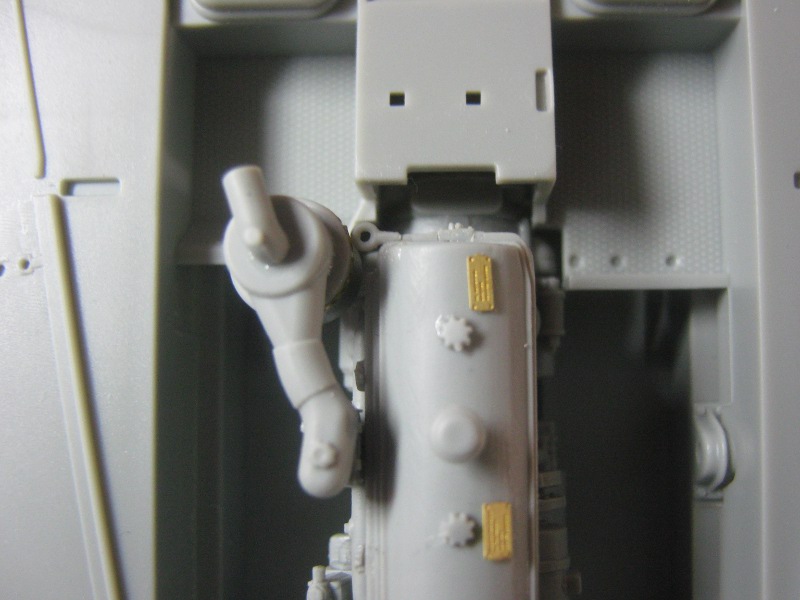

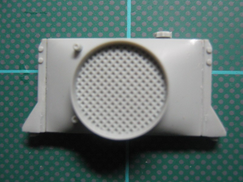

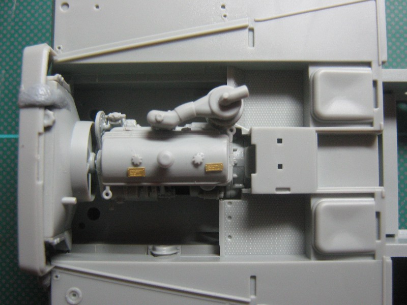

As the engine kit is not made to specifically fit any kit, I thought I best dry fit it first just in case!
Glad I did, as you can see from the pictures the air filter (?) encrouches into the foot well & there's no way that the rear engine bay panel can be fitted.
Wilfy the Sea Dog
#17 Posted : 01 November 2012 13:52:34
Joined: 06/06/2010
Posts: 566
Points: 1,657
I decided to cut the middle section out of the hose, which shortened the assembly & set it at a slightly different angle. Not ideal but it fits!
I used an etched razor saw attached to a scapel handle to make the cuts. Once reattached I tidied it up a bit with Mr Surfacer 500.
Doesn't look too bad, me thinks BigGrin
Wilfy
