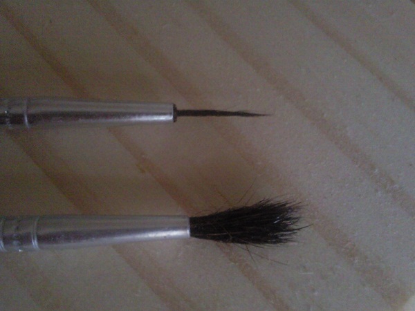

As already said a hair cut works.I also mix a little pva in water,shape my brush and allow it to dry to get a nice crisp point and keep the stray bristles from interfering
Hector attached the following image(s):
