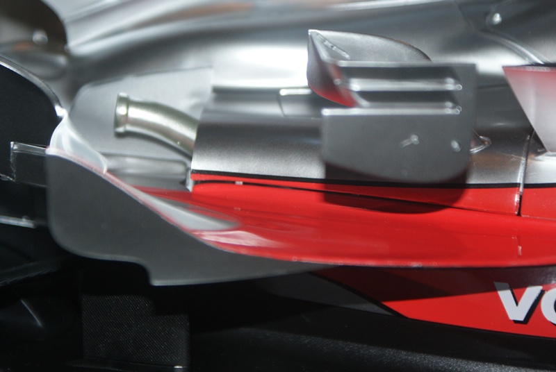

With the end in sight, the build is still not without its issues! Angry
My engine and airbox cover has never fitted quite right, I didn't say anything before because I knew we was getting a revised air intake
But even with this smaller intake I am still experiencing a fitment issue
pics attached
It may be the case that my piece was "squashed" during delivery but i wanted to see if anyone else had this issue and if so how they resolved it?
I was planning to gently heat the part up and try and "fold" the edges back into shape Confused
Any help would be greatly appreciated at this stage!
Just don't want to apply the decals and Kleer coat only to find i need to replace parts

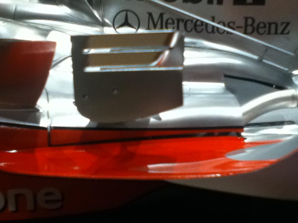

I have a similar issue although it is not quite as noticeable as yours, my engine cover fits perfectly everywhere but does not quite meet the sidepods by about 1mm on the right and 2-3mm on the left, I can press it down into place so there is nothing obstructing it. The cover must be slightly miss shapen, I have tried heating it with a hair dryer but it just sprung back into the same position (maybe I did not put enough heat into it). Like you I have known for a while but was trying to work out what to do, I am not overly concerned because the left hand side is almost acceptable, and ultimately it could be either glued or screwed into place just like the engine cover on the real car.

Same as yours 3mm gap both sides even with air box off. Seems sides of cover not long enough................
Fix please !!!!

In your first photo, it looks like the vertical gap gets wider the closer it gets towards the bottom of the car where the engine cover then follows the horizontal joint and in that plane it seems to get wider still towards the rear of the cover.
To me that suggests that it is the internal air induction box - the one with the gold foil around it - which is holding the engine cover up too high maybe?? Can you just temporarily try fitting the engine cover WITHOUT the internal induction box in place and see if that allows a better fit at the joints?? If that cures it then let me know as there MAY be a solution to the problem without resorting to glue or screws?
Kev BigGrin

I've already tried applying the "fix" from the admin sticky but that doesn't resolve it either so its not the induction box. The cover simply doesn't fit on top of being too flat

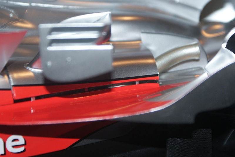

Here are a couple of pics of my gaps, as you can see the right hand side is not too bad but the left is more prominant. I do not have either part of the induction box fitted so that is not the problem. I think it is just out of shape, the problem is what to do? heat up and adjust or fix into place, as I said earlier I have already tried heating it with a hair dryer but it didn't work, maybe I did not get it hot enough.

The Admin 'sticky' fix was translated and made by me, but it seems as if the 'fix' doesn't make much difference anyway.
It really looks as if the two vertical tail fin halves are fitting nicely together, but leaving the horizontal lower halves at a slight inclined angle compared to the body - hence, they won't lay 'flat'.
The trouble with the 'bending' solution, is that the kit plastic is really hard and fairly thick and will probably break before sufficient bend is applied.
I remember reading somewhere once that with polystyrene kit plastic, to bend it into a better shape, you need to bend between 30-50 degrees past the correct shape.
I suspect the McLaren bits won't cope with anything near that.
Also, being an ABS kind of plastic, I don't think heat will make a scrap of difference until you get to seriously high temp which will discolour the paint anyway.
I haven't reached this stage yet, but as far as I can see, the only real 'fix' is to allow for the gap when building up the main body, and adjust to fill it as far as possible.
Not much help to those who are nearing completion I'm afraid though.
Sadly, many of us are learning 'fixes' from the problems others are finding.
Kyosho development seems to be a bit lacking in several areas.
Roy.

I didn't do the little cut out bit as it didn't make a difference to the panel alignment when the induction pod was left out all together. If I really push the panels down then they do align but it does seem the induction pod panels are slightly too large for the engine cover to easily fit in.
I really think this is something admin need to look into otherwise we're all going to be hacking bits off here and there and bending it to high heaven.

Looking ahead, the rear of the engine cowl is secured with two screws via its wing to the rear fairing fences with two screws. This pulls in the cowl for an improved shape, though this also means that the engine cowl is not an instant 'lift off' item without first removing the screws.
Because the rear of the engine cowl is screw secured, some might want to consider fixing the engine cowl permanently.
Admin/DeAg have been alerted to the matter.
