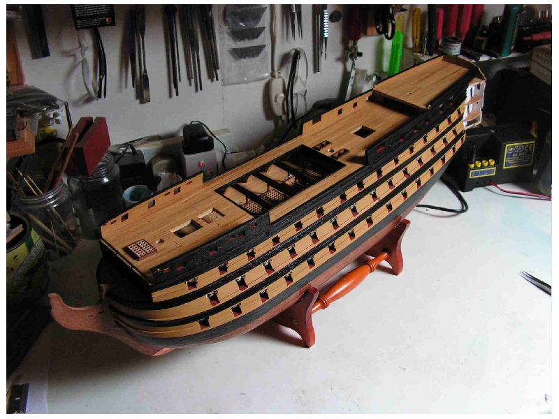

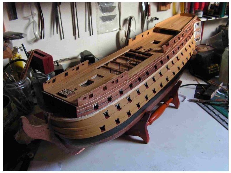

Following on from the above here is the hull a week or so later. The forecastle bulwarks (or hull, I'm never too sure) have been raised up to form the more enclosed fighting area as in the Jotika version. This was double planked using left over hull planks which gives a truer scale thickness (and also cuts out a whole lot of fiddly fence-work from the Portsmouth version!) At the same time, the waist gun port area was also double planked on the interior for the same reason and repainted with the more authentic Admiralty Paints Yellow Ochre. The third embrasure from the left on the bottom row is the one that was replaced in the photo above. The first of the wales is in the process of going on, all the wales were increased in size as per the Jotika plans (available from the Jotika website as free PDF downloads)and NOT according to the Del Prado instructions (as will much more of the build).

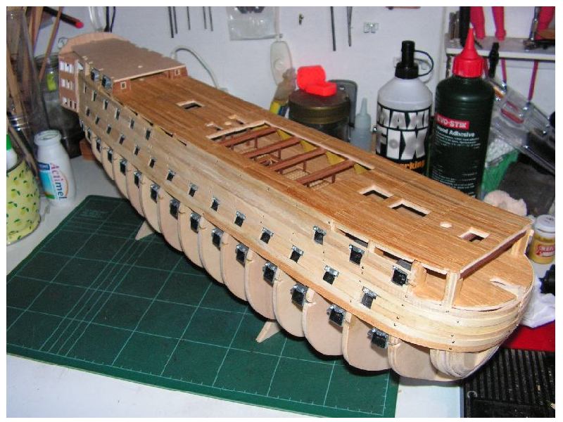

This is the basic hull almost complete. All the wales are in position now, and the first coats of paint are going on, I chose not to use the pre-formed plywood panels as supplied in the kit and instead just carried on the hull planking to cover these areas too. The bulwark sides of the quarter deck have been double planked and the upper hull decorative strips, not supplied at all in the kit have been made up from wood strip (from Cornwall Model Boats) and brass rod (there'll be a closer view of this later).
You can see in this photo that the quarter galleries are missing. Perhaps the worst aspect of this kit was the design of the stern cabin area, the big metal stern plate can be used with some super detailing and careful paint-work but the quarter galleries as supplied are totally useless. The kit actually omits the section of stern immediately below the lowest windows where Victory's name appears and goes straight to the section with the stern chaser ports, all of that would have to be scratch built as the stern build proceeded. The re-building of this section is almost a project in itself and I decided to go the whole hog with interior details and real windows (blue cardboard windows?). The one regret that I have with the stern was that I decided not to fit a multitude of yellow LEDs to illuminate the cabins and hatch ways before I finished first-planking the hull. The result is none of the hours and hours spent on the internal details can be seen without aiming a torch in through the side windows! Still, I know its in there!

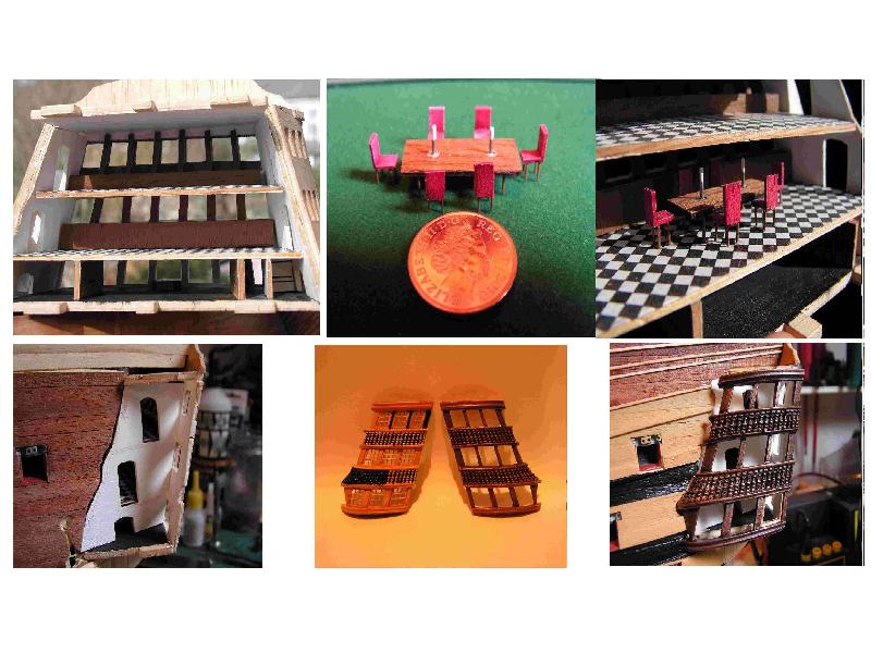

From left to right, top row:
Left: The first completed (or so I thought) stern gallery unit. To the basic kit parts have been added the inner deck walls with the doorways into the quarter galleries, two new decks with chequer-board 'lino' floors (created on my PC, printed on white paper then cut and glued), the wardroom walls and rudder head cover and three little decks inside the quarter galleries.
Centre: The admirals dining table and chairs (1p piece in foreground), the table and chairsare wood with metal staples cut to size for legs.
Right: The table and chairs fitted inside the middle cabin.
Bottom row:
Left: The stern gallery glued into position with the outer walls removed. Once I had decided on purchasing better quarter galleries from CMB and they had arrived it became obvious that they were not going to fit cleanly without a fight! At the bottom left can be seen the routered slot which allows the bottom of the new gallery to fit into the hull, the gap at the top will be filled in with fillets of wood and filler.
Centre: The two new quarter galleries from CMB, the left one has the window frames fitted in wood strip and brass wire and the painting underway, the right one is 'raw' and as supplied.
Right: The raw gallery test fitting.

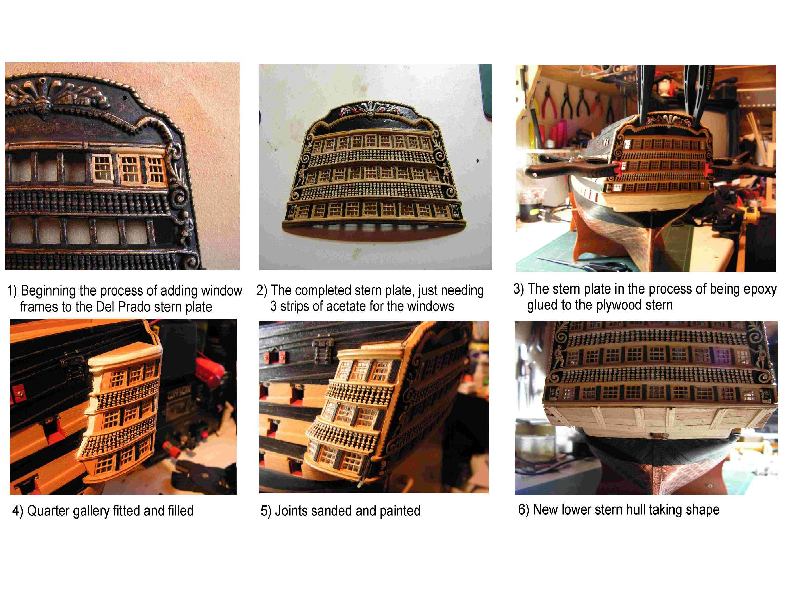

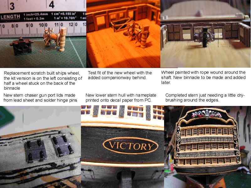

The following set of pics shows the continuation of the stern gallery build. The big metal stern plate as supplied in the kit, although not as detailed as some, is useable with some extra work, namely the addition of some actual window frames and bars instead of simply blanking off the interior with the supplied cardboard backdrop. Each window was first filed to ensure the corners were square, some of them were a little rounded due to the casting process. Each one was then fitted with a wood strip frame superglued into place (God bless the inventor of that stuff!) followed up with 'window panes' from thin brass rod.
The second photo shows the completed plate with all windows inserted and the plate itself painted up. Three strips of clear acetate were then PVA'd behind the windows to form the glass and finally the whole assembly was epoxied onto the kit plywood stern and left overnight to dry, due to the weight of the casting a fair amount of pressure in the clamps was needed.
The quarter galleries were glued into position the next day, and once dry the gaps at the top were filled with thin wood fillets and then a skin of milliput epoxy putty which also forms the continuation of the balustrade moulding. I made up a couple of balastrades slit down the middle to continue on from the cast ones and finally topped off the roof with two layers of shaped plywood.
The final photo shows the beginning of the lower stern which is completely absent from the kit. The inner planking was already on before the stern plate was attached, it was only afterwards that I discovered it didn't actually come out far enough!
What I did forget to mention was that the window glazing in the quarter galleries was made from a product called Micro Kristal Klear, this is essentially a super clear pva which is applied by the point of a cocktail stick and 'skins over' the pane, drying clear as glass. I used this stuff some years ago but when I found the bottle after much searching it was as hard as a rockMad It's still available from model shops fortunately, and there is also another version of the same thing available from Humbrol too.

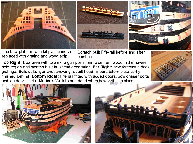

This section shows the re-building of the bow section, this part is now almost finished, I just have to build the first couple of sections of the bowsprit as the first mast part will have to be glued into the hull and 'lashed' down to the keel before I can fit the Marine's Walk in place.
Thanks to the 1805 configuration I was spared having to make the two side fence sections for the foc'sl but I did need to build the Fife rail, this was built completely separate from the hull. To be 100% accurate the curved sections for the carronades should reach right down to the floor beam, I might yet remove them and try again but as my carronades are going to be pointed broadside it doesn't matter so much. The 'gold plated' bulkhead decoration from the kit was discarded and a totally new set built from carved wood for the pillars and curved brass rod for the arches together with open doors and gun ports. the beauty of making those bits separately was that I could paint and dry brush them before pva-ing them to the blue painted bulk head.
The head timbers were scratch built from the Jotika downloadable plans on their website, by sheer chance when I printed them off they were exactly the right size for my 1/100 scale so I just used the print as a template. The curved timbers which run through the head timbers were from curved brass square rod (not a favourite task and I still have the very curved one to join on to meet the catheads!)Cursing
The foremost grating visible in the earlier photos was replaced later when I discovered that the holes in the deck exactly matched the outer dimensions of the stock grating material! I had sanded that first one for ages to reduce its thickness, on the second batch I simply glued a thinner outer frame around the grating and dropped the whole thing into the hole - so much easier!!
The final shot shows the completed Fife rail fitted in place. Why it fitted perfectly in every pre-painted dry run and then refused to go in without popping off one side rail I have no idea! The rail was made up in four levels, the deck beam(s) a line of stumpy posts, the top rail and then a line of chamfered post tops. I found that way easier than trying to make the posts in one piece and filing out gaps in the rail to fit them! Also in this photo you can just make out the crew's heads tucked in the corner by the roundhouses, two more are just out of shot in the foreground.

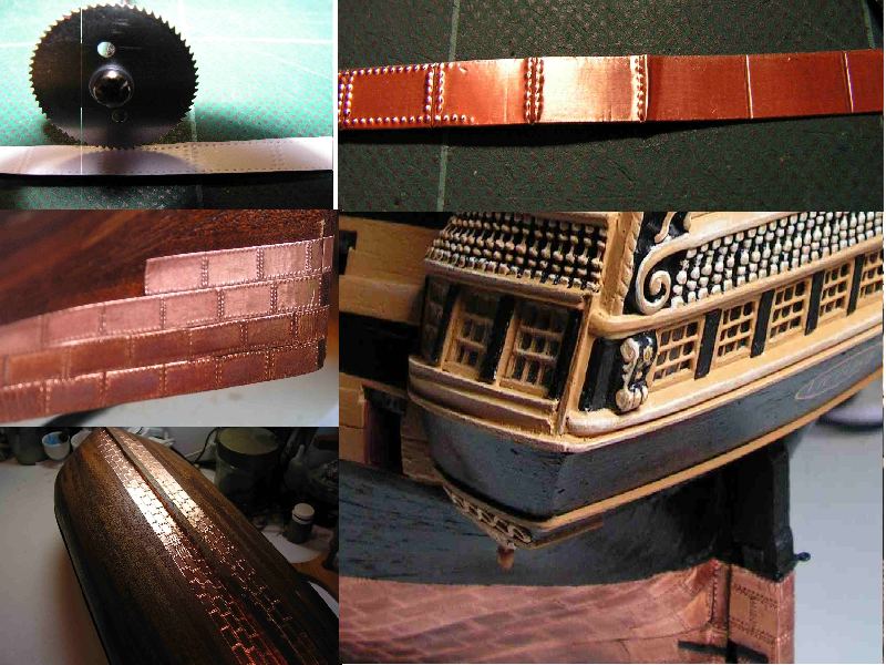

Breaking away from the ongoing upper hull construction for a while, this section concerns probably the best way of improving the look of any wooden sailing ship - copper tiling the lower hull. (At least those wooden ships dating from the time of the introduction of copper sheathing of course, the Santa Maria probabably wouldn't be improved by this!!) Probably thousands of modellers have used this method before me but since it forms an important part of this build I'll put it in anyway in case it might help someone.
The copper tiles were made from simple self adhesive copper tape of the kind used either for anti slug protection or dolls house electric wireing. I bought a pack of five rolls for quite a reasonable price on Ebay but still had to go back for another five later! The rolls were 6mm wide and a few metres long. The first job was to cut off lengths a few inches long and pencil mark them every 12mm. I often work in both metric and imperial at the same time! Once marked the 12mm marks were used to scribe the tape (copper side) with the back of a scalpel blade to form the individual tiles.
Once completed, two lines of rivets were pushed into the copper from the back (backing paper side) with the tip of a fine rat tail diamond file, I did start off doing the long edge rivets that way as well but it was taking a hell of a time and was giving me an aching wrist as well! Then I came up with a much better method using a fine toothed dremel type circular saw, just had to roll the saw on its shaft along the edge of the tape, imprinting the rivets as it went - far easier although still hard on the wrist! The photos below illustrate the procedure...
Top left is the rotary tool circular saw used to produce the rivets along the edges of the copper tape.
Top right is a length of the tape with the three stages of production from right to left, firstly the scoring marks into the copper side to produce the individual plates, next the side rivets produced with the point of a needle file from the backing paper side and on the left the finished plates with the long edge rivets in place.
Centre left and Bottom left shows the stern section before the rudder went on and the first rows of plates starting from the sides of the keel and working out and up.
Bottom right shows the completed coppering at the stern up to the water-line including the added rudder. The rudder hinges are non functional, I glued the rudder on (once completed) with the help of two 2mm brass rods drilled into both the rudder and the keel. The rudder hinges are made from lead tape, embossed with the rivets and pre-painted before supergluing on. Also shows the scratch built lower stern below the galleries. The curved section below the quarter gallery was built up from a sandwich of ply pieces, shaped to fit and each one slightly smaller than the one above. This was then sanded to shape and the 'steps' filled with wood filler before the final sanding and painting. The decorative borders are wood strip and the decoration on the bottom is from thin electrical solder bent into shape around a series of cocktail sticks then slightly flattened, trimmed, painted and superglued in place.

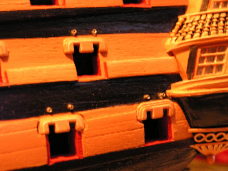

The photo below shows the results of most of the work from the examples above.

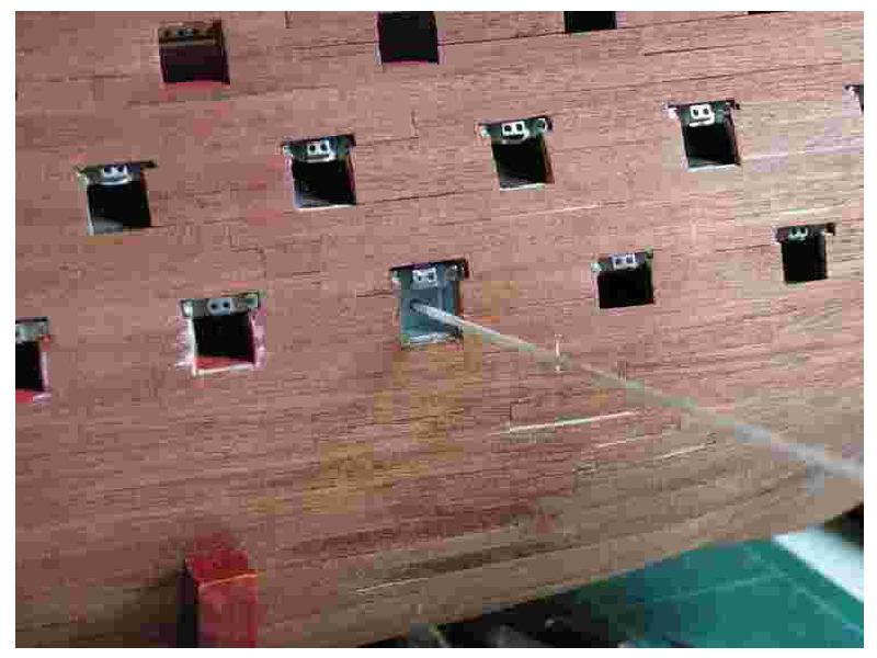

Of the 20 gun ports visible in this picture, 13 have been fitted with their 'lead tube' outlets for the gun lid rope tackle, this is formed from tiny lengths (approx 5mm) of 1mm x 0.25mm Round Aluminium Tube sold in packs of 4 305mm lengths from my local model shop, the pieces were cut to size with a thin cut off disk, the hole cleaned out with the same sized drill as was used to drill the two holes into the hull above the ports. After being tapped into the holes to the desired depth a drop of watery type super glue secures them in place.
The gun ports to the left are still awaiting these tubes although the bottom row has been drilled ready for them.
The finished copper plating can also be seen together with the rudder and its hinges mentioned above.
It was at this point that I discovered the slight (and overlooked) problem with the gun port lids! The lids are designed to close over the embrasures with a very small overlap flush onto the hull, as you can see in this photo however, I cut all the wales to be flush with the edge of the embrasure! This means that if the lids were simply fitted into the hinge holes, they could never shut completely.Blushing
The only way to correct this was to mark and cut back the thin decorative strips and to rebate back into the thickness of the wales to achieve the same aim. Hopefully the next photo will show the result of this extra work. So much for measuring twice and cutting once!!

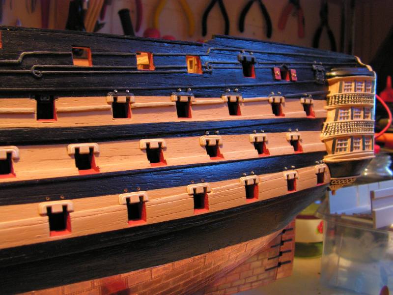

I'm halfway through the gunport drips at the moment, have completed all aft of the entry port on both sides, now working on those forward. Unfortunately my obsession with getting as much superdetailing as possible into the old girl means every little job, even the 'simple if you follow the instructions' ones will take far longer to complete! The visible cannons will be 'tackled up' and in this scale they're too small to use rigging thread so I'm trying to work out a system using thin strands from electrical wire. Then there's a whole multitude of extra bits and pieces to add on the decks (some of them even are bitts!), a glazed skylight, signal pennant lockers, the list is endless!!Crying On the other hand of course, that's the whole point of this hobby isn't it! If we didn't get such pleasure out of creating something better than we were given to work with we'd all be doing something far easier!BigGrin
It will be well into next year before the masts even get a look in, unless I decide to make them (or parts of them) as a convenient break from the hull and the more I think about it, the more appealing that looks!
You're right about the tops however, the kit parts won't be seeing the light of day. I had the same problem with my first ever wooden ship the 'Grimsby' by Constructo, the kit supplied a plywood base for the tops which was then supposed to be planked over with the deck veneer planking, the trouble was the plywood was less than 1mm thick and was already warped to hell! In the end I used my reference book "The 20 Gun Ship Blandford", part of the Anatomy of the ship series which had a very good diagram of how the platforms were made up of individual planks and I followed that, using the plywood originals for the templates to scratch build new tops using the spare hull planks from the kit. I'll be doing the same with the Victory this time around too. I've got a full set of diagrams of the tops in the "HMS Victory, her construction, career and restoration" book to provide the details and a good supply of thin square strips from CMB for the fiddly bits!
Hope you like the photos !
Below is the same area of stern hull showing the now-rebated gun ports allowing the lids to close shut (if they weren't being super-glued open that is!)Flapper

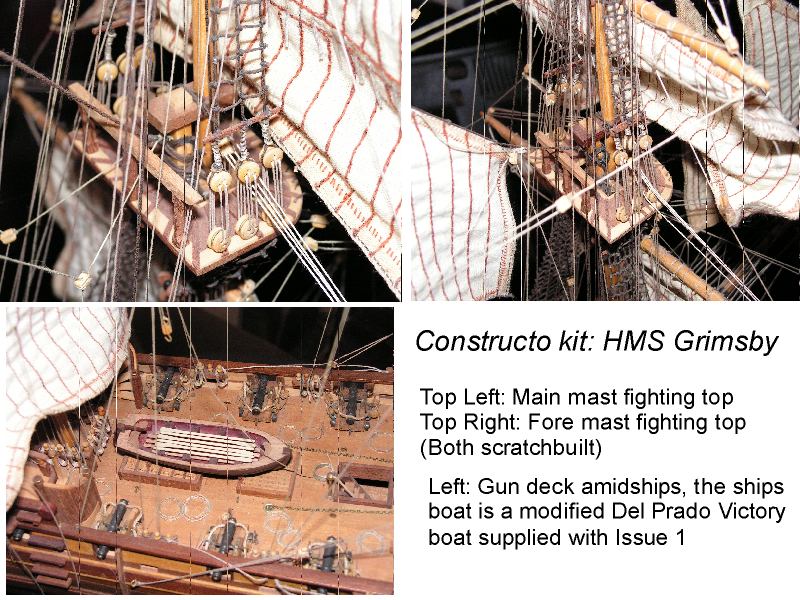

Also below are three photos of the Constructo kit the "Grimsby" showing how the fighting tops will eventually be scratch built (in about 2020 at this rate!)

Sorry about that, just spent nearly half an hour trying to upload two photos without noticing they were still in the raw Corel Print house format!Blushing
