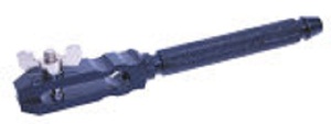

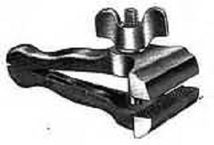

#4 Posted : 30 September 2012 23:27:30
BigGrin Hi
Heres a couple of others that are available at any good tool merchant or online to consider both are around £4 each
jethro
