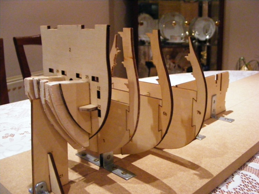

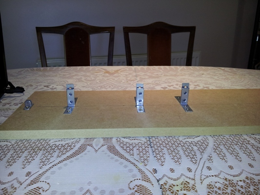

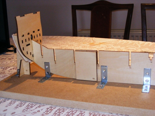

Ok, now that I have a better idea of how all this works the build diary now starts in earnest. First problem I encountered was the belief that the keel was flat and true yet whenever it was placed in the dry dock it looked warped... everything was checked and couldn't find anything wrong until I looked at the dry dock itself... Base board had a very slight bow in it that wasn't easily apparant. New dry dock had to be constructed..
Have also used the keel support provided in issue 3 and now I know everthing is lining up as it should...

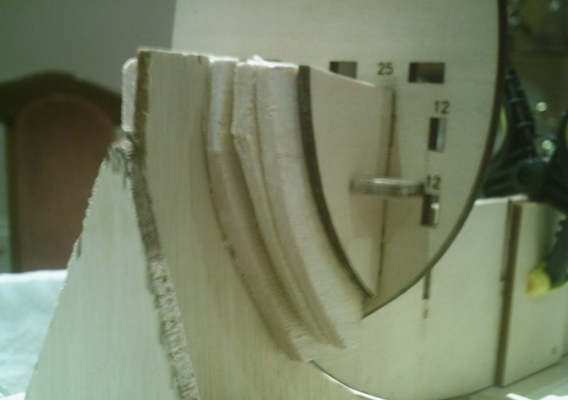

Balsa has been packed in between the bow formers, roughly cut and glued in place. Intention is to pack as much as the hull as possible with balsa to give it additional strength and to make the business of shaping and planking a lot easier.
That's it for now, now that I am confident the keel is set correctly am about to glue in place some more ribs....

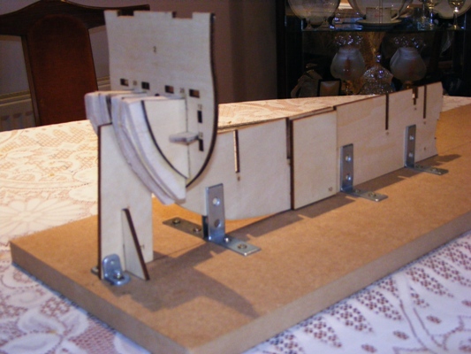

Continued to attach the ribs, first lightly sanding all the loose black ash off, glued in place with PVA ensuring everything was square on all planes.. Have to wait now for issue 4 to continue with the ribs so in the meantime will continue to work on the cannons and anchor, hopefully publishing results soon....
