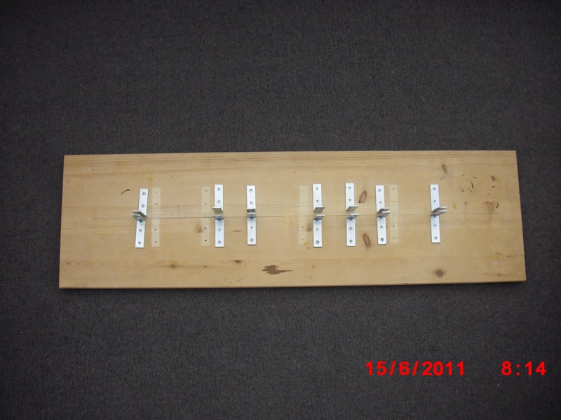

Here's the one I built. Of course you can only use it up to when you plank the hull but then it can be converted to use for the masts (thanks to Cerri). There are more sophisticated versions out there but this does the job for me.
Dry dock
I then put this together for working on the hull and it's time will be over when the coppering is complete.
Jig for the hull
Hope that helps.
John

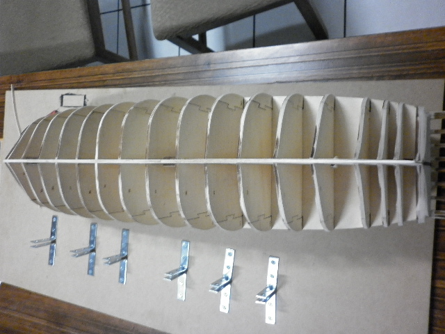

#7 Posted : 13 August 2012 11:17:14

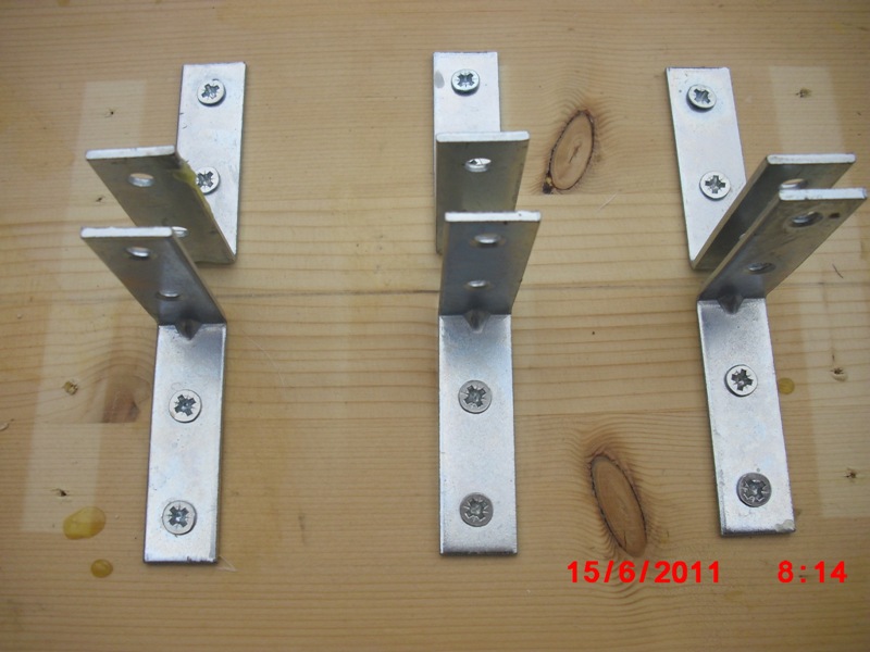

Hi here are some photos, you just need a level board and some angle brackets Regards Mike

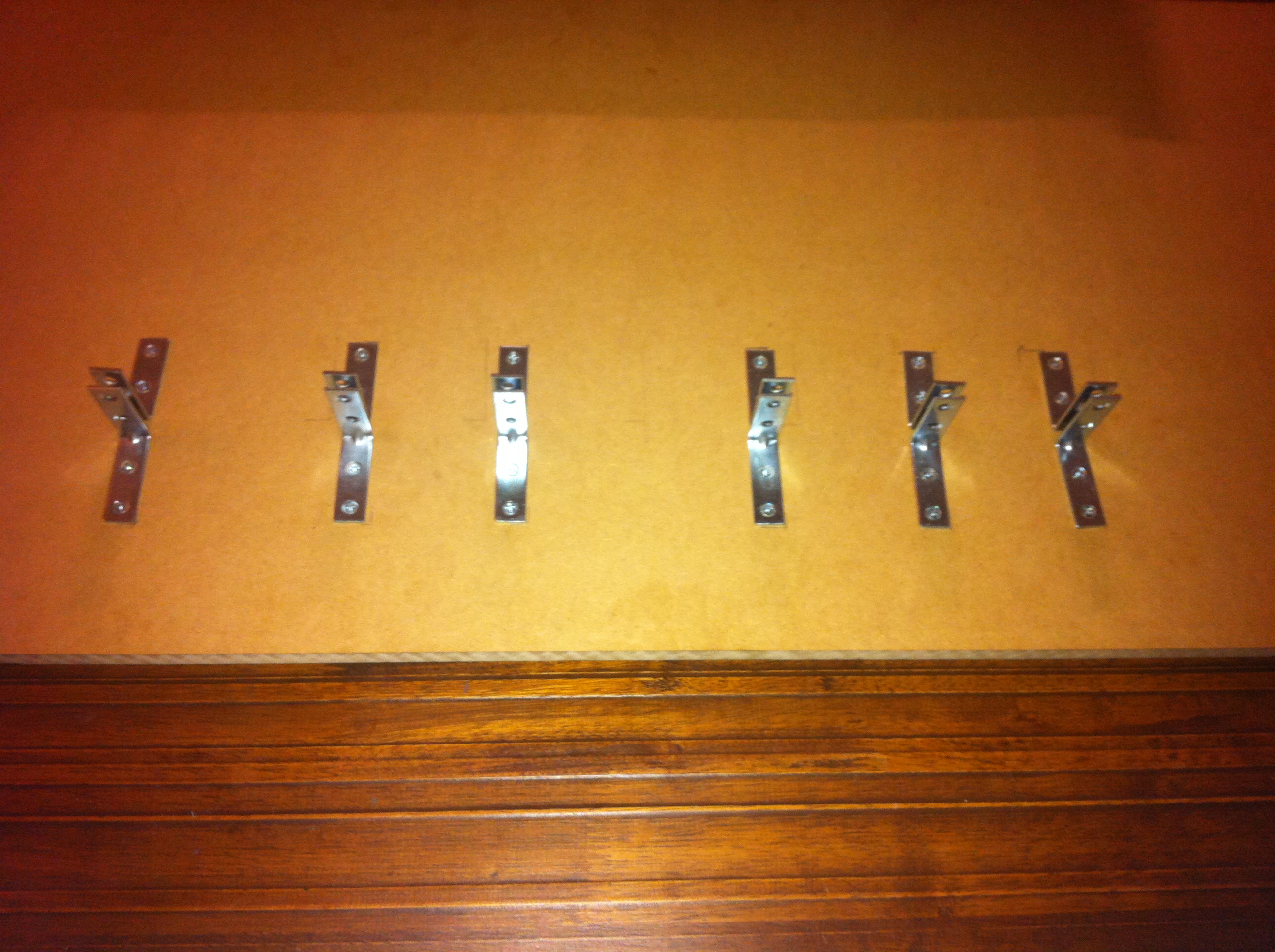

#9 Posted : 16 August 2012 14:16:16
Joined: 09/08/2012
Posts: 59
Points: 163
Location: Darwin
Hi Guys,

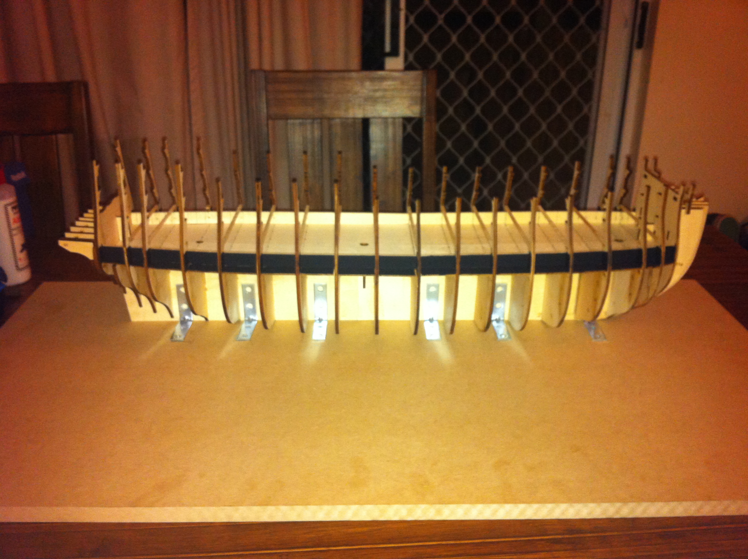

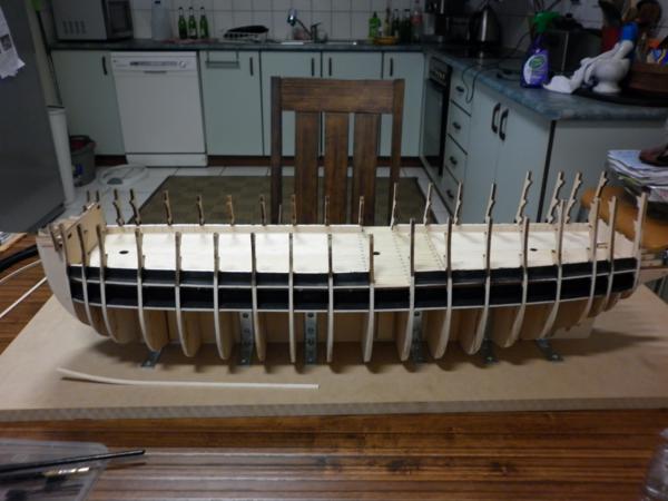

Big thanks to Mike, John and Peter for the pics with the dry dock. I have now been able to build my own. First rookie mistake was to buy brackets with 20mm screws then buy some mdf board without checking the depth, yep 16mm. lucky I only tried a few screws and didnt damage the dining tableLaugh . Second trip bak to the hardware store with the right screws this time and a bit of sandpaper to get rid of the mdf that got punched through and this is the final result. Thanks for the info on the dry decks warping, they have now come good.
Cheers GuysCool
Cheers Tony
Current Build
HMS Victory, HMS Victory Cross Section
#10 Posted : 16 August 2012 15:19:36
Tigershark wrote:
Hi Guys,
Cheers GuysCool
Spot OnBigGrin ThumpUp Regards Mike

Hi Tigershark and welcome aboard. That's one hell of a dry dock you've got there? Great job and a perfect work area all built in!! Looking forward to seeing your build progress. Happy building...

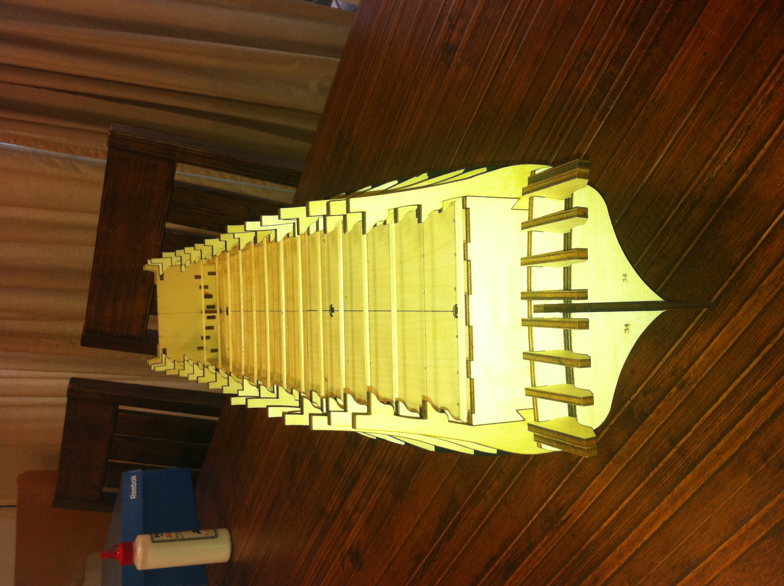

Tigershark

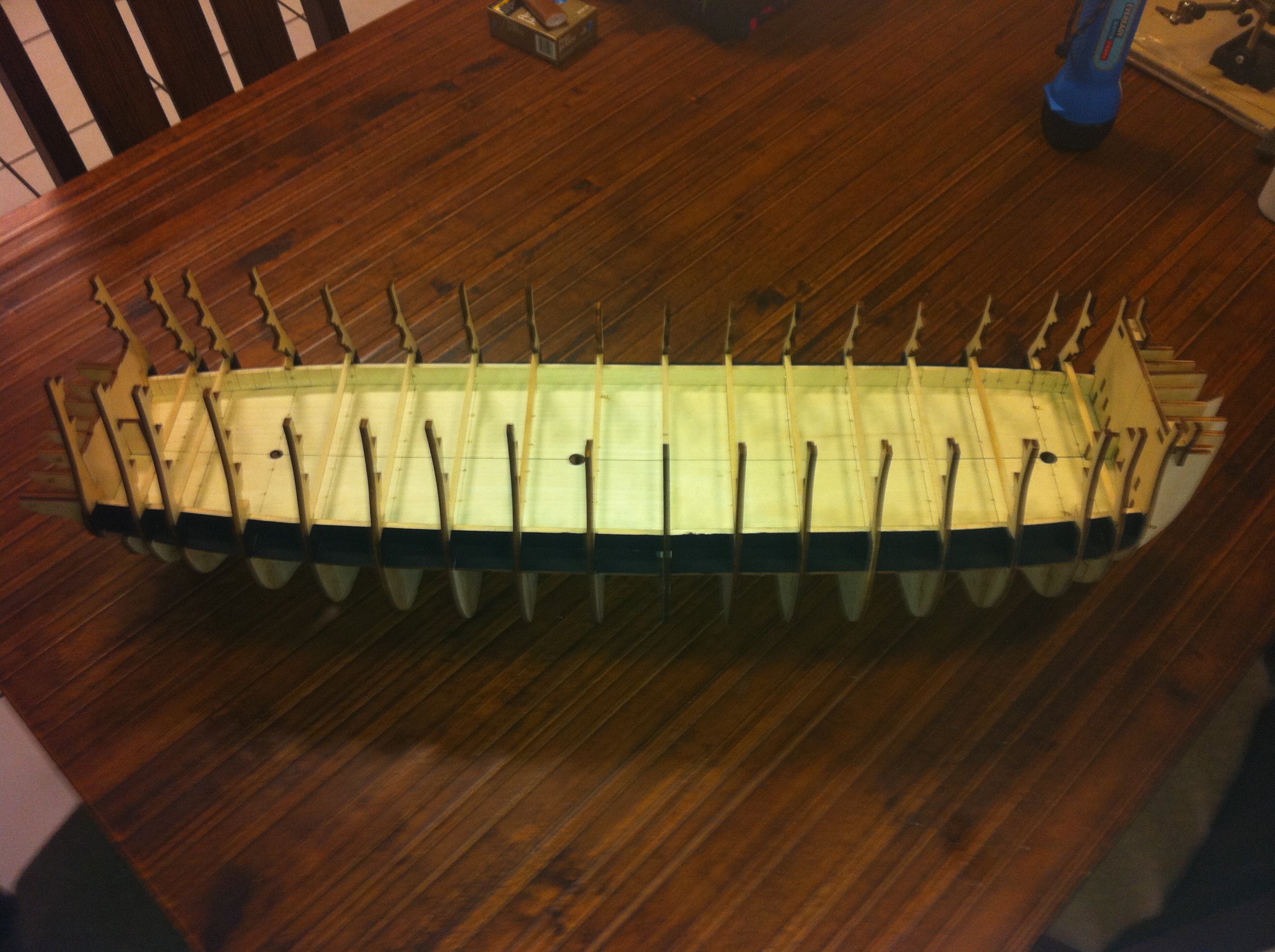

#12 Posted : 03 September 2012 04:04:03
Joined: 09/08/2012
Posts: 59
Points: 163
Location: Darwin
Hi all,
Have tried to resize my photos here, just trying them out to see if they fit, Have managed to assemble the second deck and am now fairing the hull. Will post some more pics later!
Tigershark attached the following image(s):
Cheers Tony

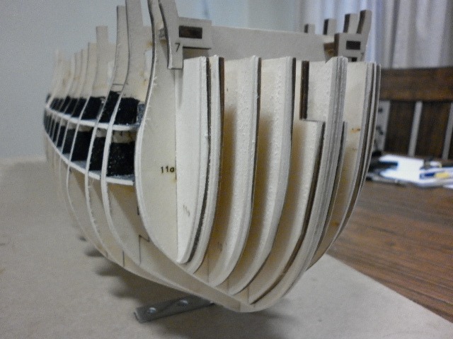

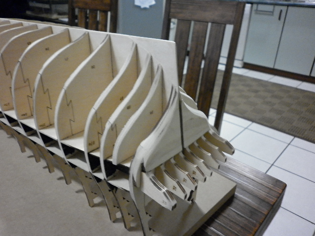

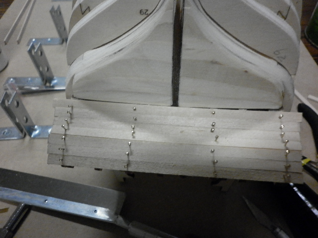

#15 Posted : 07 September 2012 05:27:03
Joined: 09/08/2012
Posts: 59
Points: 163
Location: Darwin
Hi to all my fellow shipwrights

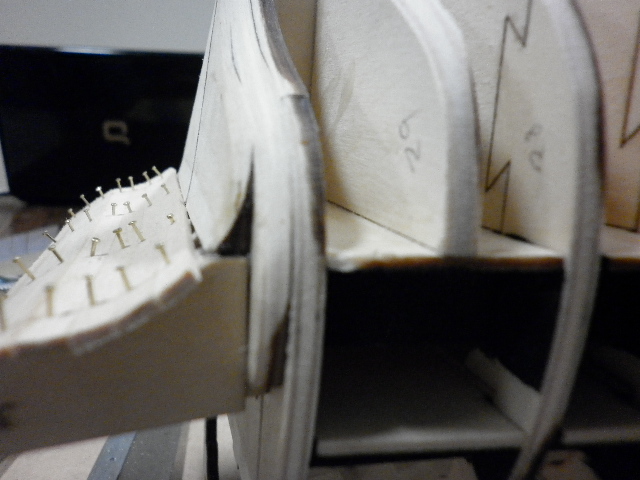

Have now finished the fairing of the hull (whew) took me a while, I still need to build up the infamous rib 15 but will do that a bit later on.

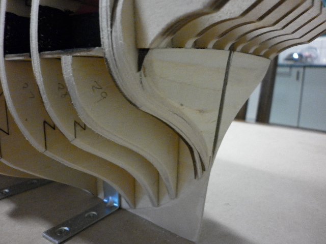

One item I need help with though is the planking of the stern gallery supports. In Tomick's origal build diary and the magazine it looks they have planked 5 planks altogether on the concave part, I have finished at only adding 4 planks and although there is a slight gap along the outer edge of the stern rib 34 is this ok? or do I need to add another thin plank. I have checked some other build diarys and they have seemed to got away with four planks as well. The only reason I am asking is if you look side on the planks are parallel with the bottom of the gun and I am happy with this.
To add or not to add?
Cheers Tony
Current Build
z8000783
#16 Posted : 07 September 2012 07:15:57
Groups: Unapproved
Joined: 24/05/2010
Posts: 1,761
Points: 5,351
Location: London & Greece
One item I need help with though is the planking of the stern gallery supports. In Tomic's origal build diary and the magazine it looks they have planked 5 planks altogether on the concave part, I have finished at only adding 4 planks and although there is a slight gap along the outer edge of the stern rib 34 is this ok? or do I need to add another thin plank. I have checked some other build diarys and they have seemed to got away with four planks as well. The only reason I am asking is if you look side on the planks are parallel with the bottom of the gun and I am happy with this.
Hi Tony
It's not easy to see from the pictures but you might not have completed the fairing on the last rib enough. The rib should go all the way back to the false keel. In fact you take it down to almost nothing. That should give you enough room for another plan then. Have a look here.
John
Tigershark
#17 Posted : 07 September 2012 07:28:18
Joined: 09/08/2012
Posts: 59
Points: 163
Location: Darwin
Thanks John
I thought i was ok, but looking back at it I could probably shave another 1mm towards the top of rib 34, will give this a go.
Cheers Tony
Current Build
z8000783
#18 Posted : 07 September 2012 07:30:13
Groups: Unapproved
Joined: 24/05/2010
Posts: 1,761
Points: 5,351
As I said, you need to take it back to the false keel so that the rib is flat rather than bowed. Good luck.
John
#19 Posted : 07 September 2012 10:14:20
Hi Tony, your build is looking good, if you could sand rib 34 so you can not see the ash on the false keel you will be spot onBigGrin ThumpUp
farrabass
#20 Posted : 07 September 2012 15:14:35
If you don't mind me adding my tuppence worth, try and get as smooth a curve as you possibly can, as when you come to add the curved tapered planks they have quite a sharp bend to cope with, and the smoother the bend the better chance you can get them round without them snapping. I also suggest that you have a good look at how Son of Bulwark did his, he posts some very informative information covering all aspects of this build.
Good luck with your build, Steve..
