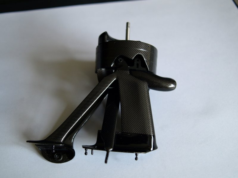

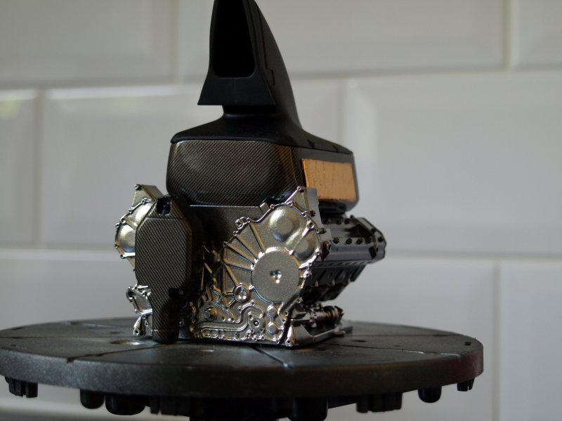

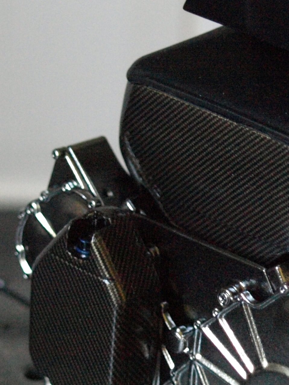

As some of you are finding out that carbon decals come in many forms, different weaves and colours etc. What I intend to do here is show you the types of decals and links to where you can get hold of them and the correct weave and scale plus a few tips to get the same effect with out having to splash out on a new sheet etc..
First off we have the twill weave which a lot of us will or have been using but by giving the area that the carbon is to be aplied too a different colour then we can see how this can be used on the model you are building.. The second picture is the same carbon Decal but aplied onto a GOLD background giving a different effect seen for example on the inside of the cocpit area of the McLaren..
The decals shown here are 1/12th from scalemotorsport and are the twill pattern..
Attached is the original image for clarity...

Did you apply any type of lacquer over them
#5 Posted : 04 July 2012 00:14:02
Yes Scott.. I used Halfords Clear lacquer in 3-4 light coats and 20 mins inbetween each coat..

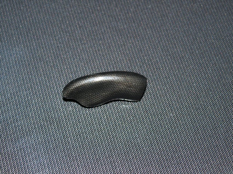

The Carbon used here is called Carbon Mesh and is used on smaller structures where strength is not a priority. This Decal is from Studio27 and once again is in 1/12th scale (part no FP0003)
The Decal sheet underneath is carbon Composite fibre from scalemotorsport but I have not had very good results with this as its too brittle and breaks up easily.. maybe a bad batch but not worth the money in my oppinion.
The second picture is both Decals being used on the front suspension on a black background/surface
