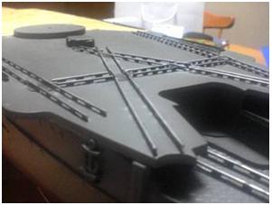

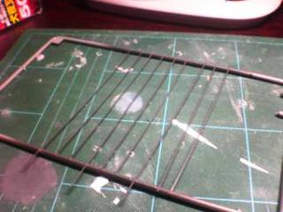

At this time I introduce the enhancement of rails on aircraft deck. Pieces of plastic sheet were attached on 1mmφ plastic rods (1st picture). They were painted in gunmetal (2nd picture) and attached on the deck (3rd picture).

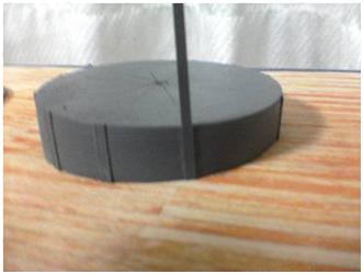

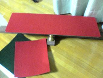

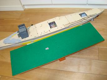

This time I introduce about display stands. Display stands were provided with the Yamato and the Akagi models from DeAGOSTINI Japan. They were the same structure that each model was set on 4 supports of the stand.
Some Japanese builder were afraid that the model’s weight divided among the 4 supports were too large especially the Yamato, because she had a mount of metal parts on the plank deck. They guessed the strong force will turn harmful influence to the wooden hulls in the long term. As it was expected to be better that the weight of the model had to be supported by a plane than by points, some builders reported they remodeled the display stands.
I also did it. I glued the planks on the supports of the stands. Felts pasted on the planks made the stands look much better. (1st picture is for the Yamato, 2nd picture is for the Akagi )

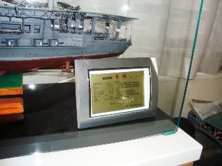

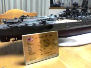

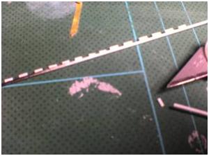

This time I introduce making the specification sheet.Cool

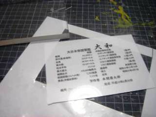

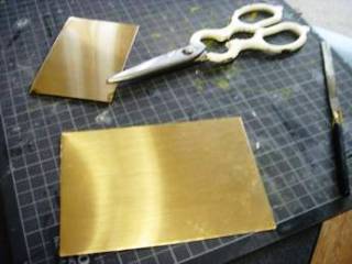

At the near end stage of the 90-weeks part work DeAGOSTINI Japan announced us to sell the brass specification sheet with the builder's name on it. Since it was too expensive for me to buy it, I made the sheet by myself.
#1 An advertisement from DeAGOSTINI Japan

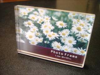

#2 Select a suitable photo frame in the market
#3 Cut brass panel in the same size of the frame
#4 Print the table with data and my name on clear sheet
#5 Combine them
#6 Display it by the YAMATO
#7 This method is applicable to the Akagi.Laugh

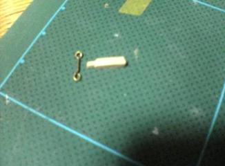

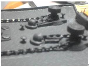

This time I introduce the enhancement of heads of anchors. Although hose pipes were closed in this model, heads of anchors were attached at the hose pipes on the bow deck at least. Assemble anchor heads by 0.5mmφ brass wire and plank that was the same size as original anchor part (1st picture). It was painted in gray (2nd picture) and attached in hose pipe with cable (3rd picture).

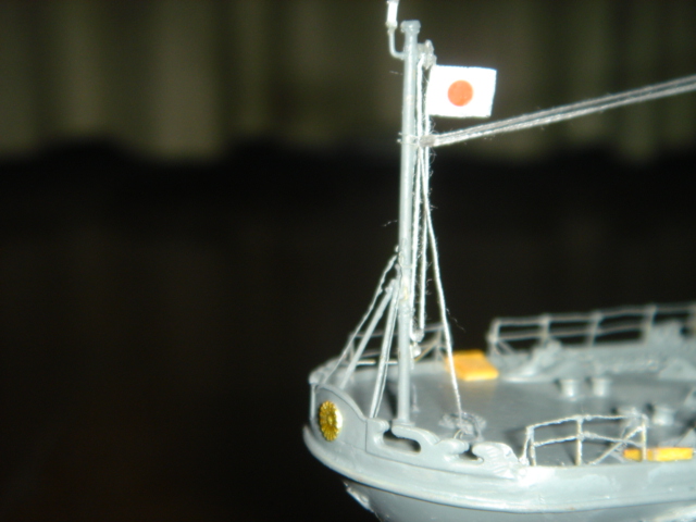

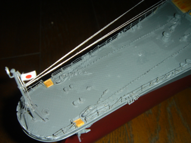

I attach two pictures of my model's bow for your reference. I am glad if you are interested in them.
Best Regards
Yutaro.

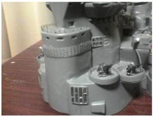

This time I introduce the enhancement of turret supports of main guns. It is very simple.Cool Attach plastic sheet painted in gray at the side of the turret.

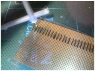

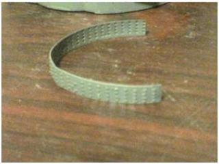

This time I introduce the enhancement of supports of the bridge by using the method for representation of rivets.

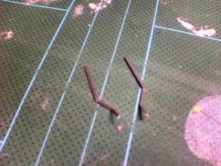

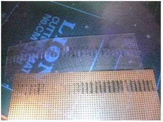

#1 Prick plastic panel with a needle under the guide of the mesh
#2 I expect that their reverse side seemed like rivets, didn’t it?
#3 It was cut in a belt shape and painted in gray
#4 Attach it on the bridge
To tell a truth, the plastic panel was taken from a plastic case of the YAMATO parts from De AGOSTINI.Blushing
Best Regards,
Yutaro

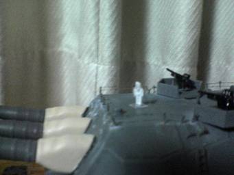

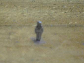

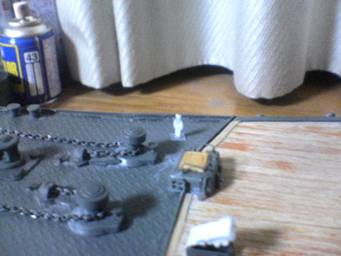

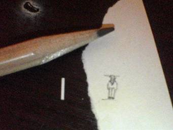

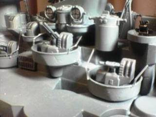

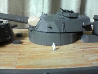

#1 Draw a 7mm height sailor on the paper. 7mmx250=175cm I calculated that this scaled picture of the sailor is almost the same height as real one.
#2 Cut out it and glue it on a piece of clear plastic to let it stand.
#3 Put it by the main gun turret.
#4 Put it on the main gum
#5 Put it on the bow deck
Although it is just a child play, I expect you to feel a size of the YAMATO.LOL

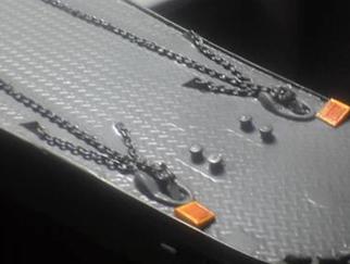

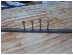

At this time I introduce the break cocks of cable holders. 4 pieces of thin 3mmφ plastic rod were glued with 1mmφ plastic rods and painted in gray (1st picture). They are attached on cable holders and deck (2nd picture).

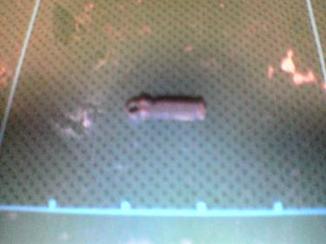

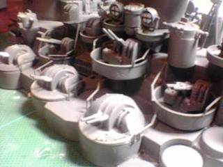

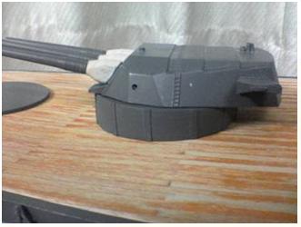

This time I introduce attaching limit stops around the guns. These parts protected the bridge and other structures from the miss shoots of her guns.Cool
#1 Paint the plastic sticks in IJN gray.
#2 Assemble the limit stops. I refered to the photos of 1/10 Yamato and made the form of the limit stops It is necessary to make them symmetrical..
#3 Attach the limit stops around the guns.
#4 Other guns with limit stops.
