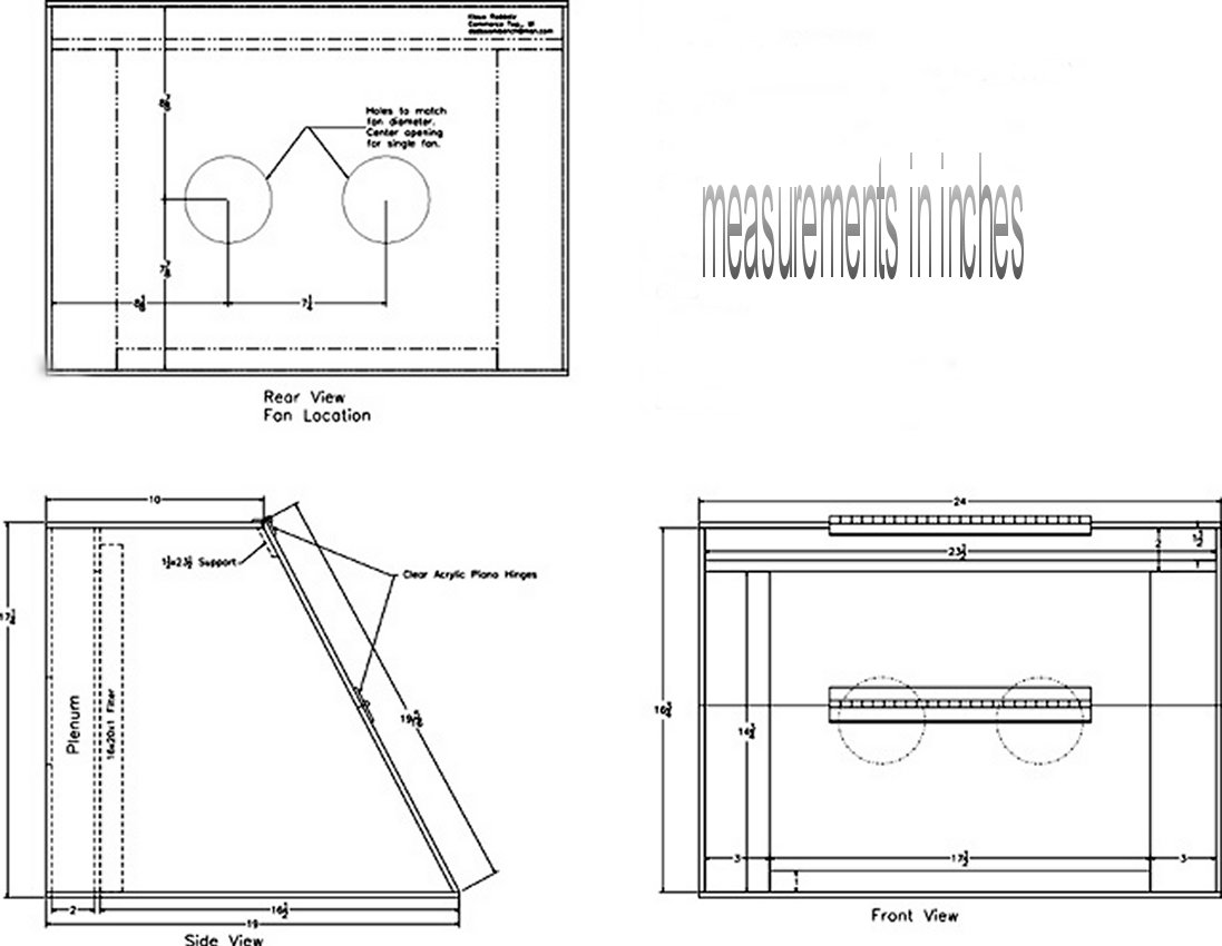

Hey guys,
Question for the airbrushes of you,
Do you use a spray booth and if so is it a commercial one or homemade?
Looking to sort myself out with one whether it be buying one or making one myself.
Leave me/us your thoughts
Cheers
Danny

You can make a spray booth from a good size cardboard box with some kind of extraction filter/vent on the back so it can be cheap or you can go down the expensive road of buying a custom one...or Find an old oven hob extractor with filter compartment and make a simple box from wood.. get a lazy susan ( no offence to anyone who has a partner/wife of the same name BigGrin )for the turn table so you can get acces from all sides..
plonk the extractor on top and you have a good booth..
Google "scale modeling spray booth plans" and you will have enough to choose from..

I was thinking of using some plywood, making the box, for the fans I was thinking of using 2 maybe 3 CPU fans from a computer (cheap and pretty powerful) and then a filter from a air conditioning unit.
The only thing I am a little bit concerned about is the electrics, Im by no means a whizz with these at all.

The fans you will need are maybe 5" case fans and if you have an old PSU from a desktop comp then that will power them.. just a cheapo one from pcworld but with an on/off switch on the back..
As mentioned above just google "spray booth plans" to give you an idea Dan

as you will need a pc fan why not use the case of an old pc? just take out the inners you already have the fan plus switch just need a bit of perpex for the front and bingo!and don't forget to reverse the fan.
#8 Posted : 16 May 2012 16:28:40
You might want also to consider adding a flexible hose vent kit to the extractor unit, similar to that which might be used to vent a tumble dryer, that way harmful paint vapours can be directed out of a window or via an extractor fan.

Thanks for the advice guys... Karl very good idea, just one issue.... I dont have a space PC! I use Mac's so there all built into one unit.... I have some plywood laying around though, so Ill use that. Top idea though!
My feelings now are plywood box, one extractor fan as you would find in a bathroom, under cabinet strip light and a filter screen with a dryer hose out the window.
Now, time to plan and measure up!

hi Dontshootme,I was thinking of removing everything including the psu,and reversing it and screwing it back on the outside so it draws instead of blowing,also the cpu's fan can also be utilised to draw.
