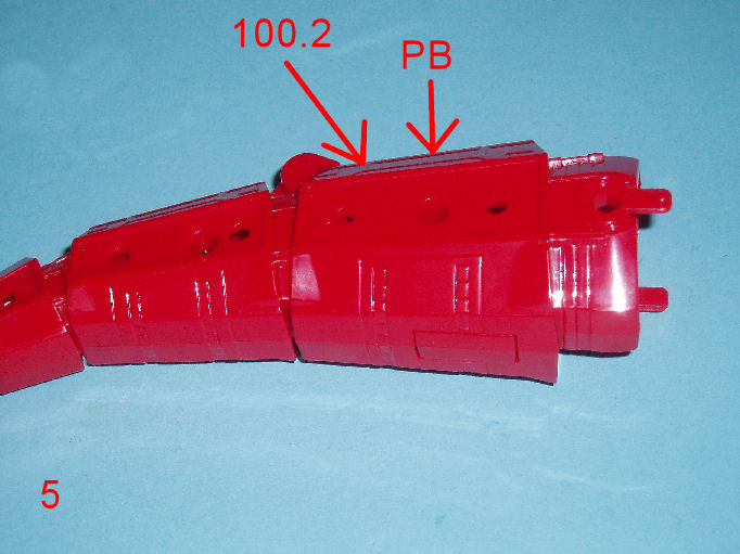

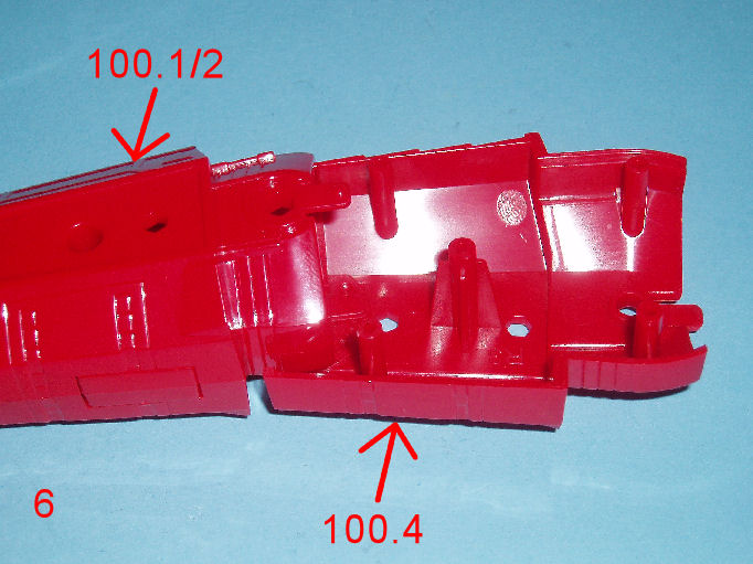

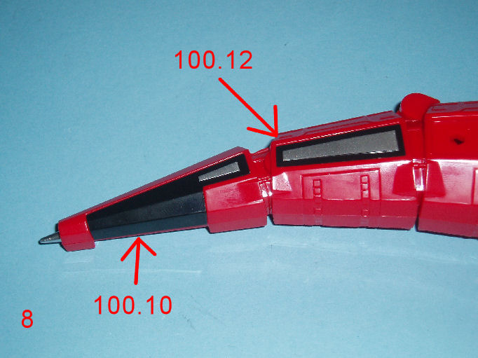

STAGE 100:

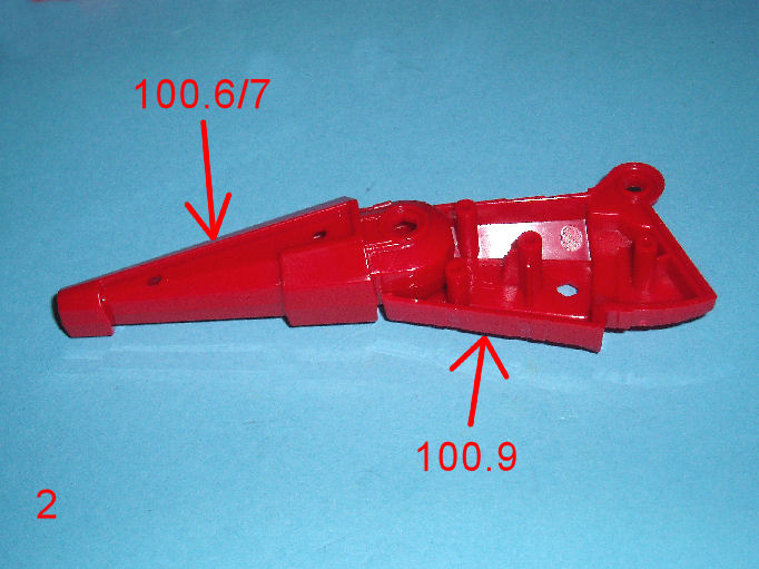

Tyrannosaurus tail 1.

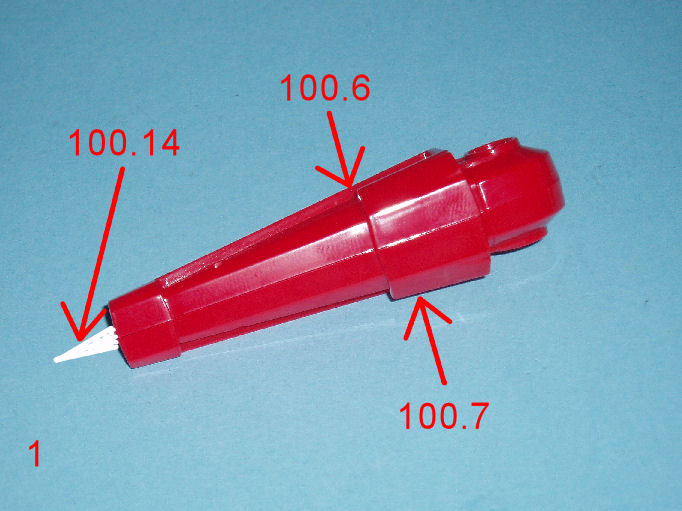

Pic 1: Press-fit the tail parts 100.6 and 100.7 together, trapping the point 100.14 in the end.
Pic 2: Fit the lower tail part 100.9 to the assembly as shown.

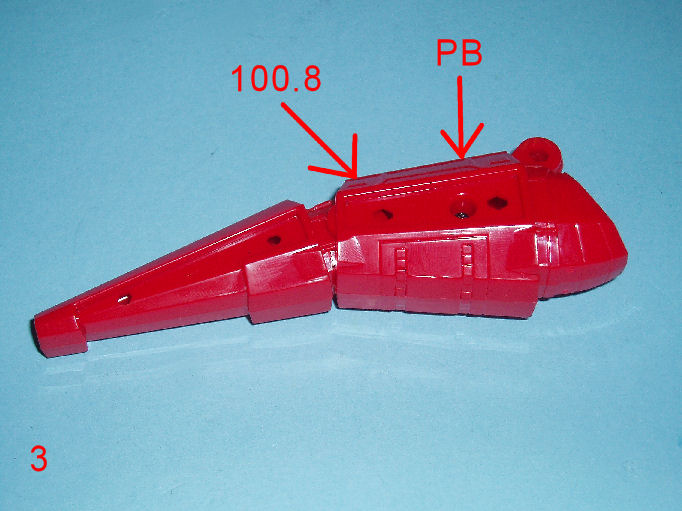

Pic 3: Fit the upper tail part 100.8 and fix with 1 x PB screw through the central hole.

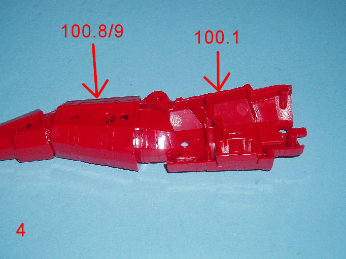

Pic 4: Fit the lower tail part 100.1 to the assembly as shown.
Pic 5: Fit the upper tail part 100.2 and fix with 1 x PB screw through the central hole.

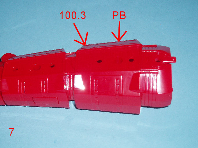

Pic 6: Fit the lower tail part 100.4 to the assembly as shown.
Pic 7: Fit the upper tail part 100.3 and fix with 1 x PB screw through the central hole.

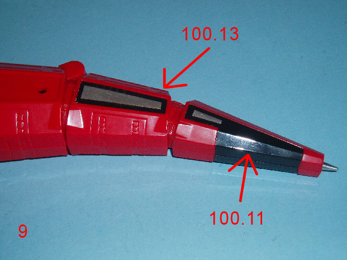

Pic 8: Press-fit the trim pieces 100.10 and 100.12 into the tail.
Pic 9: Press-fit the trim pieces 100.11 and 100.13 into the other side of the tail.
Store the assembly safely.
