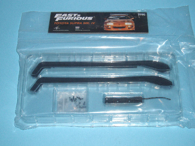

STAGE 23:
Chassis reinforcement.

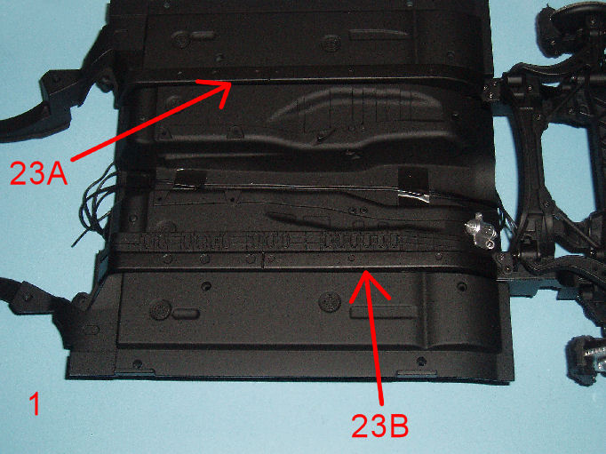

Pic 1: Fit the chassis reinforcing rails 23A and 23B as shown.
They will only fit one way.

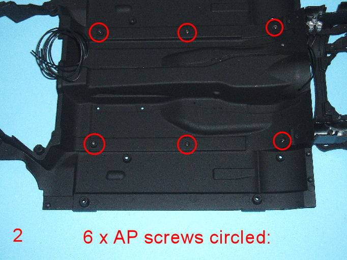

Pic 2: From the other side, fix with 3 x AP screws in each.

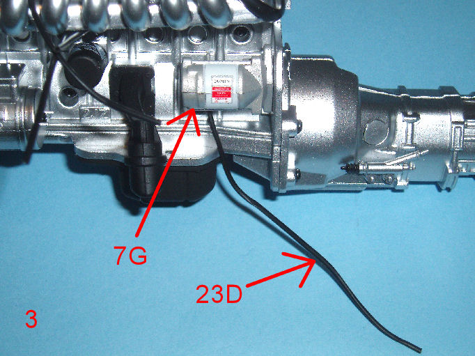

Pic 3: Fit the battery wire 23D to the pin underneath the starter motor 7G.

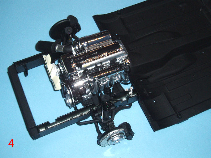

Pic 4: Retrieve the chassis assembly and fit the engine in place between the front side frames as shown.

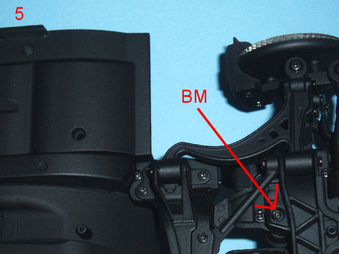

Pic 5: From underneath, fix the right side of the engine to the chassis with 1 x BM screw.

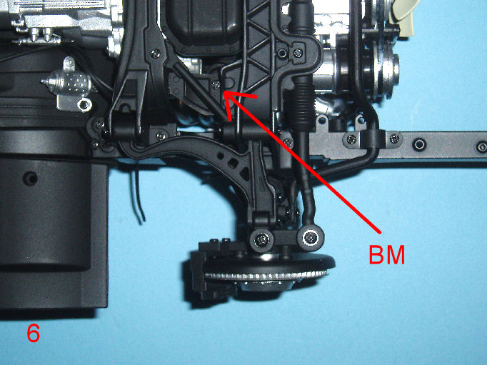

Pic 6: From underneath, fix the left side of the engine to the chassis with 1 x BM screw.

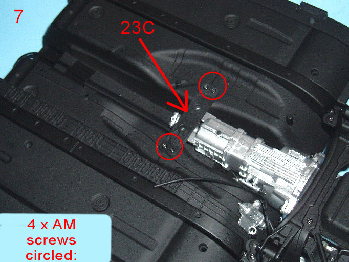

Pic 7: Fit the transmission support 23C in place and fix with 4 x AM screws.

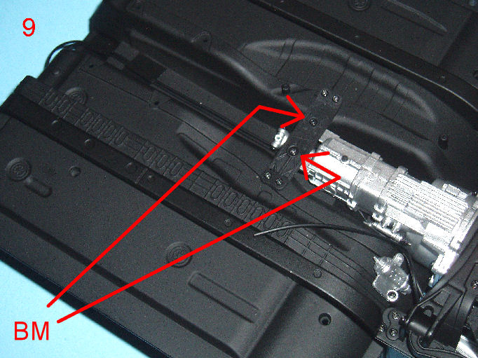

Pic 8: Secure the gearbox casing using 2 x BM screws.

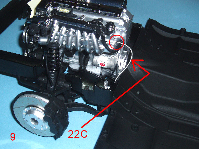

Pic 9: Connect the end of the fuel line 22C (highlighted in white for clarity) to the pin on the end of the injector rail.

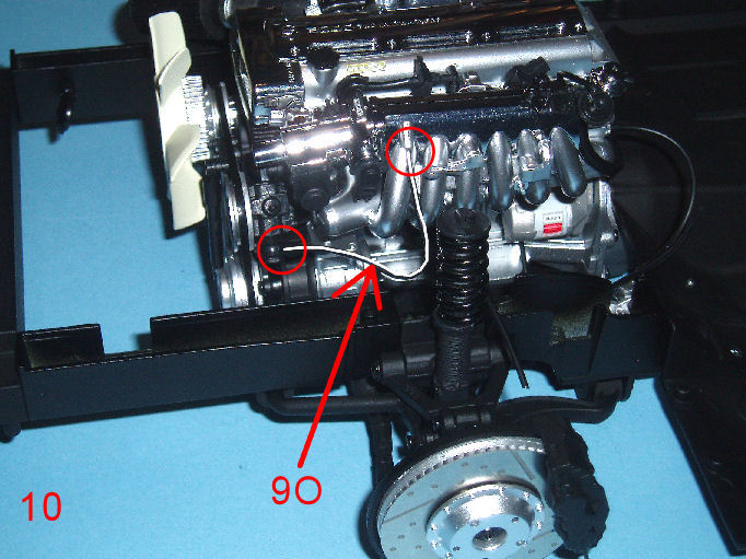

Pic 10: Connect the end of the duct 9O (highlighted in white for clarity) to the pin on the side of the steering pump 14P.

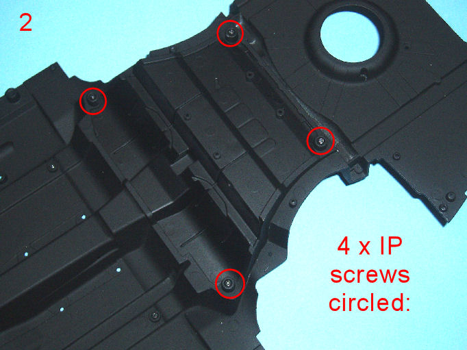

STAGE 24:
Chassis rear reinforcement.

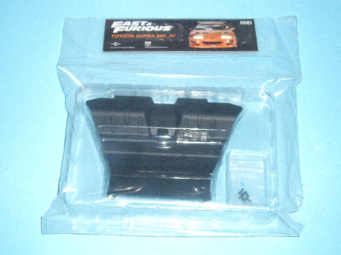

Pic 1: Fit the rear chassis panel 24A to the main chassis 22A as shown.
The part needs to be fitted from underneath.
Pic 2: From above, fix with 4 x IP screws.
Store the model safely.
