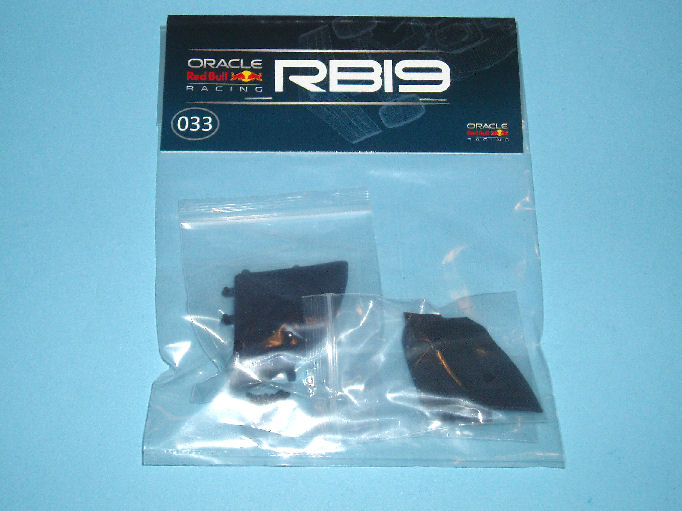

STAGE 33:
Front bodywork 3.

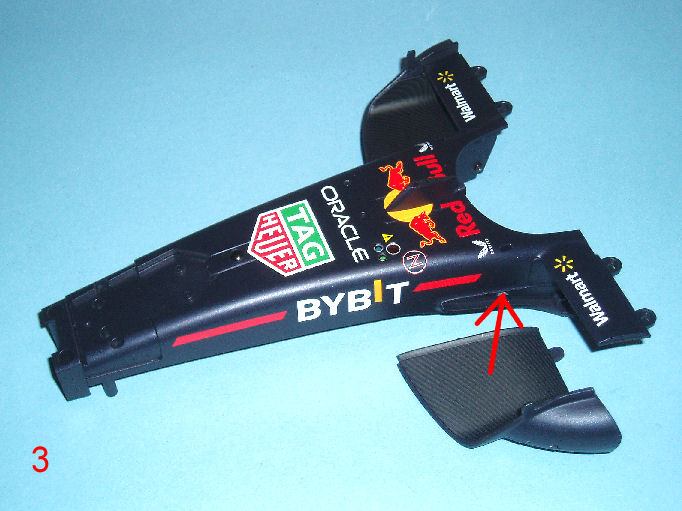

Pic 1: Locate the left air intake parts 33A and 33B.
33B will fit on top of 33A.
Pic 2: Shows the parts assembled.

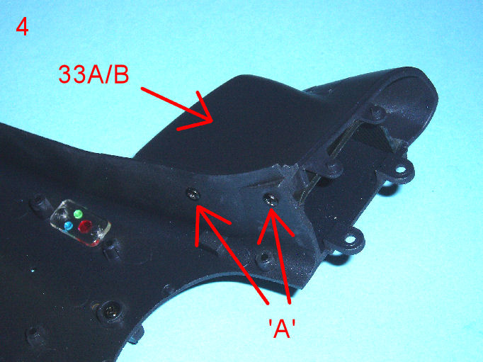

Pic 3: Retrieve the front body to fit the intake.
Pic 4: Fit the intake 33A/B in place and fix from the inside with 2 x ‘A’ screws.

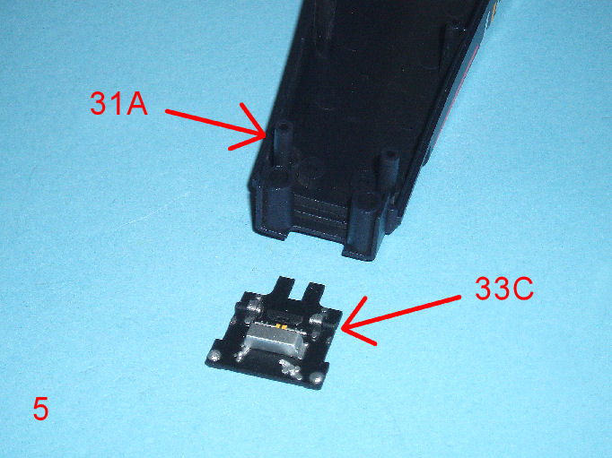

Pic 5: Turn the body 31A over and locate the steering plate 33C.
Pic 6: Fit the steering plate 33C into the body 31A as shown.

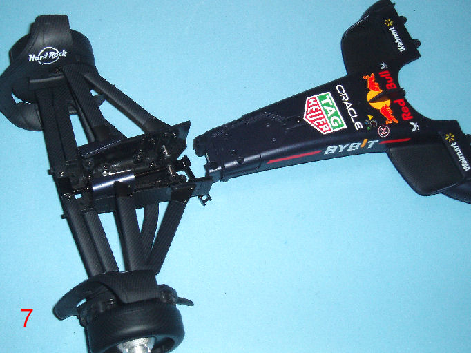

Pic 7: Retrieve the front steering/suspension assembly.

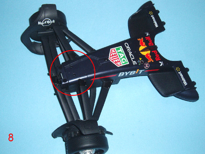

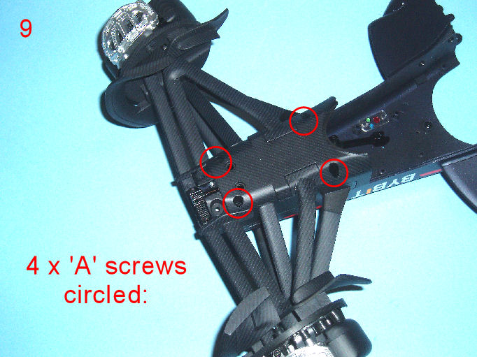

Pic 8: Fit the upper body in place over the suspension assembly, with the body located under the upper suspension arms as circled.
Pic 9: Turn the assembly over and fix the parts with 4 x ‘A’ screws.
Store the assembly safely.

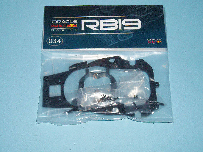

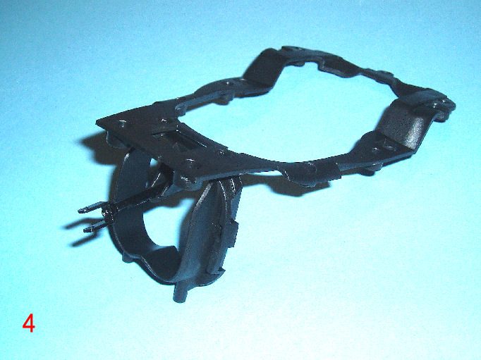

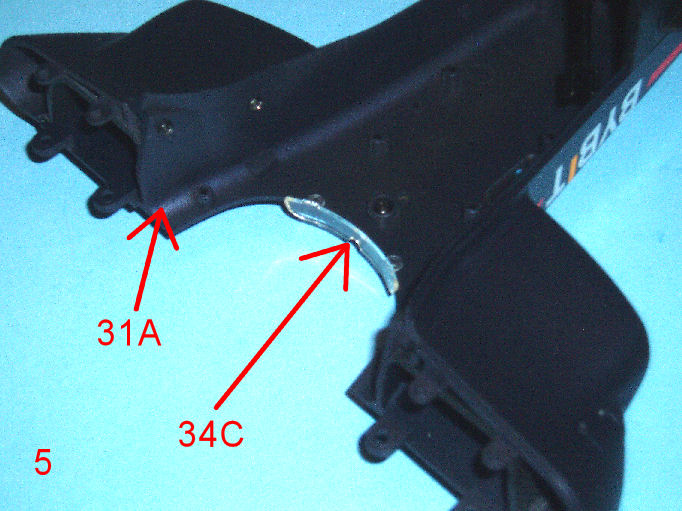

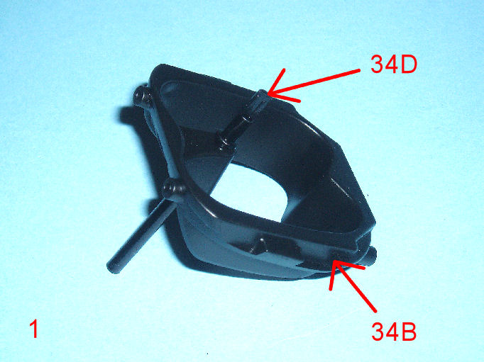

STAGE 34:
Front bodywork 4.

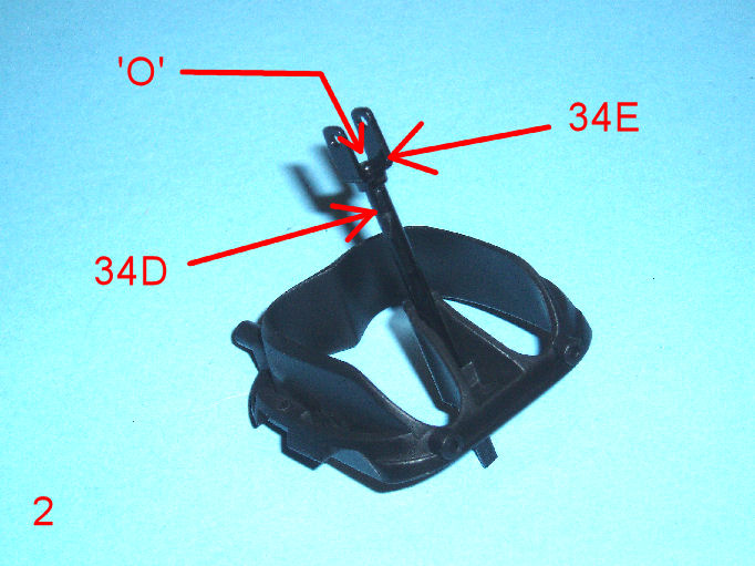

Pic 1: Fit the steering shaft 34D through the lower frame 34B as shown.
Pic 2: Fix the fork 34E to the end of the shaft 34D with 1 x ‘O’ screw.
Pic 3: Fit the lower frame 34B to the upper frame 34A and fix with 2 x ‘G’ screws.
NOTE: The printed instructions incorrectly show the fixing holes at the front edge of the upper frame.
Pic 4: A different view of the assembly.
Pic 5: Turn the upper body 31A over and fit the screen 34C in place.

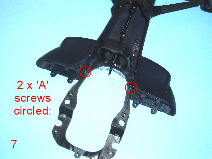

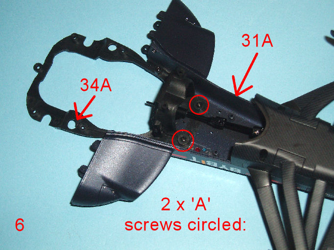

Pic 6: Fit the upper frame assembly 34A/B to the upper body 31A and fix with 2 x ‘A’ screws where shown.
Pic 7: Fix the parts with two more ‘A’ screws.

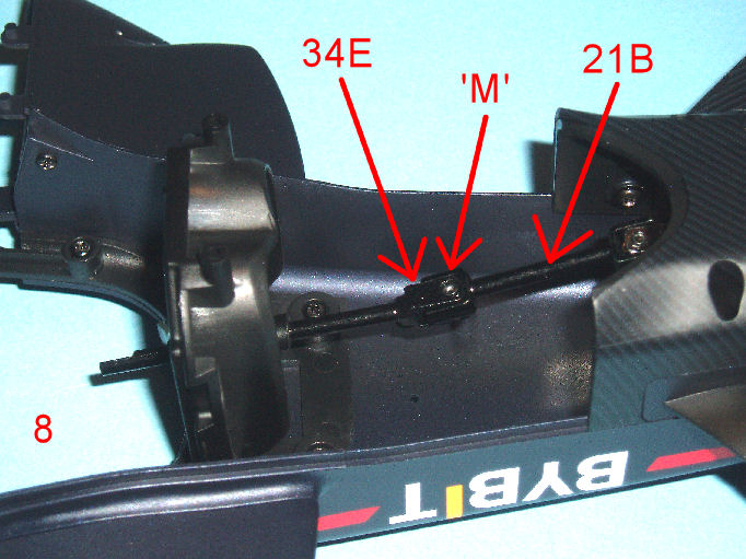

Pic 8: Fit the steering column parts 34E and 21B together and secure with 1 x ‘M’ screw.
Pic 9: Fit the compartment support 32C saved from stage 32 in place where shown and fix with 2 x ‘A’ screws.

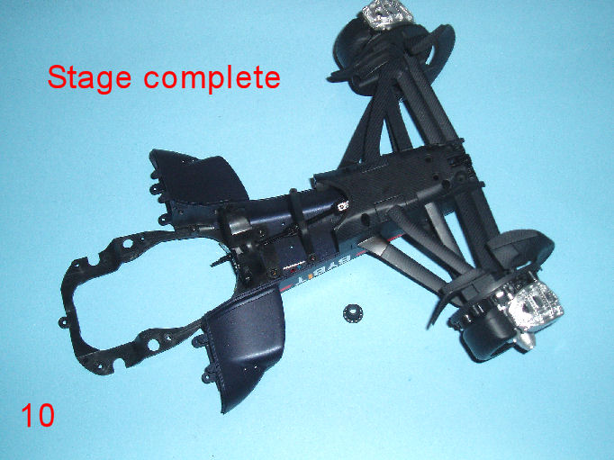

Pic 10: Store the assembly and unused part safely for now.

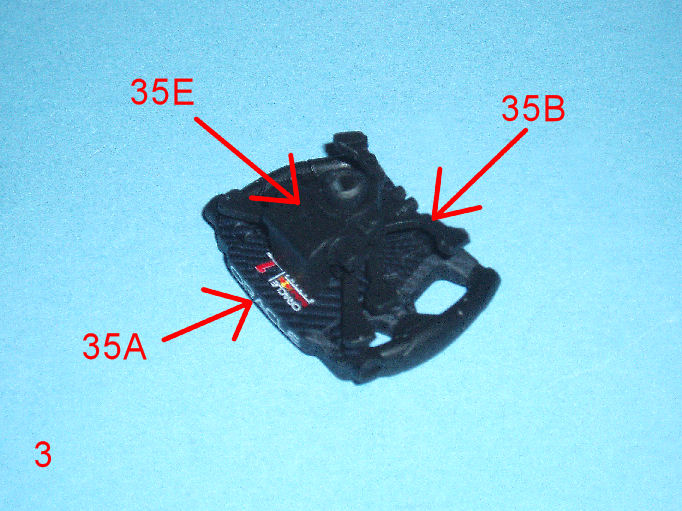

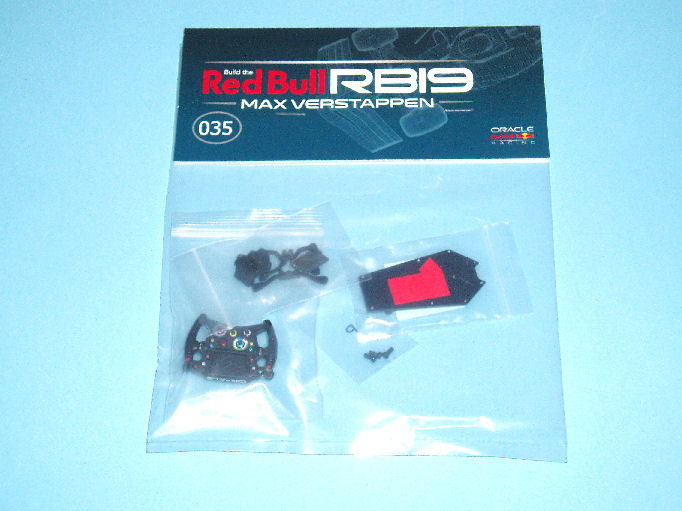

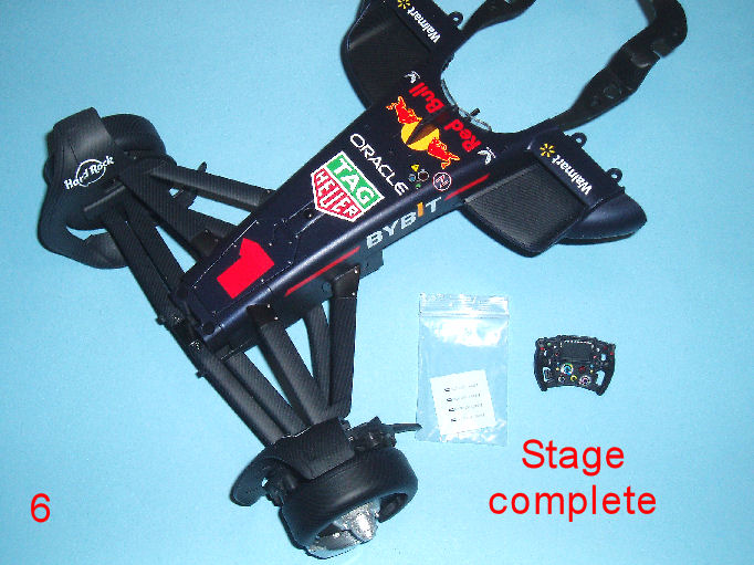

STAGE 35:
Steering wheel.

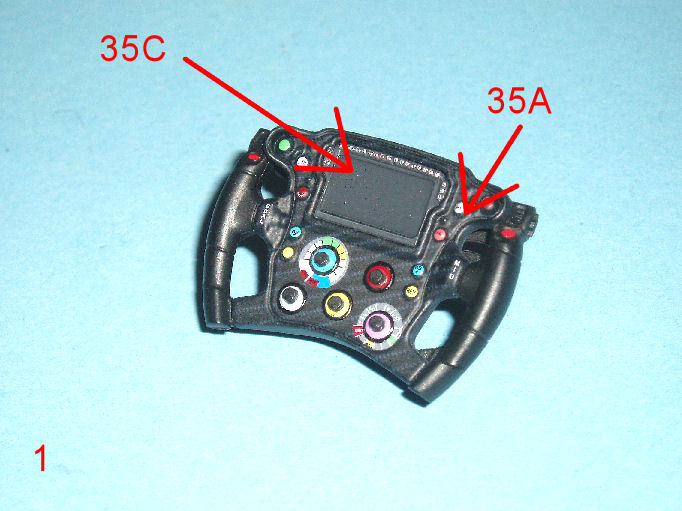

Pic 1: Press-fit the screen 35C into the steering wheel 35A.

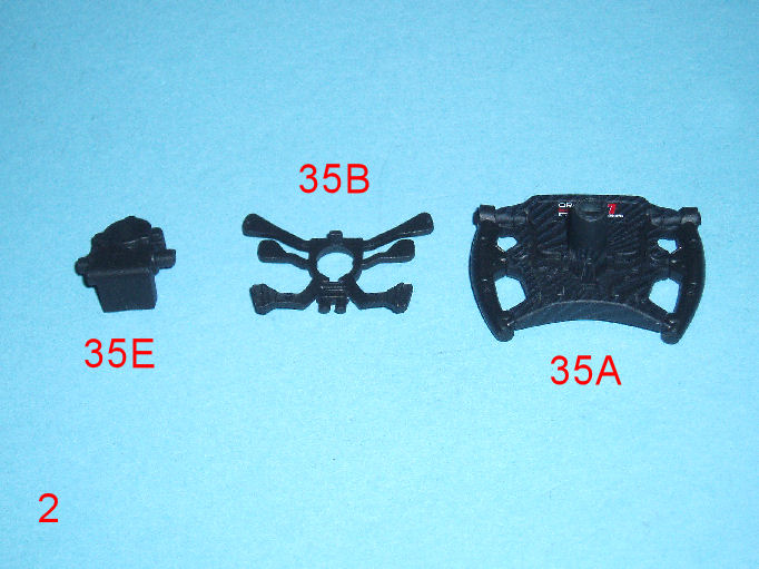

Pic 2: Locate the other steering wheel parts 35B and 35E.
Pic 3: Fit the parts as shown to the back of the steering wheel 35A.
35B fits first, then 35E.

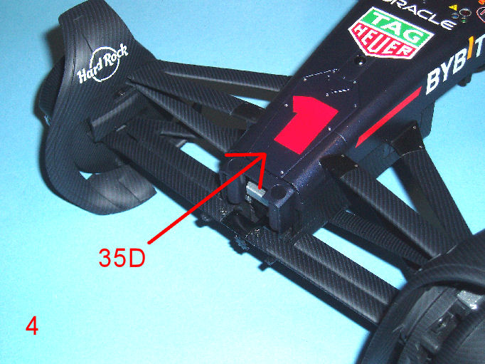

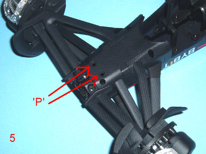

Pic 4: Fit the front panel 35D to the upper body as shown.
Pic 5: Fix from underneath with 2 x ‘P’ screws.
Be patient as this is quite fiddly.
Pic 6: Store the assembly and unused parts safely.

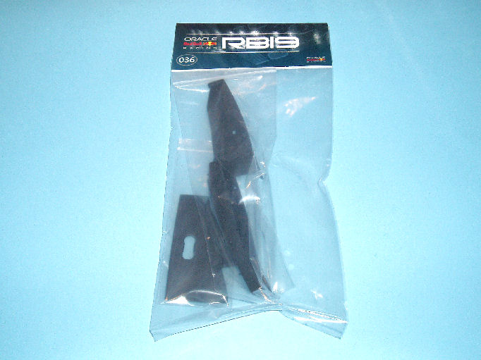

STAGE 36:
Left structural panel.

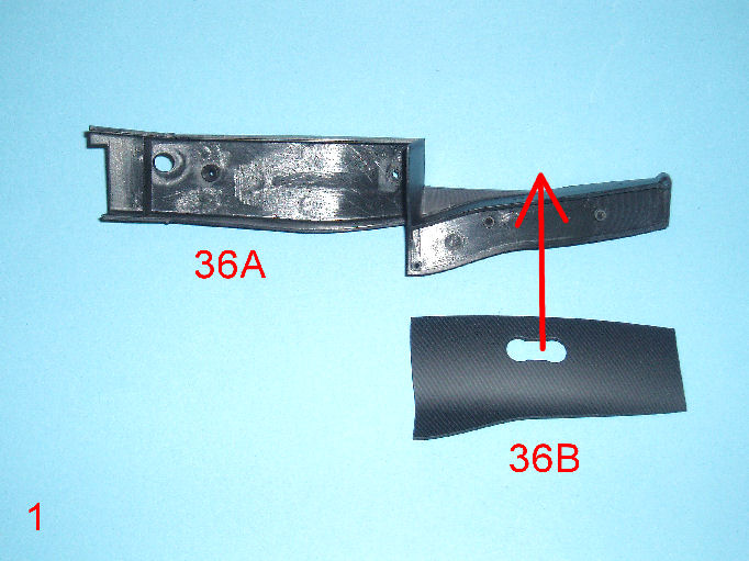

Pic 1: Locate the panel parts 36A and 36B.
36B will fit over 36A where shown.
Pic 2: Press-fit the parts together.
They will only fit one way.
